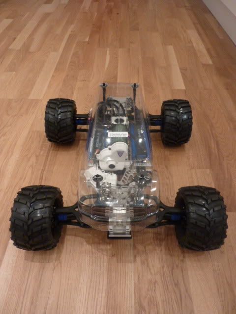

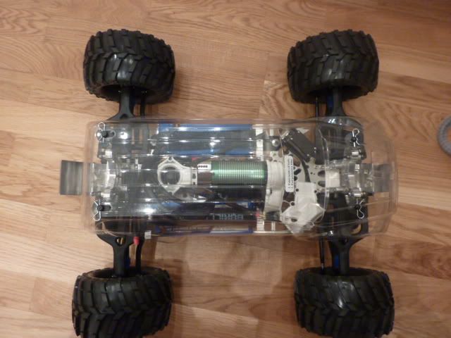

UPDATE
PORN?
SWEDISH FLM MAXX 5s MMM2200

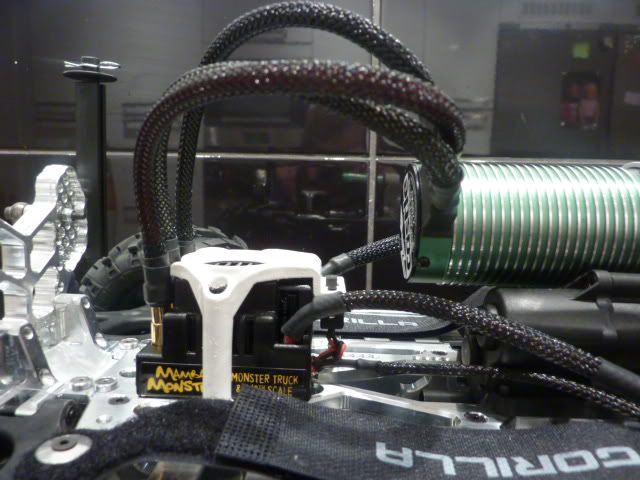

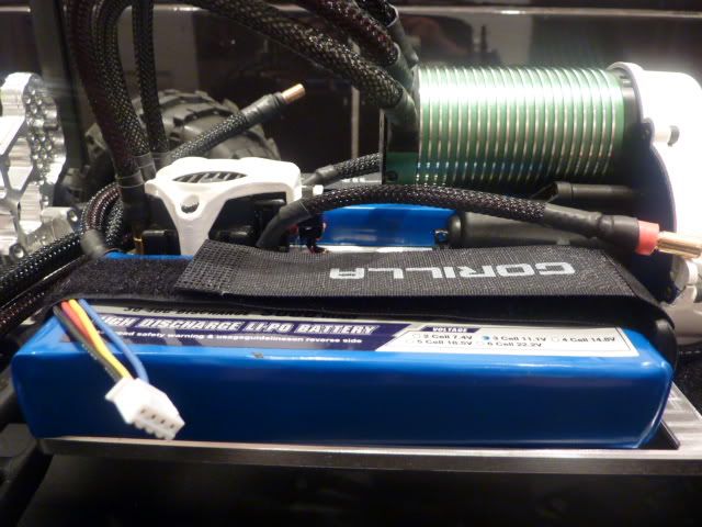

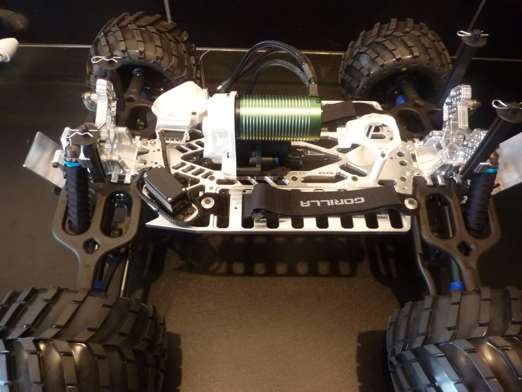

01.13.2010, 02:36 PM
.....more?

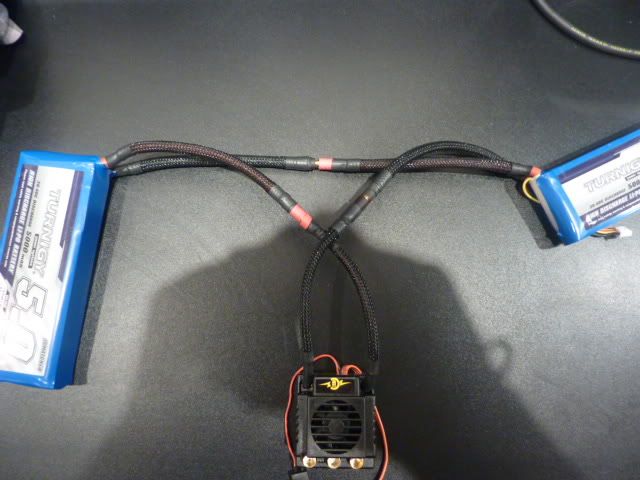

  (#231)
ANGRY-ALIEN
ANGRY-ALIEN's Avatar
Posts: 809
Location: JAMAICA
01.13.2010, 02:55 PM

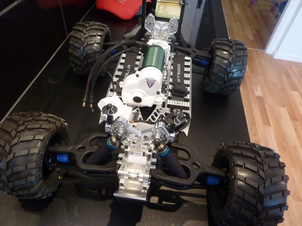

nice work man... i love what you have done with the wires... the layout is a little cleaner... been looking for that stuff here, but i can find it anywhere...
I think you will have to employ two smaller velcro straps to secure batteries on the sides during those extreme lateral 'maneuvers'.
looking good... now finish it and get it dirty

Looks great, really liking the white details & cable sheaving, really adds a touch of class.
Is there anything else left to do besides painting the shell?

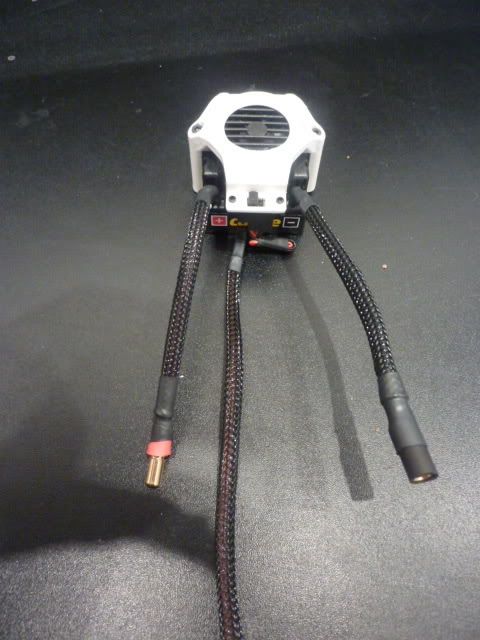

Yes its almost just the shell left. I will by a airbrusch and try to paint. I have to fix the ecs. What cutoff setting do i use when i have 5s? 3.3V/s and the esc just know by himseld that i use 5s?

Try this thread (Whats a good voltage cutoff for......)... 3.2-3.3 seems to be good.

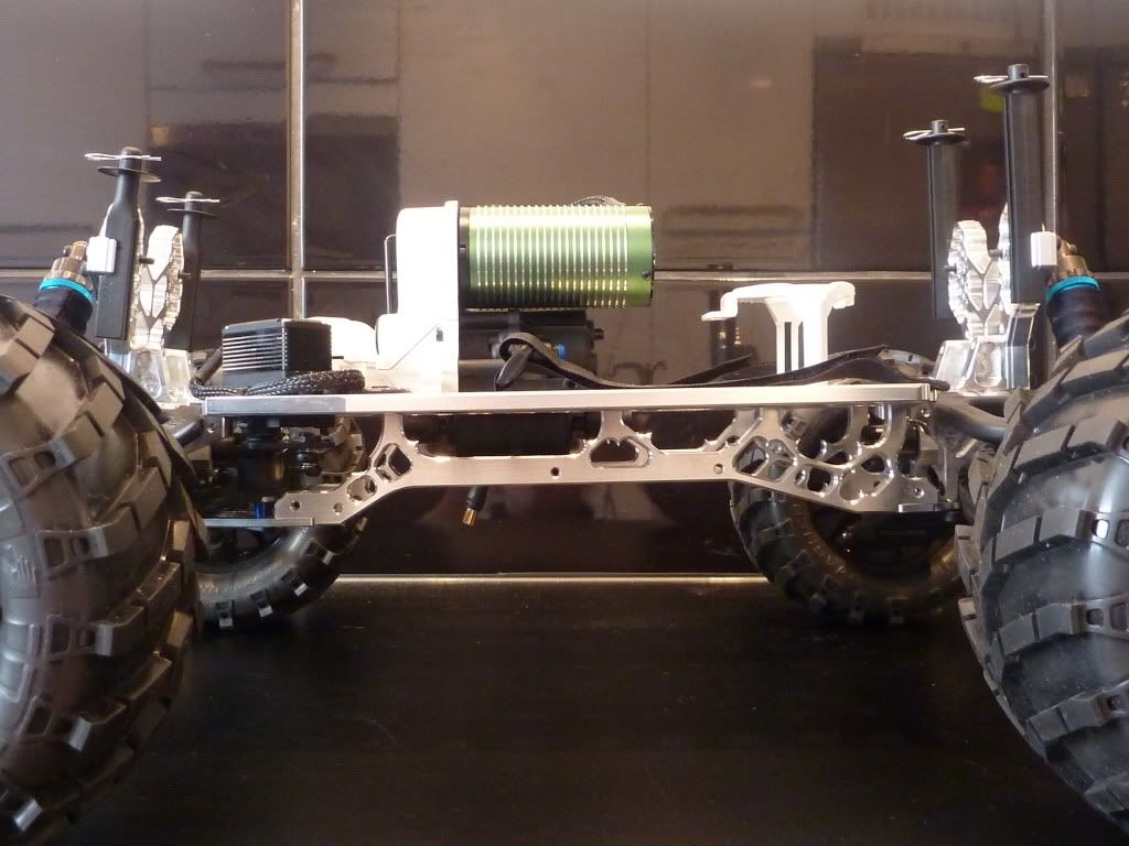

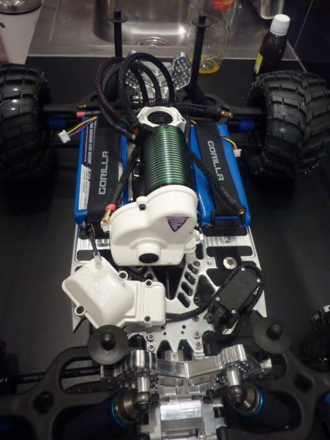

Looks great, but you are really going to want the batteries all the way up instead of all the way back to get some more weight on the front half of the chassis otherwise the front end won't be heavy enough, the truck will push alot when you turn on power. Which will be the way you will often(most) turn, on power.

01.18.2010, 02:35 PM
Maybe i need more weight in the front but i cant, the tranny is in the way...

01.18.2010, 11:15 PM
Can i buy mount for the CD to a FLM maxx from u?pictures? u can post it in my thread. Thanks
As for the first part, Ah I see and I should have seen that before!
For the second part, you posted this on my vistor message area. I rarely ever look there and don't get notification when someone does. I don't know how you think I might have a RCM Maxx CD unit but I wish and would probably not sell it LOL nope. One would fix your weight distrubution problem because for one thing you could point the motor forwards(which would add alot more forward weight and cooling as a bonus as its better in the wind) and allow you to mount the batteries more forwards because well you wouldn't have the tranny in the way. So I say to you be ready when they hit the shelves this week. I wouldn't be surprised if they don't come out for another year though.
