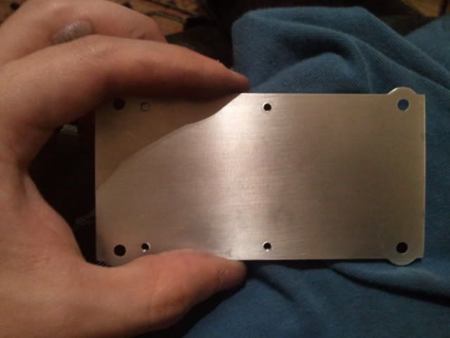

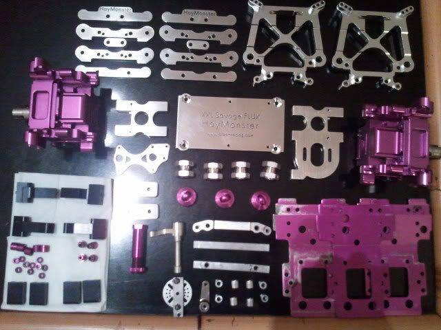

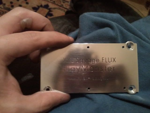

I did some polishing of the alloy to see how it would turn out... Check out the shinyness haha
No reflection
Slight Reflection ;)
I think i am going to be getting everything anodised red apart from the shock towers and the new arm braces which i will leave polished.

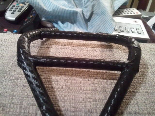

Thought i would try and fit some carbon vinyl to the plastic bits...
Thinking about doing my whole nylon roll cage as it is looking a bit scratched - it isnt perfect but it is better than the scratched black nylon

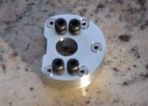

Firstly... Here is my new motor mount spacer so i can run mech brakes... Designed by the one and only Dejan once again! He has done an amazing job once again and turned them around in a couple of days even though he is extremely busy! THANKS DEJAN

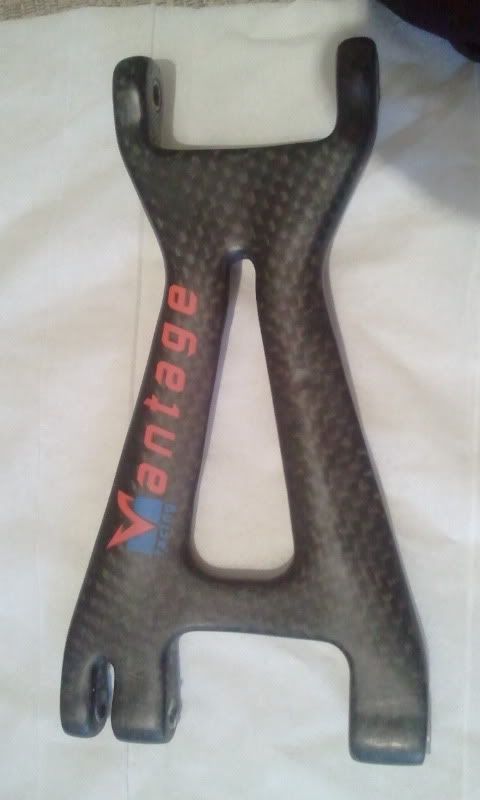

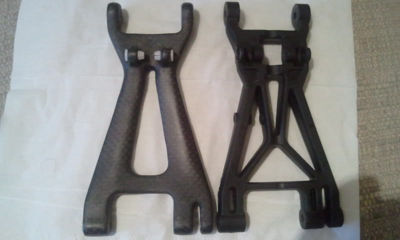

And as this is not going to be a hardcore basher as in it wont be doing the same huge jumps it once was (i have my second flux for that) i thought i would try and improve the handling and take off on this XXL... I thought i would stiffen up the rear arms with some carbon arms from Vantage racing... I do not want front carbon arms as i need the flex when cartwheeling (i always broke front arms, never have i broken a rear arm in a cartwheel... It is because the majority of the weight is up front)
Im going to have to work out a way of mounting my sway bars to them and my rear mud guards too....

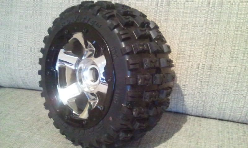

I will be running red plastic beadlocks from MMR... Should be awesome... yes they are heavy but they will offer stability at speed and NO BALLOONING
Desperados and BowTies ----- I didnt want Hostile tyres as the side grip is too much resulting in roll overs... The bow tie will allow me to drift corners nicely but give me great straight line grip and acceleration due to the huge tread... People say they also wear down quickly... but this happens on bajas which are 10lbs heavier and all there weigh on the rear tyres. Which is the opposite to my setup.

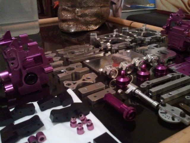

now thats a pile of parts. more machined aluminum than ferrari. wow. epic build

My rear 1/5 bow-ties have held up very well (I gorilla-taped both the foams and the tires). The front bow-ties have shown more wear - they seem to be softer and don't like the pavement. But I think you said you're going to run all 4 rears - so they should last a while.

Brian, you are right... im running 4 rear bow ties... i have the blue foams which seem to be very stiff... i cannot see these tyres ballooning at all...but maybe i could be wrong.

My rears were ballooning some for sure - I thought it was making the truck a little squirrely under acceleration - so I taped them.
