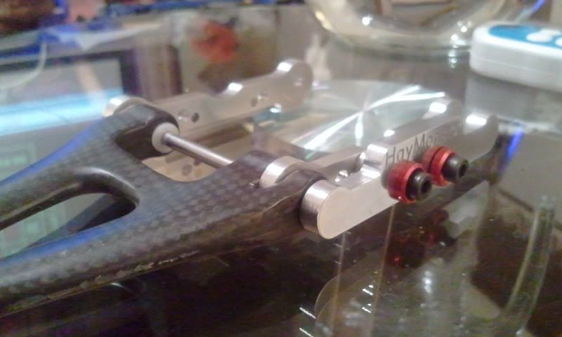

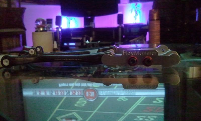

Some Carbon mounted to some alloy *:twisted:
im getting very impatient about the rest of my parts so thought i would take some teaser pics...

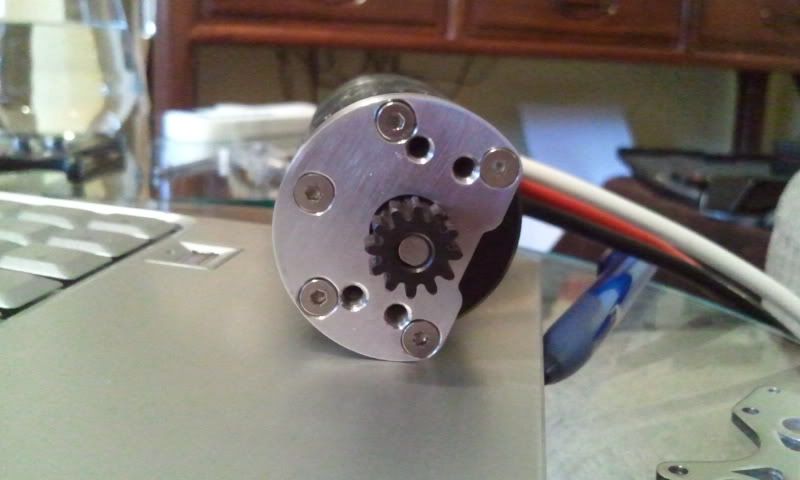

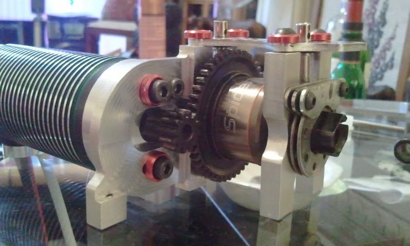

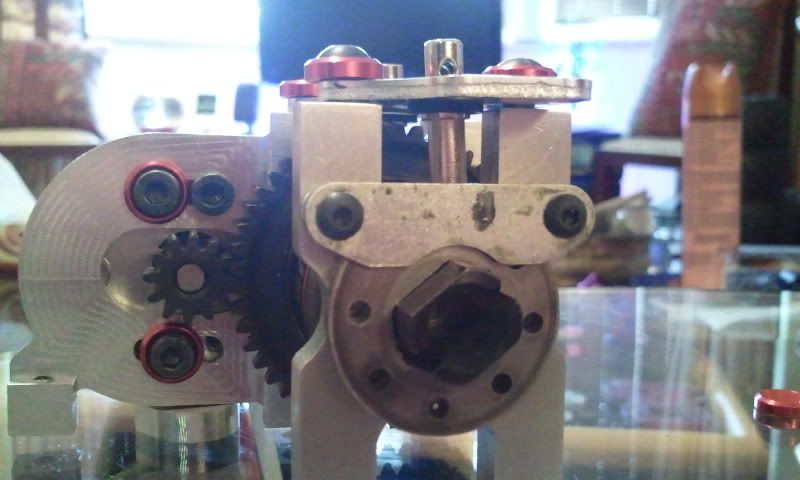

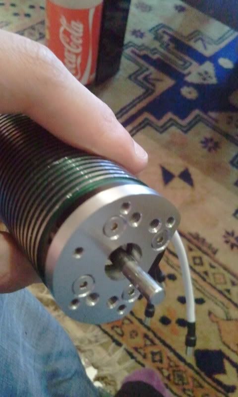

Some Closer Pics of Dejans Mount and How It Works
I was originally wanting to use 4 screws to mount the motor spacer to the diff mount. but by the way i have to angle the spacer to get the correct mesh, i can only use 3 screws, as seen in the pic below... I could grind a little more off the diff mount so i can mount a 4th screw... I may give it a go as it isnt much material that needs to come off...
Now i can use my Mech Brakes, and this spacer is very tough... It wont be anodised though, i will keep the alloy colour and have the diff mount anodised red. The top plate will remain silver too. Add a bit of contrast..

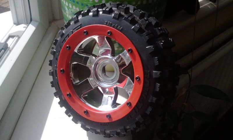

Vs
New

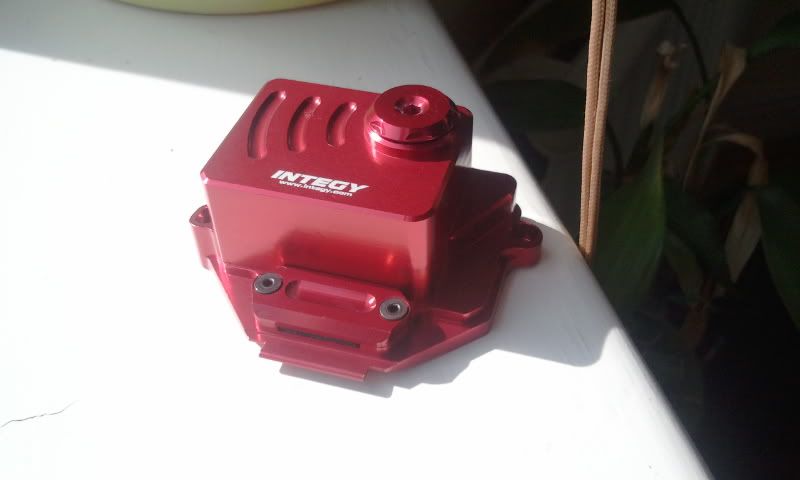

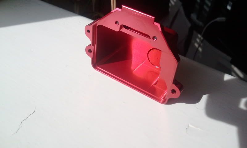

Also.. yesterday, my integy (yes it is the only integy part on my truck) receiver box arrived yesterday. I then asked a few people whether or not it came with a bottom case.... And people said no, and that it just sits on a mini slash chassis. So looks like i need something new made up for it to sit on...CUE DEJAN
as i need something for my BEC to sit on, i may get a plate for this rx box and BEC to sit on together :P

FYI, the 1/16th Revo rx box just sits on the chassis and the chassis has a lip on it. The lip helps hold the rubber gasket in place and provides a sealing surface for it. You could just use a flat plate and glue the gasket in the rx box, thats if you care about making the box waterproof though. Just figured I'd let you know if you didn't already.

Thanks bud, i did realise this once i received it... A little annoying, but im not really going to be getting this truck soaked, so i will just install it on a flat plate i guess...
I need to buy the gasket too but dont think i will need it or want it if it costs me $8.00 just to my door
