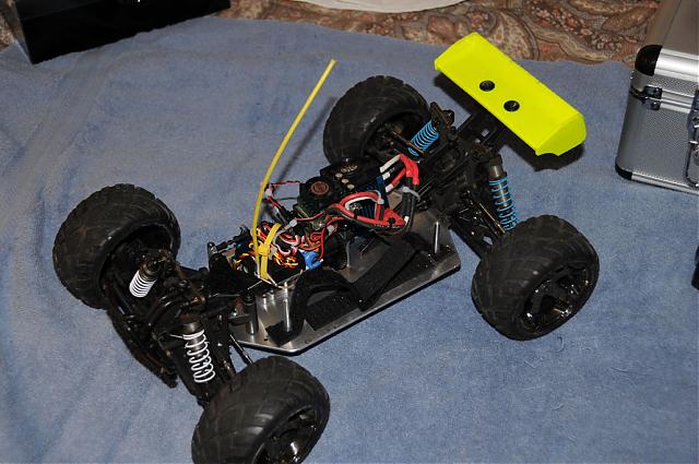

Here ya go. Snapped a few with Anaconda's on Traxxas 2.8 rims. I don't like them as much as the Proline 30's with the Jato offset, but it was raining today and I couldn't run on the grass so I had to put a good parking lot tire on.

Looks good, do you really need the fan on the motor?
