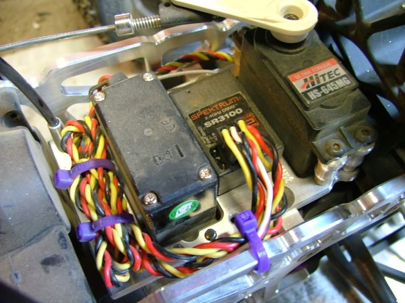

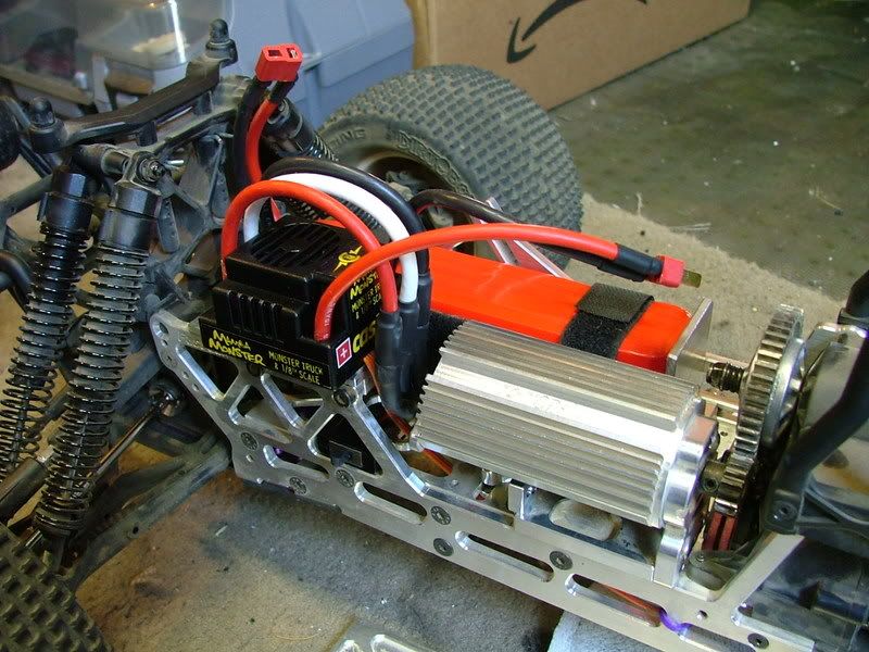

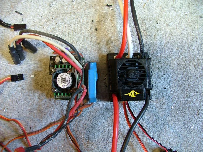

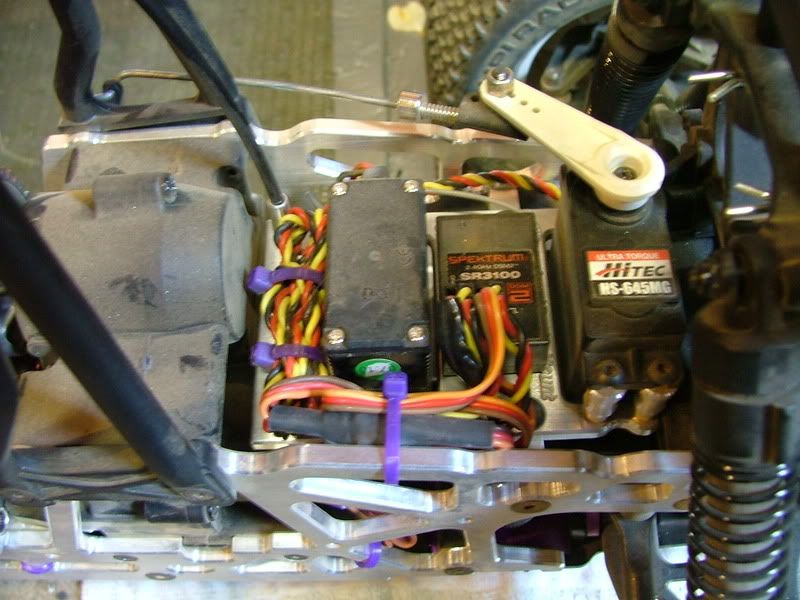

I soldered up the 6.5mm bullets and a Dean's plug for the battery and programmed it with no issues. The weight with connectors was 4.6oz which was only 0.6oz heavier than my MM with CCBEC with connectors. The footprint is only slightly larger too as you can see by the pics. Thanks to the internal BEC and fan I was also able to get rid of a y-harness and free up a port on my receiver. Overall everything looks much cleaner.
And I finally have 10awg wire to match my Neu battery. I should be able to run it today to see if there is any improvement. I'm running the exact same settings, motor and battery. What I'm hoping for is that the Monster gets rid of the cogging issues I was having.
On to the pics.
Receiver before and after pics:

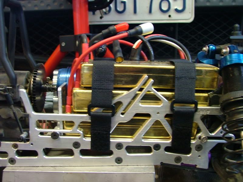

I've made a few updates to my Savage.
XL super Heavy duty axles
Tekno Neu 1515/1Y
6s Trakpower (3packs in series)
Aftershock shocks w/aluminum caps
XL 52t spur gear
I haven't run it yet, but should get a chance this weekend.
Pics:
Something's gonna break for sure!

Mmmmm. Lotsa batteries. Mmmmmm
Something's gonna break for sure! Yeah but it will be fun,fun,fun!
Good luck with her- looks great.

Hmm, not very safe all those batteries....
Why not just an 6s lipo pack...??
This can move especially when crahing and jumping....

I agree with Joram.
I would not trust those velcro straps to hold all of those batteries.

Looks like he has velcro stips or something in between each pack to reduce the chance of them sliding around. I've seen the same thing done with just 2 packs for racing, and it works well enough.

Maybe it can, but why not using a 6s lipo, they're made to use just 1 pack and not a lot of singe/double sells
But that are not all the things... You need to connect 3 batteries to 1.. connector....
I buy for my savvy a 6s Zippy pack. Not 3, 2s packs,

Well, if you'd like to give me $300 for a 6s pack my Paypal address is.......
I didn't buy 3 2s packs just to do this. As it stands I have 4 Trackpower 2s 4900 packs, 2 Neu 4s 4900 packs, 1 Maxamps 3s 5000 pack, and 1 Orion 2s 3200 pack, not counting all the small lipos I have for my minis and crawler. I just wired up the Trackpowers to try out 6s power on the 1515/1y. I actually went back to 4s since the 6s was just overkill with that motor. On 4s it's still got gobs of power and will top out around 45mph which is plenty for a MT.
BTW, there IS velcro between each pack and I used stoppers to keep the packs from shifting. Even in really bad crashes (like nosing it off a 15ft jump) the packs didn't budge and the hard cases held up better than my Neus without cases.
