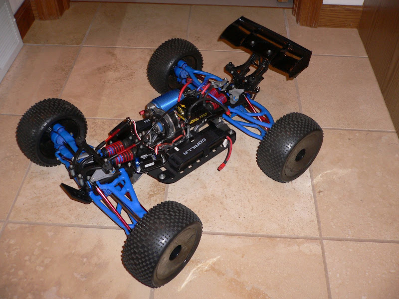

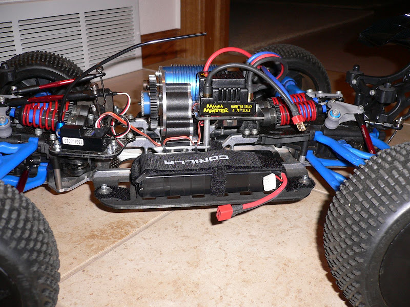

My baby is finally alive!!!!!!!! I made a plate for my MMM. Here are some pics. Sorry for the crappy picture quality. I will upload some better ones soon.
From Gorillamaxx G3R

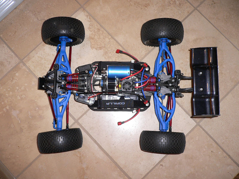

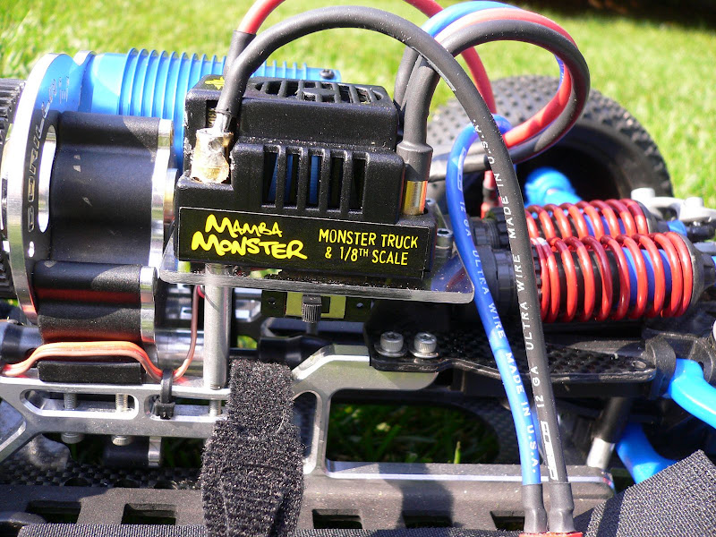

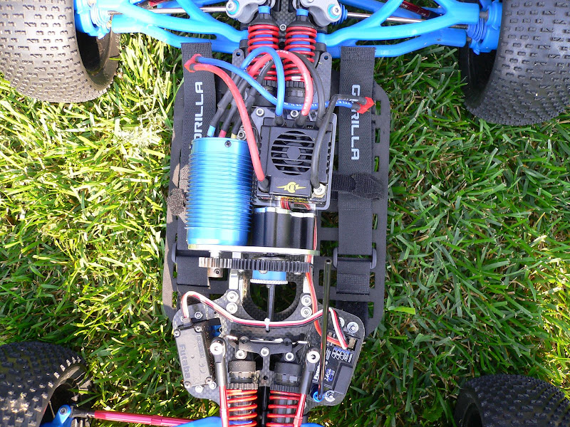

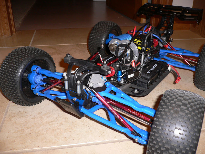

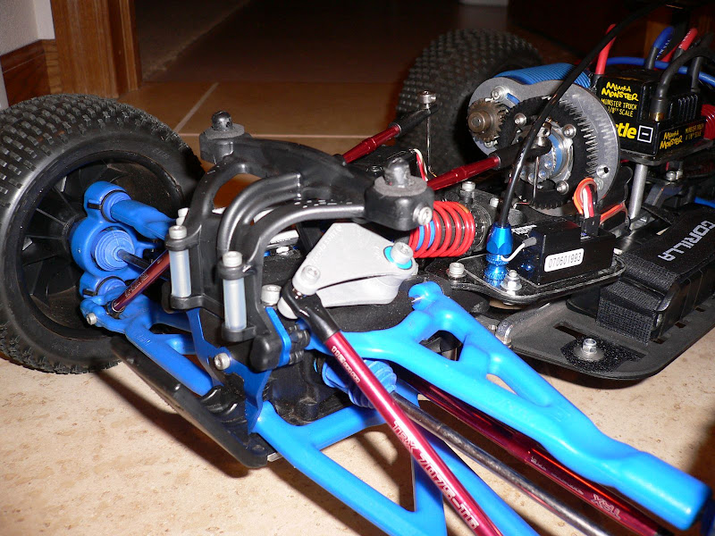

Hi everyone! I took a few shots of my baby last night when I was installing the latest Castle Link software. For the time being I am using some old Maxamps 2s 6000mah lipos. Next spring I plan on purchasing some Trackpower 3s 4900mah 25c lipos. Right now I get about a hour of run time with the 4s setup. I am starting to not like the RPM stuff. It is way, way too flexible. The rear arms flex so much that I have popped the drive shaft out of the cup several times. One time was from a dead stand still. I mashed the throttle to do a wheelie and the shaft popped out. I was also jumping the truck on a small jump (the smallest that I have) the truck landed on the left front wheel and pulled the pillow ball thru the hub carrier. I was looking at the Flextek arms and the new Revo hubs, if I get them it would be after I get the batteries. I can’t wait to switch it over to 6s! Then we will see some carnage! Anyways... here she is. Thanks for looking!
I used a lighter to heat up the antenna tube to bend it. The Receiver is sitting on a leftover piece of Lexan from the body. The MMM is sitting on a plate that I designed in AutoCAD (I have attached a 1:1 drawing of the plate; It may need some tweaks to fit). I used the Gorillamaxx ESC mounting post with a few washers to help support it. I used 3mm cone washers where the top deck connects to the “X” braces. I hate the counter sunk crap, especially when it isn’t needed.
I didn’t like how high the body sits on the chassis. So I shaved the crap out of body posts. That wasn’t low enough so I re-drilled the mounts and shaved some more. Bumpers? We don’t need no stinking bumpers!
I ended up switching over to P3 rockers. My girlfriend bough them for me as a surprise. She is the best!!!

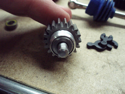

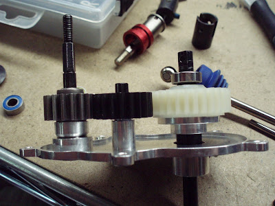

A lot of things have happened since my last post. As it turns out brushless + 6s lipo = very, very, very powerful... My fiance and family members pooled together and bought a pair of thunder power 3s 4900mah 40c lipo for my birthday. Because of the new batts I spent most of the summer replacing the drivetrain. I also had a lipo go bad on me (thunder power replaced the batt under warranty) so I really didnt have a reliable truck until the end of summer.

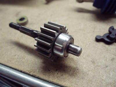

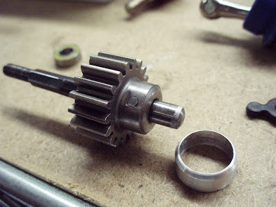

I had problems with the roll pin in the top shaft of the transmission always breaking. I replaced it with a solid steel pin. So far so good.
I also made a pin "cover" to protect the gears just incase the pin snaps again.
I also upgraded to a ue steel idler.
I will post some more pics of the chassis and upgrades later this week.
