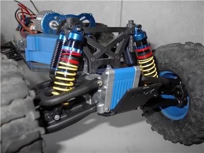

search threw the thread. It has some on there. It shows it in the early stages. I have some of the skids to. I run the back gmaxx extension. The front was made. It takes the 100.5 ue dogbone just like the back. If you buy the back top extension plate will give you the exact length you need for front top. use it as a template. I beat a rear skid flat then trimmed it down for the front.

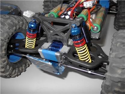

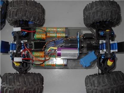

Here are a couple pics of where I am at. I still have to install my rpm towers, new skids, run all the wiring and figure out what tooth pinion to order. My Warrior came with the heat shrink removed. Is electical tape ok to wrap it back with and is there anything I'm missing that you guys see?
  Send a message via Yahoo to MaxxBashers
MetalMan
MetalMan's Avatar
Posts: 5,297
10.01.2005, 03:34 PM
Electrical tape should be fine to use, but make sure that the heatsink can breathe. I noticed that you have Tamiya connectors on your batteries! Those MUST go!

also, not sure if you know it but your black bec jumper is missing or not on there.
