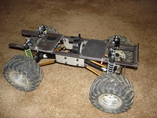

My crawler "project".
[IMG][/IMG]
rkman
rkman's Avatar
Posts: 32
Join Date: Oct 2005
Location: Norcal
11.07.2005, 10:20 PM
From what I can tell people are using 3 channel with the rear servo turning the rear wheels in opposite direction of the front in standard mode and this site has a mod for a 3 position toggle to lock out rear steering or switch the rears to turn in same direction as the fronts for "crabwalk". I can't tell you from experience because I haven't gotten to the point of actually having a running truck.

rkman, hate to tell you this, but those front and rear bumpers are going to kill any kind of performance, they'll hit the rocks before your tires. If you're just building more of a pretty truck, it's okay, but I went as far as doing behind the axle steering on the front to get the best possible approach at any time. My servo mounts are rock solid too, they're tied into the axle braces and aren't going anywhere without having the axle ripped in two.
I personally run my MX-3 on my Clod, and use the 3rd channel to ghetto steer the rear. It's only a toggle switch, so the rear is either all left or all right, with no in between straight. Nice thing about having it independant from the front (even if it isn't the best way to do it), is that you can just swing the rear when taking on something, or crab walk (all 4 wheels pointed in one direction) to hit it from a different angle.
For a "controller" though, I run the tried and true Super Rooster with dual Integy 55x1 comm lathe motors wired in parallel.

11.08.2005, 01:13 PM
I would like to have both:D Pretty and functional that is.
But I haven't had the chance to try it out yet.
I'll take your word for it since you have actual crawling experience.
There are some cool vids of the chasis on the inerbeecrew site that shows the chassis working pretty well on some crawling but who knows how many times they tried. I think if I get some large diameter tires it should help the bumpers clearance some.

Dafni
Dafni's Avatar
Posts: 2,487
11.08.2005, 01:26 PM
In the worst case you could still modify the front bumper area, rkman. The chassis itself looks very nice! One of the more attractive designs I've ever seen. Don't know about its performance, but it looks awesome.
If I would build a crawler for actual rock crawling, I would also go for a clod design.
I have seen this torque-twisting on vids, and it's not a nice thing to see.
