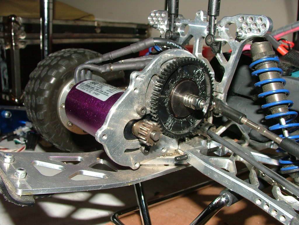

Got the MGM replaced with the 10S ESC from Lutach. This ESC puts out more power to the wheels them the MGM did. I blew the old slipper setup, that the MGM could not melt. After some suggestions, I upgraded to the jato slipper clutch and it can't hold the power either. Current gearing is 17/56 with a tight slipper.

Snapped a dogbone again this morning after swapping the spring on the slipper clutch. Putting in a beefier setup today.

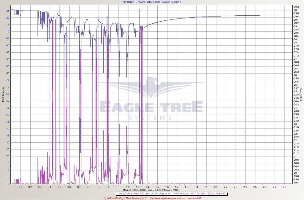

Just finished a run cut short by a busted up shock and snapped axle. Power is immense. Datalogger showed 126A peak and 2434 Watts.

These were the calculated numbers

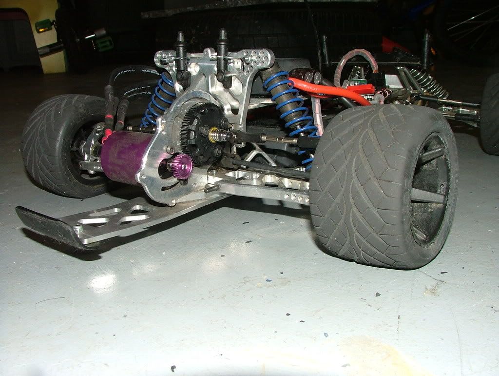

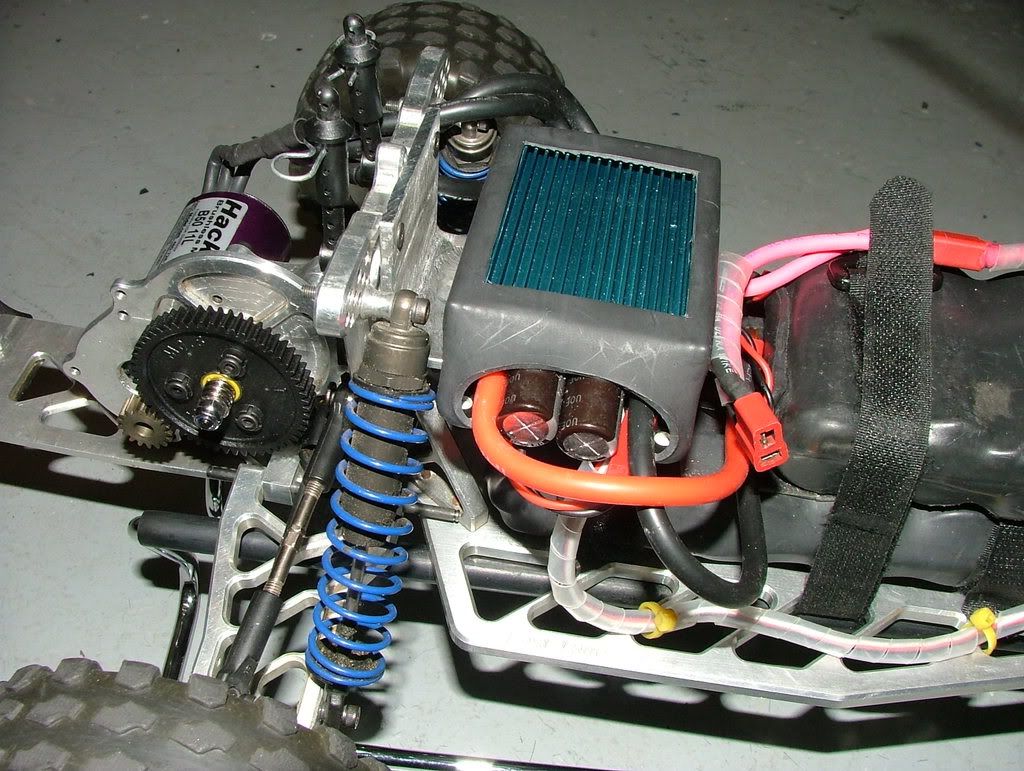

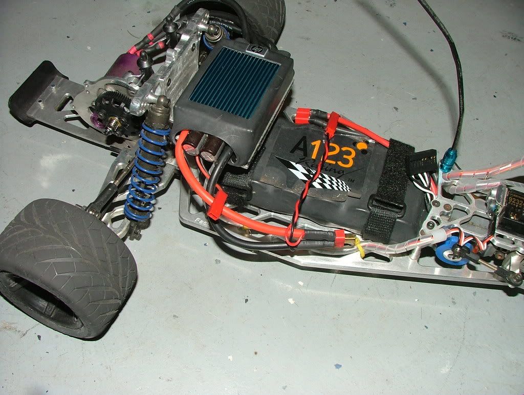

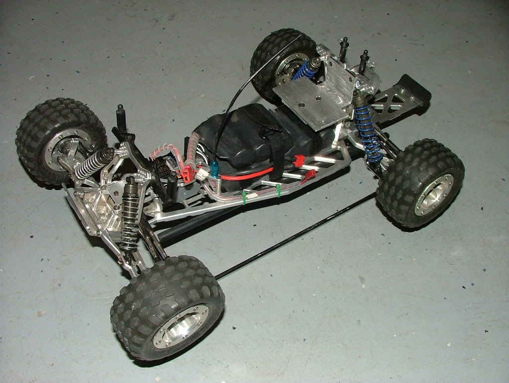

10.11.2008, 11:27 PM

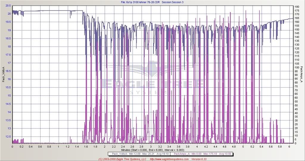

Lutach's ESC is kicking butt. It's dragrace worthy. It was able to pull my A123 cells down to 2V per cell(about 76C discharge).
These are the calculated peak numbers.
Here are the pics of the current setup.
