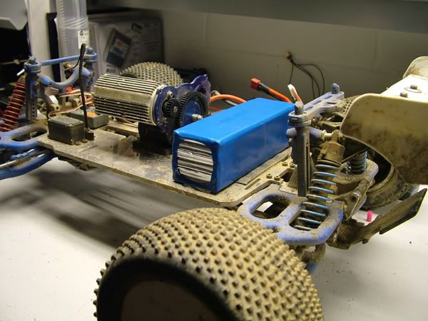

have you thought about getting the 3905 tranny and putting it in there with the revo cast mount the put the motor down low and toward the front up by the servo.... just something i was thinking while looking at your pics..... good to see people rocking the emaxx in a world of revos.
nice video also, what kinda runtime you getting out of 6s 1p A123 cells on the 10xl
Haven't thought about that tranny. Might have to look into it. It's a single speed right? Do you know if it will work with the RRP HD slipper setup I have on my maxx tranny?
I use about 1500mah in a 5 minute qualifier. Luckily we only have 10 minute mains so I can get through them with a 6S2P

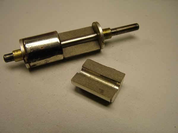

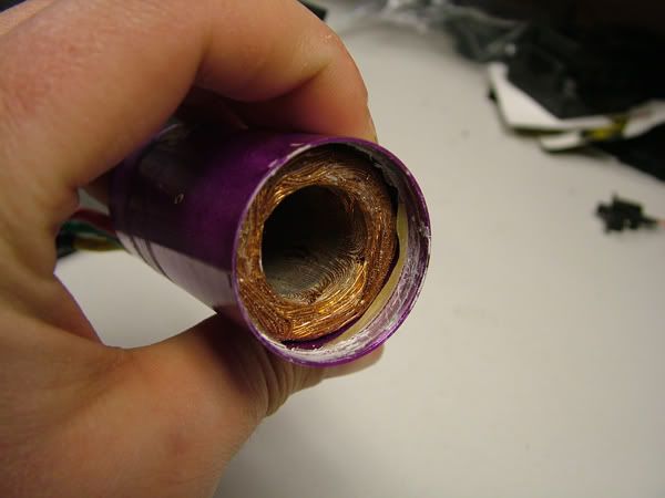

First initial test run was good. Motor warmed up but nothing bad. Second run didn't go so well. Had a light dusting of snow so after about 8-9 minutes of wheel spin and drifting I got a lot of glitching and no go. Tore the motor down to find this.
Looks like the magnet let loose and was flopping around in inside
I think I'm going to give one of those 70mm or 80mm medusas a try and definitely gear down a bit. It was EXTREMELY fast geared 22/66 and obviously over worked the motor
