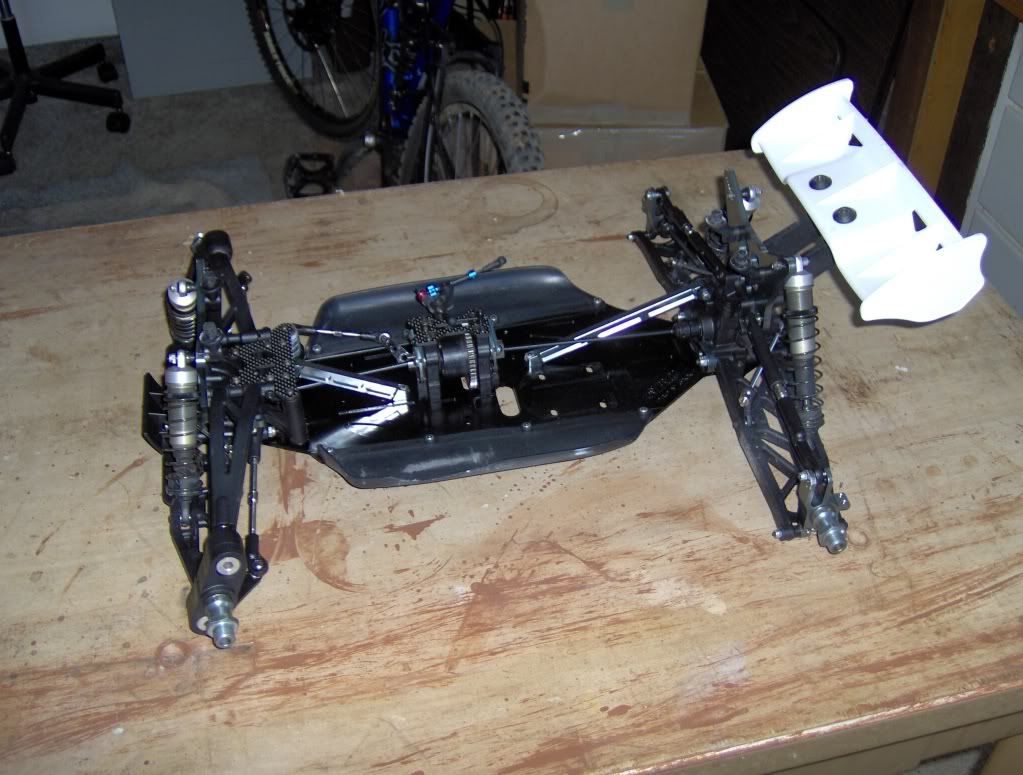

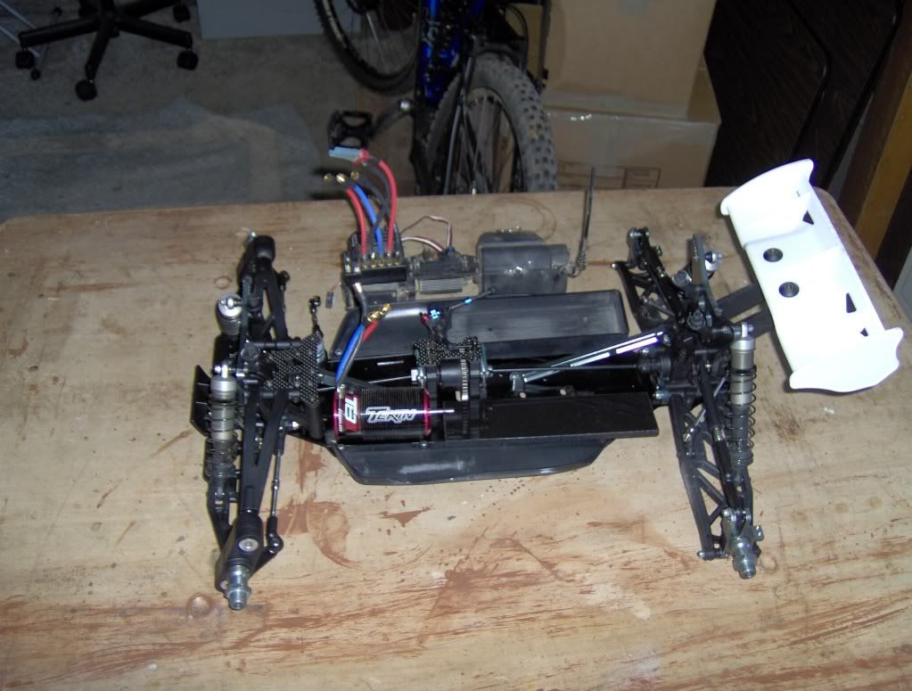

Thanks magman! Did you get your Moogen mount yet? I'm still not sure which I like more, but I'm gonna try the Tekno one. It gets the motor closer to the driveline and center of the chassis but I have to modify the chassis. Mikes mount might be a little lower, which is always better. I'm not sure if his would make my motor hit the front steering plate though. Another trade off!
Those are MBX6 Big Bores. Not stock at all

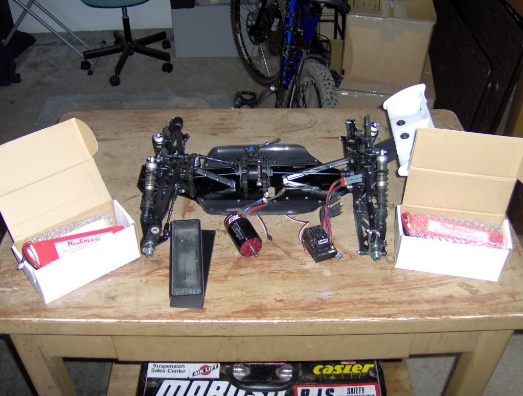

Just found more goodies on my doorstep. The Neu Energy 2s and 4s packs are here. I'll be cracking them open and performing surgery. This will be my first ever lipo reconfig! Making two 3s packs so I have 2 lipo setups for the truggy. Plus I can run the 2s and 3s packs as singles in the short course truck I plan to buy (Slash or SC10). I also got Mike's 2nd battery tray in, thanks for the fast shipping Mike! I knew UPS could be slow, but they're taking waaaayy too long to get my chargers here. USPS is all I'll do from now on, can't stand the men in the brown truck!!!

350+ views and only a few comments? Come on, post up!

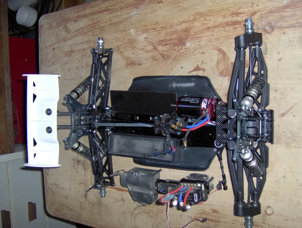

Got the 2nd RCM tray cut to length and clearanced
First one mounted
2nd one ready to go in
All mounted up
Made a nice little Y harness to connect them in series
All mounted up. Cleaned, ready to rock. ESC and Rx are only temporarily mounted. This thing ran GREAT! Got the batts all charged up and ran it on 4s. Very nice with plenty of torque and very controllable. Would be fantastic for racing on small to medium tracks. Bigger tracks will need 5s though!

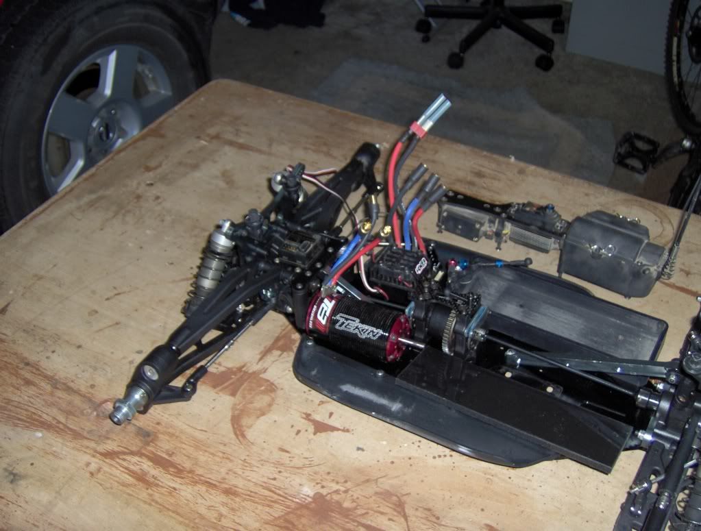

Got a lot done between last night and today. Just about finished
More goodies:
New brace location drilled and ready to go
Radio tray cut
Approximate placement of everything

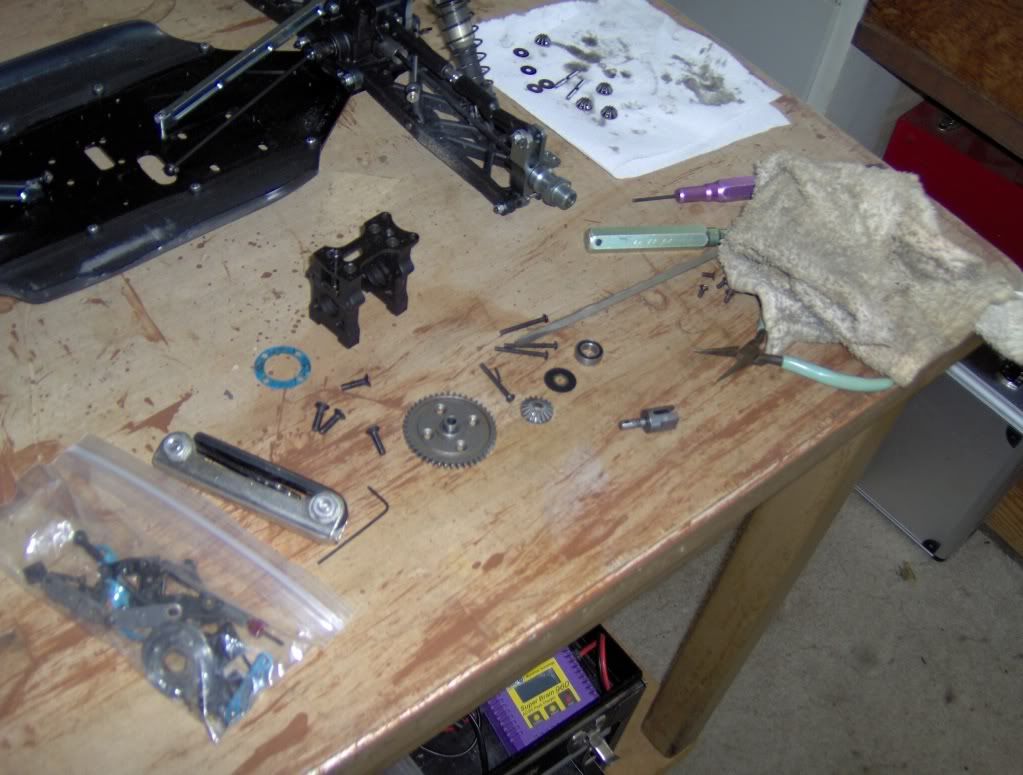

Motor mount jig I made to make it easier to make the holes. The first two still got jacked up somehow but I think I figured out what happened. I also should go to sleep instead of staying up so late working on projects haha!
Main mounts DONE
Jig over the holes, lined up. Ready to clearance the chassis for the adjustment slots
All finished

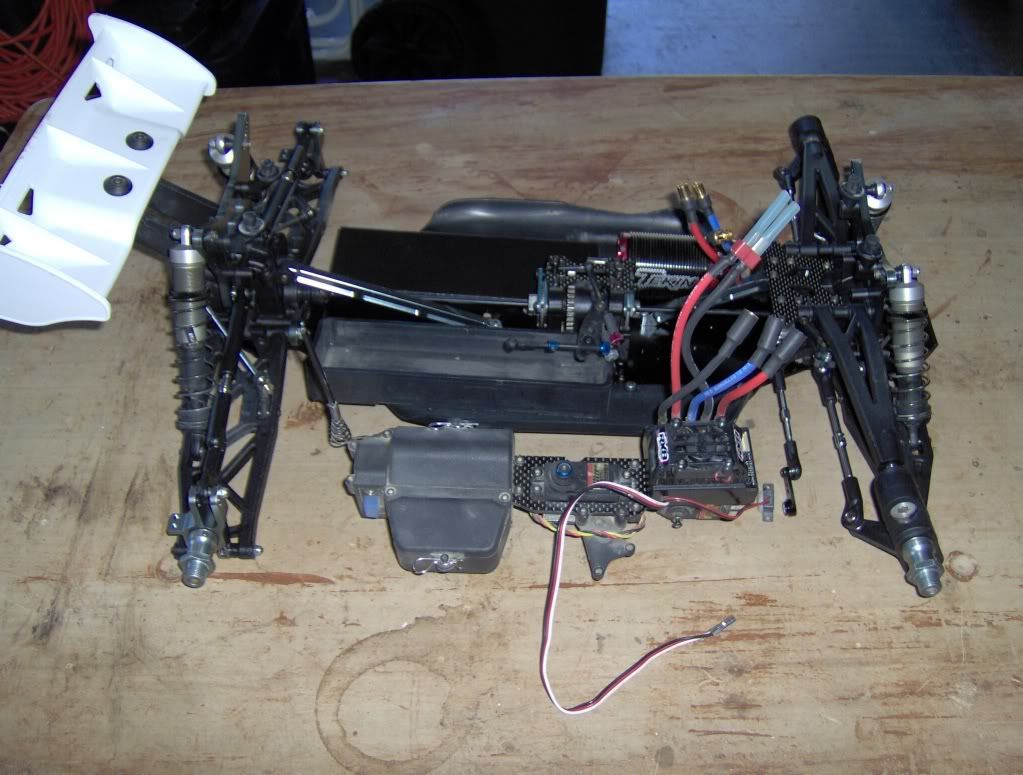

Mounted up (metal shavings EVERYWHERE!)

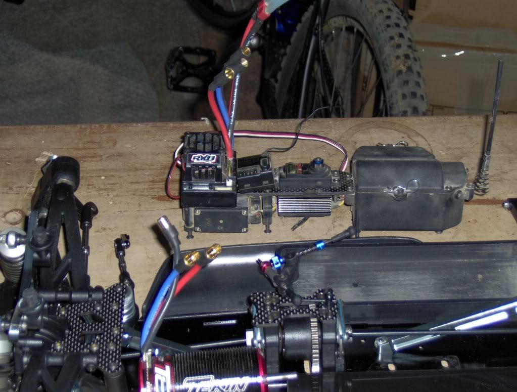

Next problem: New front brace is slightly in the way and is in the way of the steering servo. Soooo....trim it up! Then space the servo a little bit.
Placement of the trays. Had to trim them a little bit but they came out great. Very close to the chassis. I still need to mount them, but that's just about it. After mounting them I'll tear apart everything for a good final clean and lube then give it a test on 4s. I still have to reconfig my Neu lipos for two 3s packs!

Just got the battery trays mounted. Only 2 screws each right now, but I'll probably go to 4 each once I pickup more hardware. I'll post those pics tomorrow. I also need to pickup a countersinking bit, some velcro, balloons, and some foam. I ordered my zinc flux and zinc solder with some 10ga wire to do my lipo reconfig. Should be here the middle of the week. Until then, I'll just run it as a 4s or 6s setup. Mmmmm....never tried 6s before, hehe.
