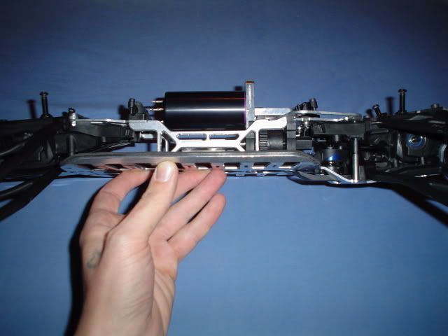

just an assumption but i think its set so far forward so he can have the motor over the center were the tranny would usually go. and for better weight distribution also i would guess. oh, and VERY VERY nice by the way. i was thinking of the exact same thing.

Love the center diff... It must be so much lighter than the E-Maxx tranny (even with single speed conversion). Hope to see some more of your "tricks."

Yeah, the long 1950 fits just in between the shocks and mount. Close fit, but very very low. Lowest I have ever seen on a Gorilla. And it's centered. I love it.
As for thinking the exact same, many people do. A center diff is a nice thing to have in a racer.
Yeah, it is lighter. It also has a noticeable smoother rolling resistance. I gave those diffs some extra love, and man, this is a smooth driveline. (diffs are alu cases and cups, with modified ringgears, btw) But still, I look forward to the bulkless with 8th scale buggy diffs.
The lower final gear ratio will also give less rolling resistance with the motor connected. Of course this will also mean less torque, but with this kind of motor (and overall weight) this is nothing to worry about.

Thank all of you for the nice comments! I feel blessed to be among you guys, and I really hope I can make it to the Get-Together. Just for fun, here's an older pic with a motor mounted. You might see how easy it will be to make a brace to support the rear of the motor.

Hey Dafni. are you going to put a brace on the holes where the transmission origionaly mounted? I noticed on my G2R that even with the lower plate on, without the transmission there is a lot of flex in the middle of the chassis where the transmissiom mounted to the X-braces. Just a thought and a heads up.

Indeed! A (adjustable) brace to support the rear of the motor.
And some holes will be used to mount the ESC-mount.
Also, the upright motor-mount will be cross-braced to the chassis. In one of the pics in the first post you can see the hole in the motor-mount.
The x-braces alone have some flex, but with the lower plate it is pretty rigid, IMHO. But you are right, extra support wont hurt.
Still a concern might be the area where I had to modify the x-braces to make room for the spur.... maybe I'll brace this too.
Thanks for the WOW, thought you will like it.
Just something i noticed with mine that i thought i would pass along.
I have always had a thing for low profile cars( comes from my slotcar days) I also have an HPI pro3 touring car for that reason. I love a design where you can put most of the weight at or near the centerline of the wheels
and yes the motor looks right sitting there
