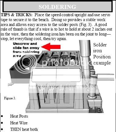

it´s not what the manual says. There the wires are soldered horizontally.

from tekin rx8 manual:

If you listen to the video I wired in that vertical direction for "shot" purposes. I wire mine just as you've shown in the picture/manual.
