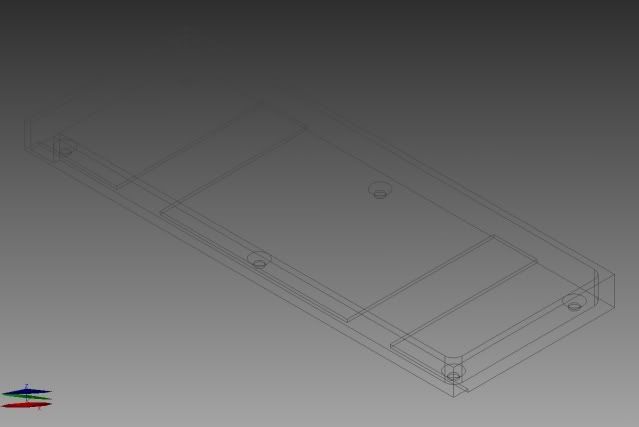

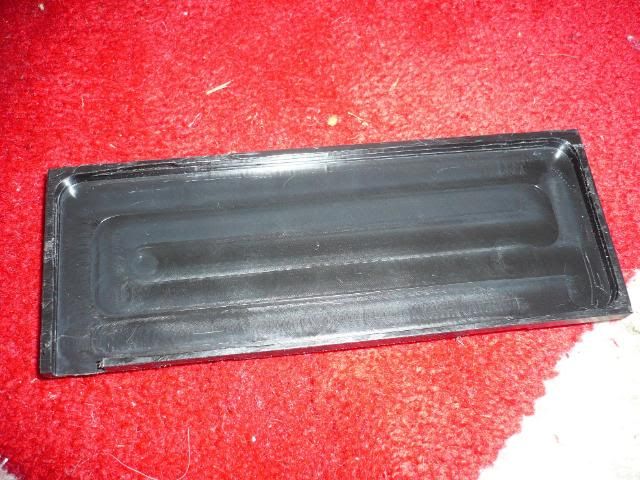

Rather small update, but I have designed the battery tray. It will be machined out of delrin sometime when I get around to it. Also sorry about the wireframe view, but my 6yo graphics card doesn't like shaded views so it will have to do till I get a new one.
Kieren

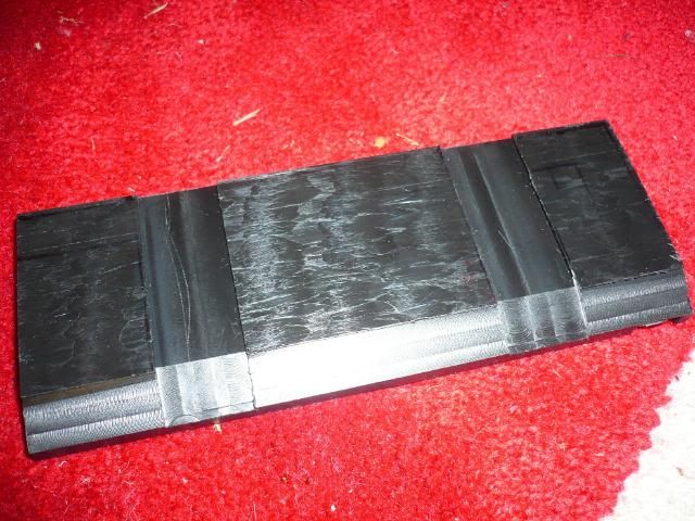

Aussie Nerd
03.13.2011, 06:55 AM

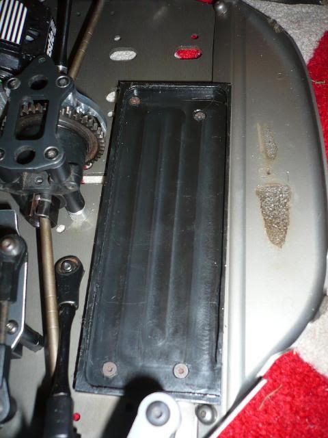

Did a little machining this afternoon. Just need to drill the holes to mount it. It turned out a little different to the CAD, but it will work fine.

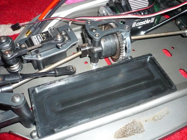

Aussie Nerd
03.14.2011, 02:54 AM

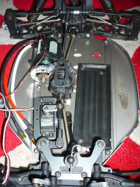

Installed
Now all I need is a ESC, batteries, tires/wheels and a new body...

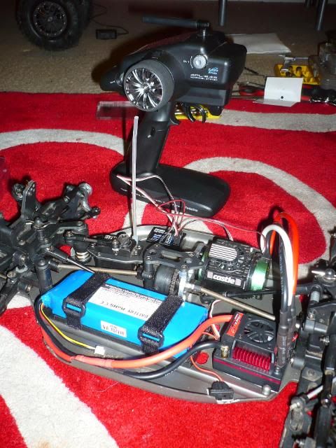

Wiring is getting a little closer to done
I haven't got any straps long enough for anything bigger than 3s, so I'll have to flog some straps off Bundy Racer. Now I just need to grease things up and hope the wheels come tomorrow.

I couldn't wait so out came the stock tires, or should I say 3 stock tires and one stock rim I was just running on 3s around the house, mainly to get the gear mesh right and fiddle around with radio settings. I ended up going with -20 expo just to smooth it out. With linear it was just a bit jolty starting off, but now it seems to be a good balance between take off and smoothness.

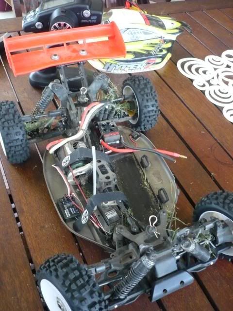

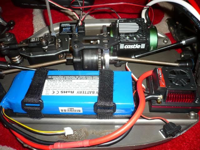

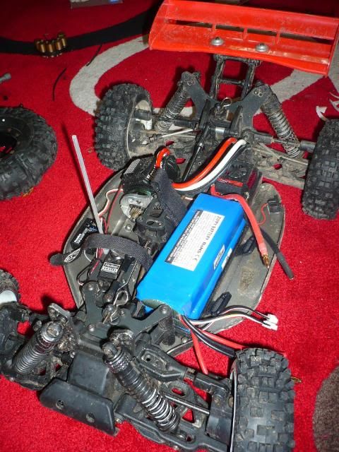

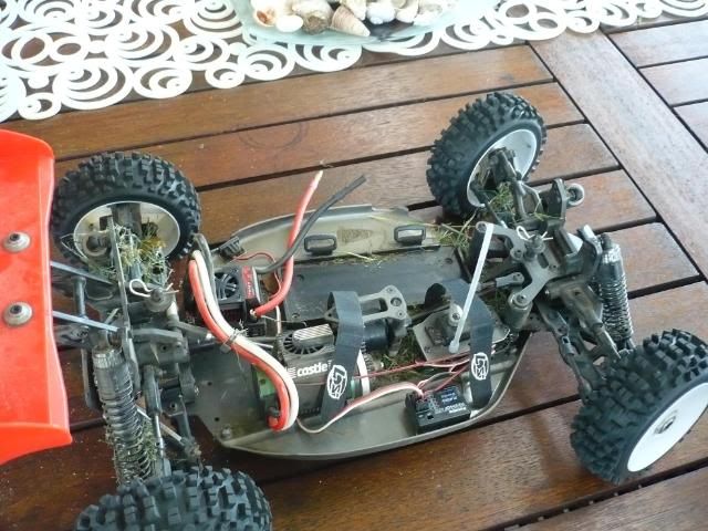

Aussie Nerd
04.01.2011, 09:28 PM

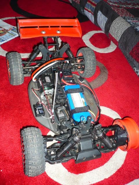

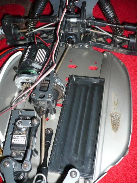

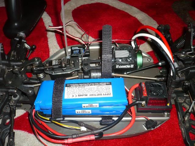

Finally got some pictures. First two are from the maiden run, last is a more recent one with the 15t pinion.
