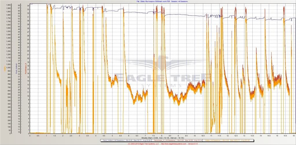

This is my datalog from my commute after work.
6 KiloWatt A123 Racer

Cool, it was a good ride home I bet. Did you use more mah on the way home?

No, It was a bit less actually. I didn't really start up from a stand still. By less I mean 100mah.

This is from my ride home. Weather was a tad warmer and the wind behind my back. Dunno what happend really but I only used 2400mah in 7.5 miles.
