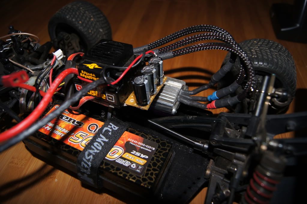

Tonite I finally had a bit of time to myself to work on the ESC. I added three 35V 1000uF Rubycon caps to the ESC and like magic my issues went away. ESC is very responsive now and brakes are better.

Ran it a bit today during my break. I still get only 2100mah use out of my pack before the ESC slows me down. Batteries were barely warm. ESC and motor were below 180F. Gearing was 46/18 and speeds seem to be in the mid 60's. The extra caps were nice and warm. I'll change the deans out for EC5 and start to datalog this setup.

The latest Castle firmware works just fine. The stutter problem snellemin was referring to was caused by the pack voltage dropping so low on startup that the processor on the ESC was resetting. As he said, adding additional capacitance to the input and using some torque control solved the voltage sag problem.
