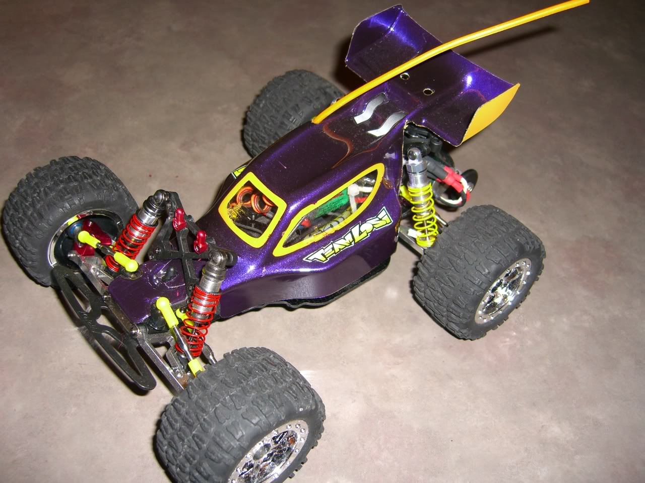

this will sound a little bit crazy, I know, but I run a mini-t with a mamba 25
controller, an external BEC, the mamba 8k motor and lipo 4S.
By now I'm using it with normal timing and a 16 pinion with 60 spur.
What can I say .... It' a ROCKET.
I cannot say with precision because I do not have any instruments to measure
the speed, but I think it can reach 130 km/h quite easily.
And I was very very surprised to see the motor was not so hot as I thought .
Sure, I am just able to make up and down on the street, without any turns,
and it's quite difficult to make it running straight on, even if it's longer about
5 cm and it has a Gyro on the steering servo.

Thats the carziest Mini-T ive ever seen!!! Basically a Mini-t dragster. Really cool. Like it alot.
What do you mean by a gyro on the servo? Where did you get the chassis?

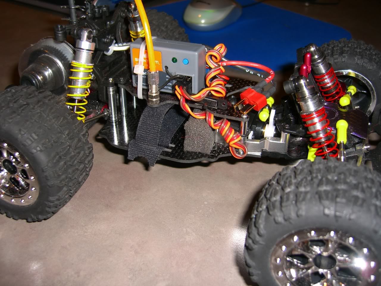

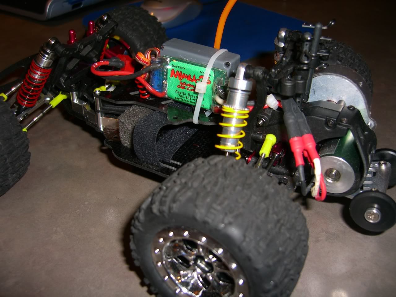

Originally Posted by neweuser
So the mamba came, I'm having issues with where to put the rx and the esc? Anyone got some pics I can check out?
This is the way I did mine. I put them back to back on top. Its only way I could make it fit. Having the esc that close to the rx is probably not ideal, but I havent had any issues so far. Here are a few pictures so you can see what I mean.
BTW: I have the mamba 8K also. Total waste IMO if you run lipo. Its way to fast you cant control it. I have 3s and 2s packs for it, but I run it on a 6 cell nimh packs just to make it semi reasonable.

The gyro is an helicopter element, it's useful to compensate the rotor torque
by the tail rotor. It just "listen to any turn energy" and it try to compensate it.
The chassis is self made, from a 2mm silver cabon fiber.
