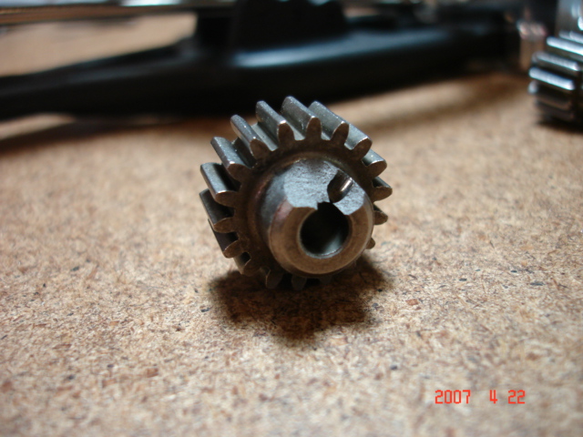

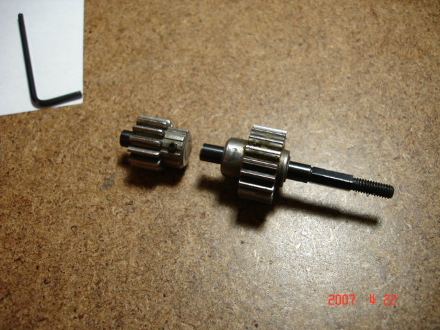

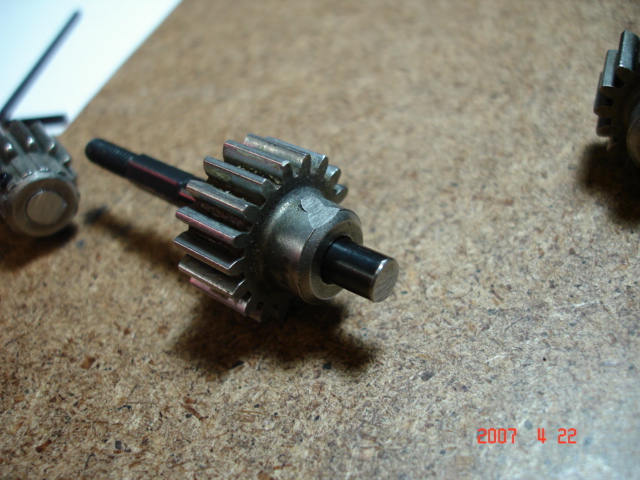

04.22.2007, 05:58 PM
Here is mine that I did. Guess what happens when your pin is to large? :026:
I had to use my old gear after I broke the new one! :035:
But it turned out very well, it was a very, very tight fit. I had to stop hammering it, and use a large vice to force it in. It worked!

Oh, i forgot to mention, i used a drill bit end. I can't remember what size but i had to grind it down alot, the first one showed it wasn't ground down enough.:024:
So hopefully this stands up to my 7XL. The gear is actually to original gear from my first emaxx.... 6 years old! :005: Still looks as good as the new, only a little grime inside the gears.
