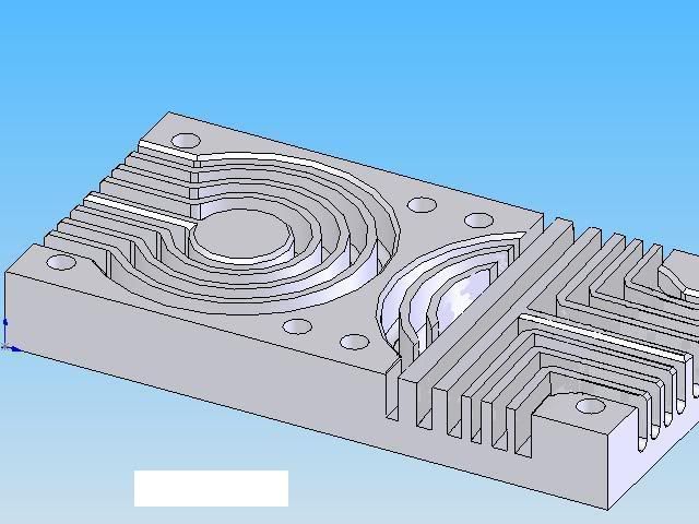

I was thinking you guys should start a new thread...
nativepaul
nativepaul's Avatar
Posts: 522
Location: Sussex, England.
05.09.2007, 06:13 PM
To get decent flow though a duct the inlet, its area has to be at least the same swept area of the fan blases. With the restriction of the blades creating narow channels you will need a lot more intake area than you have or the fan will be running stalled and have very little flow.
If you cut out channels in the sides as well as the ends something like this, it would triple the inlet area and restrict the flow a lot less.
The outside circle is the same diameter as the inlet diameter paul. I see where your going with those fins. It'snot going to take me very long to machine this, so we'll see what happens. I think at some point I will de case the controller and try to figure out some sort of "clamshell" sink.
