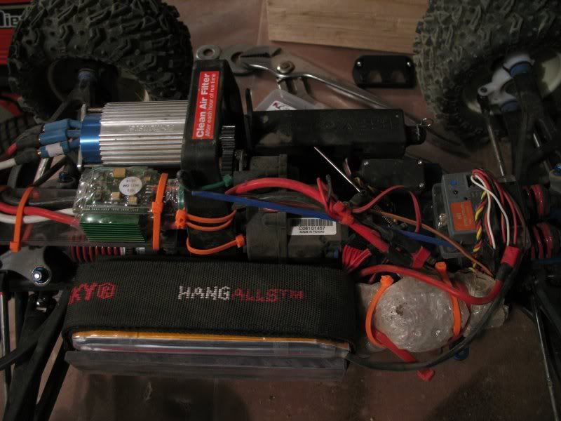

Where do you think I need it. It's hard to see the box in the pictures because it's clear. The box covers the bottom, outer side, and front. It was originally made to cover all sides except the top. But it didn't fit well so i cut off the 2 sides and trimmed it to fit in tight to the chassis. The poly under the ESC and the UBEC are the sides I removed. It also has a thin foam pad that is on the bottom and inner side to take some of the initial shock.
I like li-po and it doesn't really scare me but I still treat it with respect. I do plan on trying some A123s with my next Revo. So it's one less thing to worry about. Plus as I mentioned it's getting and RC-Solutions cage soon. Which from the pictures I've seen will need to be modified on that side. So I might add some extra support to the box using the cage as a mount.
So you think the low end power is the soft-start setting? I'll try the slipper first then I might try a different setting.

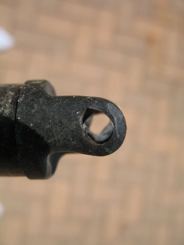

Well I can wheelie on demand now but it seems to be a bit too much. The stock axles can't take it with the new weight of the truck and the power pushing it.

DAAAAAAAAAAAAAAAAMN!!!
i havent even really seen them twisted like that! WOW man!

It was my first time on pavement with it tuned. I also lost second gear and reverse doesn't seem to work any more. I haven't had time to look into that yet. We still don't know how fast but it's hitting high 40s but I have to brake to stop before I run out of parking lot.

I have also made a few changes to the truck. Steering is now where is should be (I had more right then left?). The rear springs are now 33.7 lb/in fronts are 20.0 lb/in. The battery box is now mounted under the the AL tabs which both lowers the battery and helps to support the box during bad landings. I also took an idea from here to use a Home Depot Husky Hangalls strap for the battery. It works great and is cheap. But hard to find I had to order them off the website. After the 2 stores by me didn't have them. Add few more Ti things I had but hadn't put on.
Still a mess but a little lighter and getting better every day. Tomorrow I lock it into second gear and put the rear brake on.
