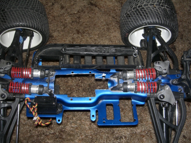

here is what I got so far...

09.15.2007, 05:50 PM
"Can ya tell what it is yet?"
Try test fitting the centre shafts, and you will see if you need to remove any material on the chassis around the rear output shaft of the tranny (thats the main area of concern usually).

09.18.2007, 01:49 AM
yupp you are right suicideneil right at the rear the pins on the shaft hit the chassis preventing it to turn... Thanks

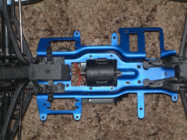

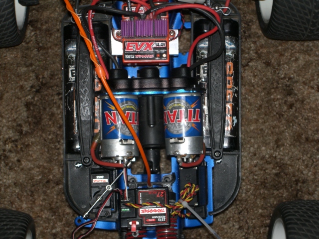

well I did dremel off more of the chassis like suicideneil had mentioned here is the new pic with one battery holder mounted

09.20.2007, 05:41 PM
So far so good. Clever use of an old Emaxx chassis there, will look semi-factory with both battery holders mounted (if thats the intention). Just make sure they're bolted to the existing chassis really well, wouldnt want them to separate at speed....
09.20.2007, 08:53 PM
Wow! You didn't need to cut anything off the rear - where it was rubbing you just needed to use the grinding wheel to shave off a 1mm or 2. That's quite agressive - hopefully won't hurt the chassis too much.
I'd round off your cuts to stop stress risers.
Cheers

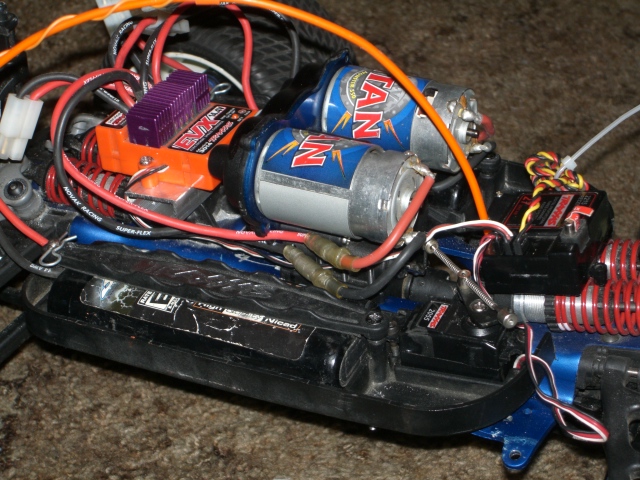

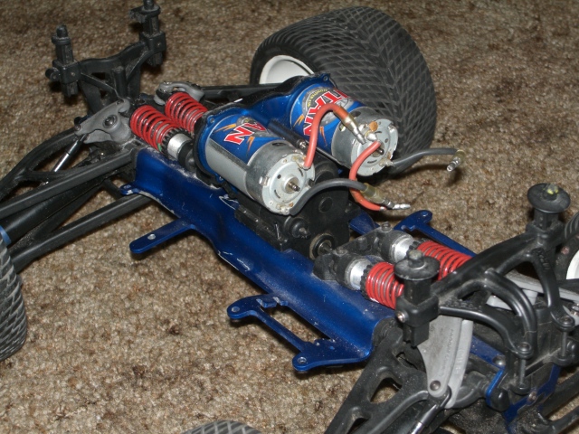

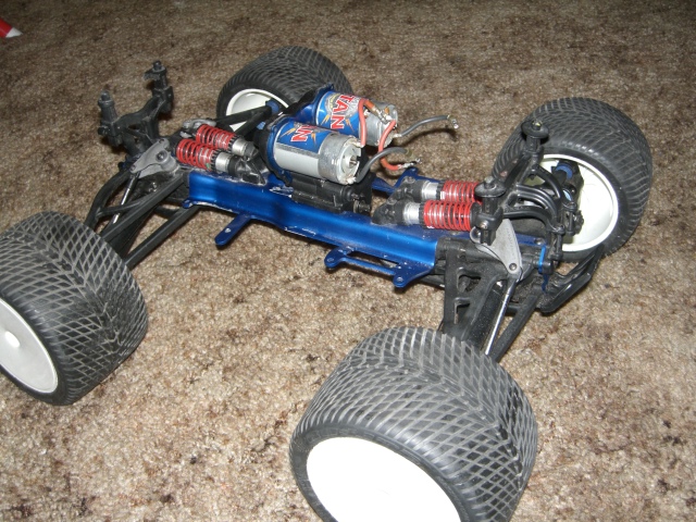

well here are more pics of my project build

offroader
Posts: 93
09.22.2007, 11:46 PM
Have you had a chance to test this with the Titans? You might want to consider BL motor if you can't get the speed you want.
09.23.2007, 09:12 AM
I have a funny feeling this is how the E-revo will look , more or less, when/if Traxxas ever get their finger out and build it. You may want to add a guard to that steering servo- looks a little exposed sticking out the bottom like that (just as it does on a stock revo/maxx). This is another one for the books I reckon, another unique creation.

thanks suicideneil I was planning on doing that and a guard for the tranny as well

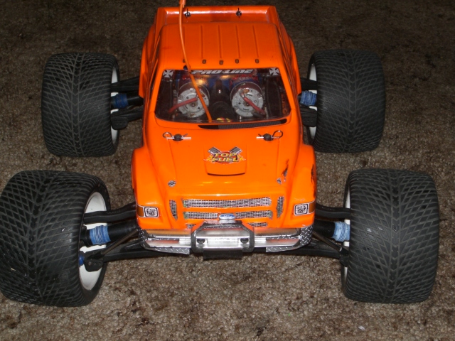

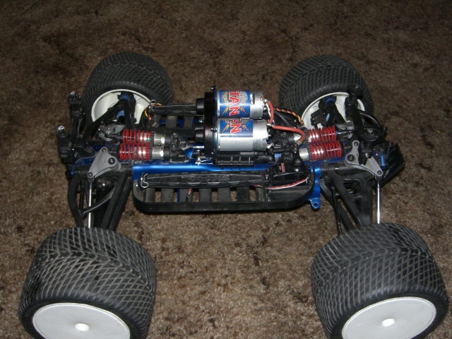

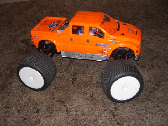

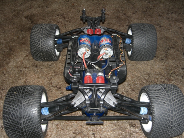

Here is my finished E-Revo minus the guards I would love to get a video of this monster in action but I have no way of getting it to the computerbut oh well it is mostly finished and I can run it
Thanks for all of the help....

09.24.2007, 12:03 PM
Wow, you finished that amazingly quickly, I think its a testament to how simple the chassis is to work on and how interchangeable parts are between vehicles (with a little filing here and there). Nice work & go enjoy the fruits of your labour!
