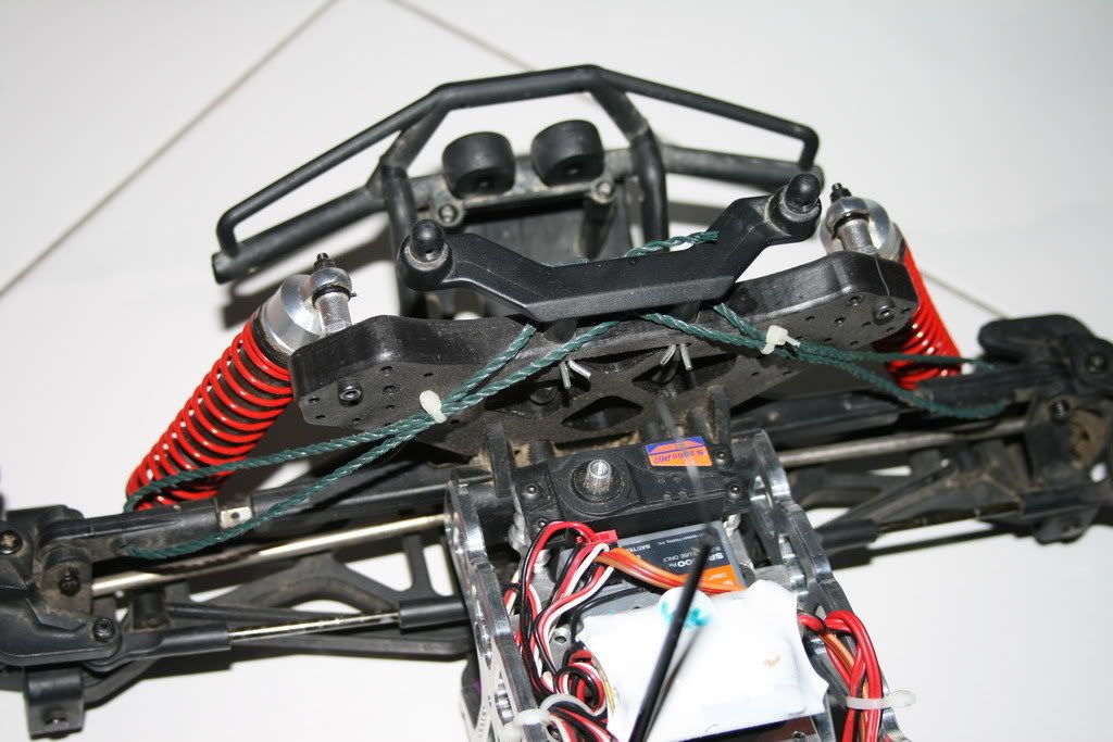

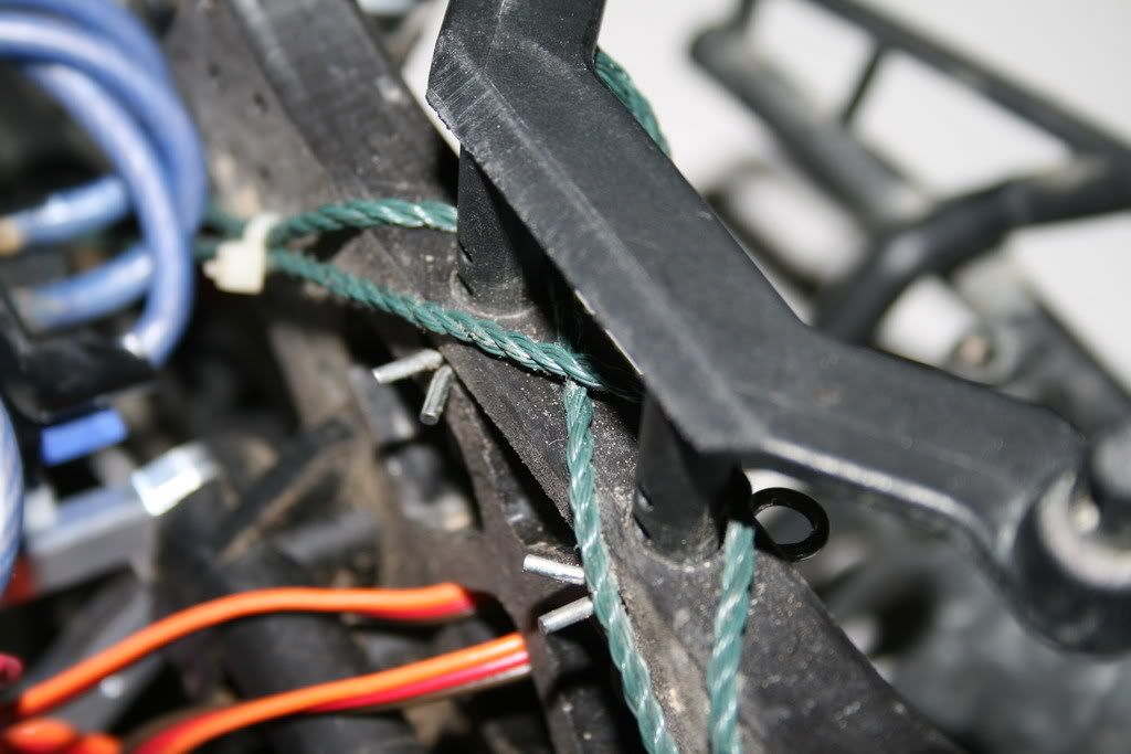

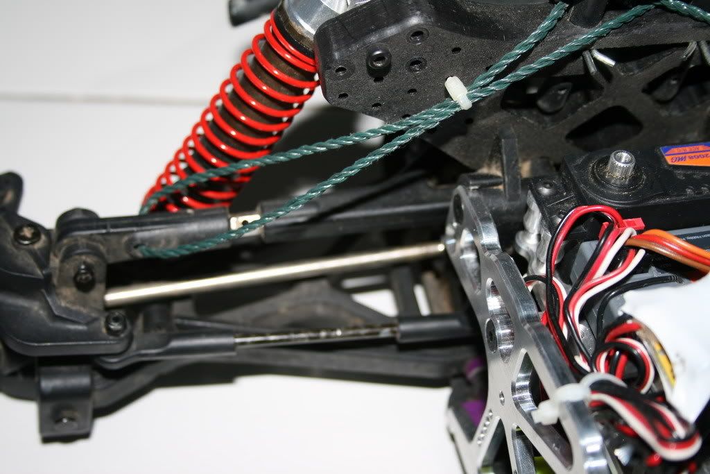

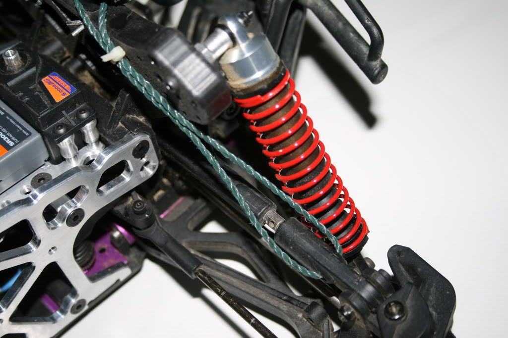

Thanks Joe. Yea. Id like to see how its set up in a little more detail. I want to limit the down travel of the arms a bit and I feel that just shortning the stroke on the shocks will just tear the shocks apart in any kind of crash.

Hi jhautz,
Here are some details :
Regards,
Joe Ling

Thanks joe. Those are great detail pictures. How does it work? Any issues you have found? How hard was it to get them all the same length?

Hi jhautz,
To be honest, I can't say I've tested this thoroughly as I have had only a few runs on it. However, I have another Nitro Savage with LST shocks with similar setup & I've had more time on that with good results.
No major issues with this so far. It's not that difficult to get to the correct length. I am using one continuous piece of string & tied it together at a point at the shock towers (note : tied the string to itself, not to the tower or body post thing)
Regards,
Joe Ling

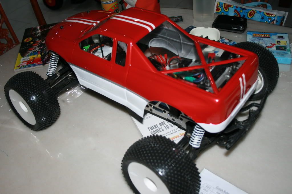

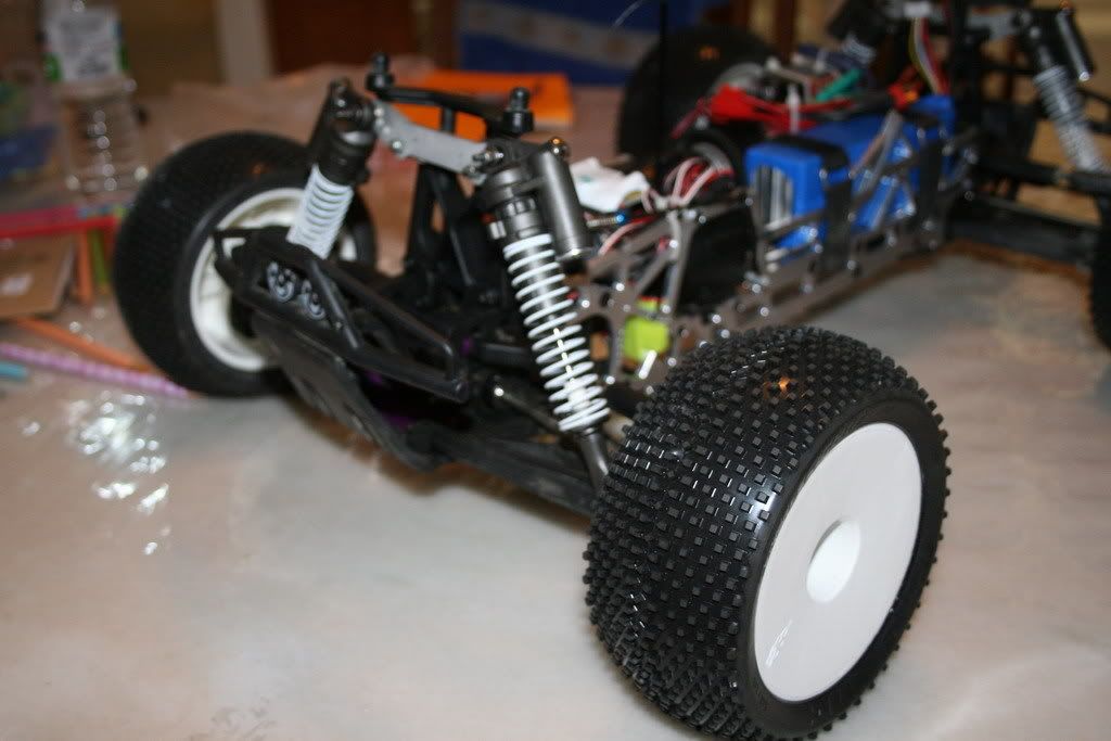

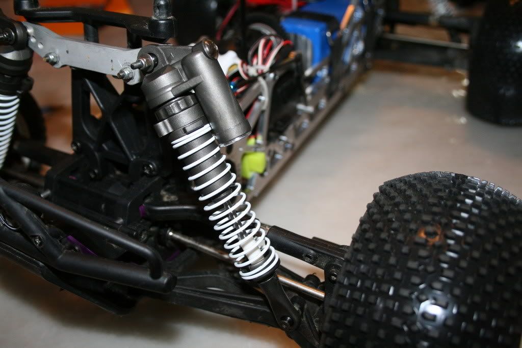

Hi guys,

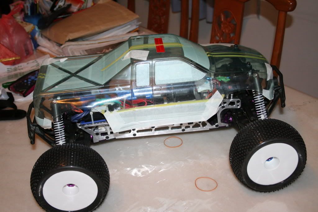

After a little off time due to other distractions, I'm starting to slowly work towards getting the truck onto the track. Here are some updates :
I find that the old MGT body fits this extended savage pretty well. What do u think ? The CEN shocks work out nicely too, We'll see wether they can stand the abuse that will be thrown at them .
Regards,
Joe Ling
Hyper 9e Medusa 4S, Savage 5S MMM 8XL, Jammin' 4S Neu MMM, X2 Ninja JX, X2 MMM 5S Neu, E REVO Medusa 6S

Joe Ling, what happened to the twisted toys shock tower? You dont like them?
joeling
joeling's Avatar
Posts: 463
Location: Malaysia
03.18.2008, 09:03 PM
Hi mothman,
After a little tip from cemetery gates in an earlier post, I found that the TT towers are cracked near the bolt for the shock. Pity as I always thought that they were bullet proof.
Anyway, let's hope the CEN shocks hold up.
Regards,
Joe Ling

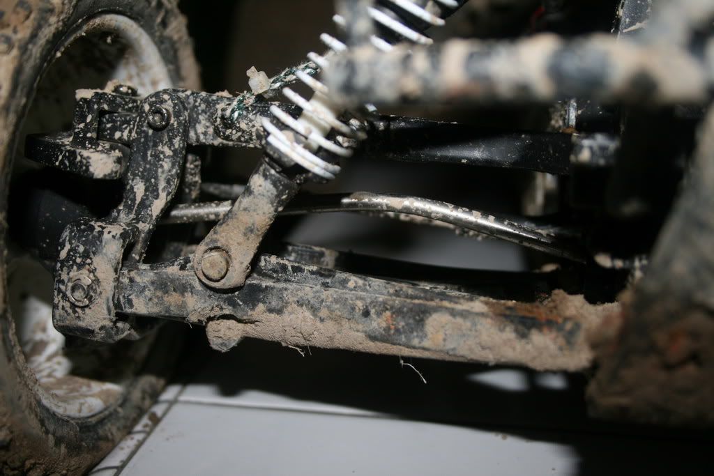

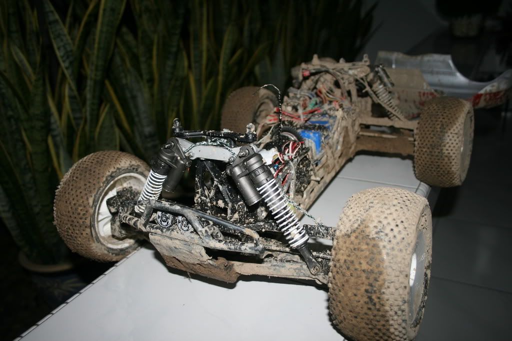

03.23.2008, 09:45 AM

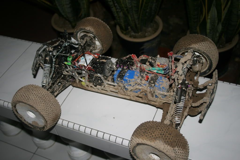

Hi guys,
Had a little fun in the mud earlier. Managed to kill my esc though. Time to look something more economical & use a lower kv motor. While it worked, the truck was silly fast. It really needs a wing I think.
Regards,
Joe Ling

jnev
jnev's Avatar
Posts: 2,864
03.23.2008, 11:52 AM
Thats awesome!! Thats how a truck should be run. Remind me of your set up again? I was looking through the thread but couldn't find the electronics you were using.
Great looking Savage once again.
