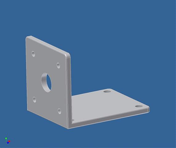

What do u guys think about the motor mount?

A simple L shaped bracket that mount on the CD holes would be easiest.

yeah i was thinking something like that. but a little more bracing, to keep it from flexxing. like this
