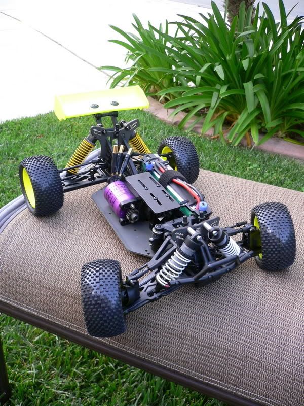

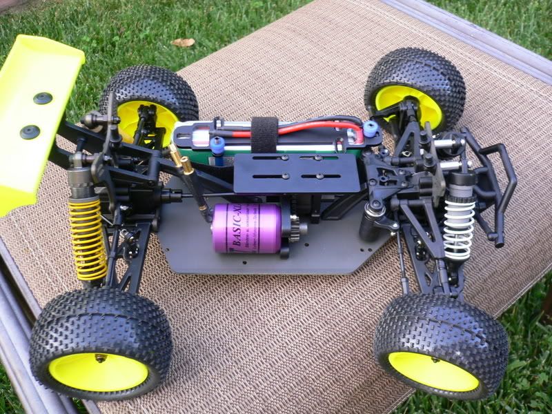

Couple pictures with all four new shocks installed:

Yep, looks just like mine. I had to cut 2 coils off each of the yellow springs to get the dogbones level in the back. I tried 25wt oil and it was too light, and I'm now running 30wt in the back and 25wt in the front. I've been thinking about getting the ofna blue springs for the front and cutting them down.

I'm running 40wt in front on the pink springs, and the stock oil and springs in the back. They seem to be perfect, but I still have yet to try the truck out to really know...
