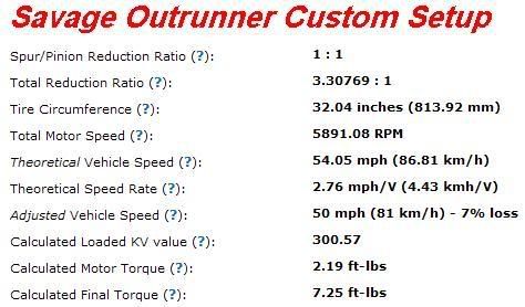

Takedown, have you played with BrianG's speed calculator yet?

Just tested it out. Heres what I got...

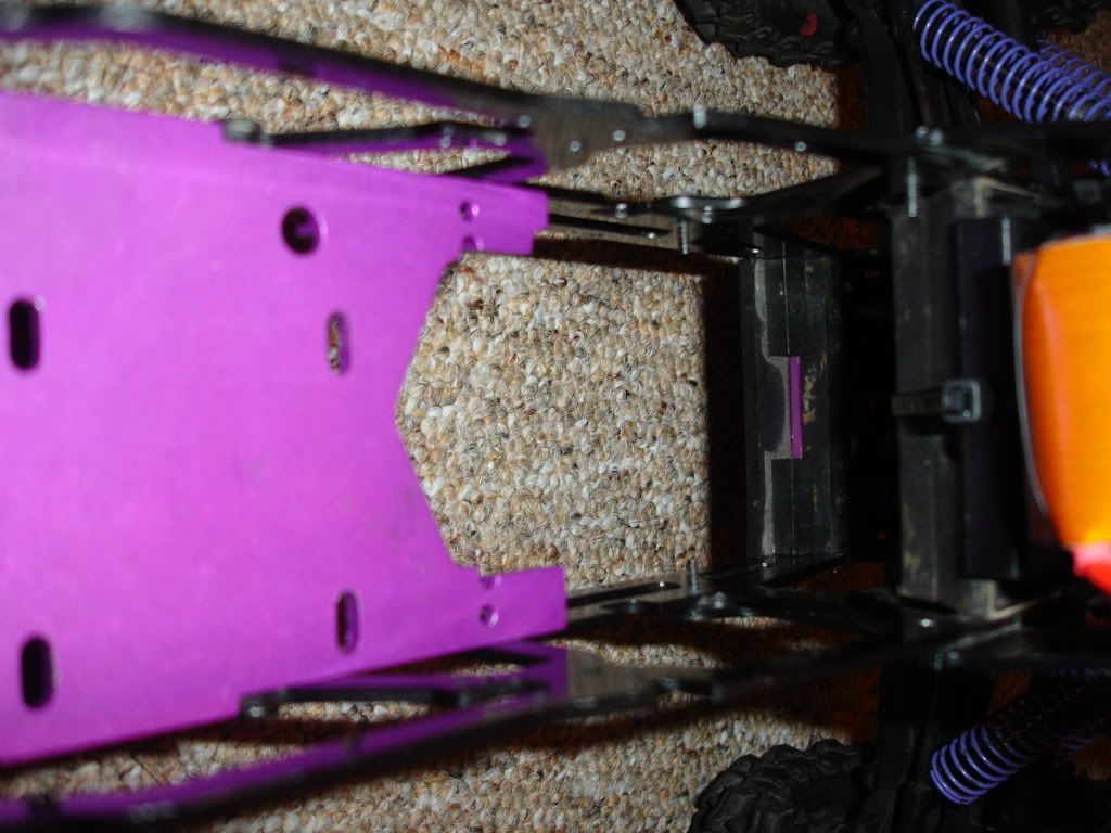

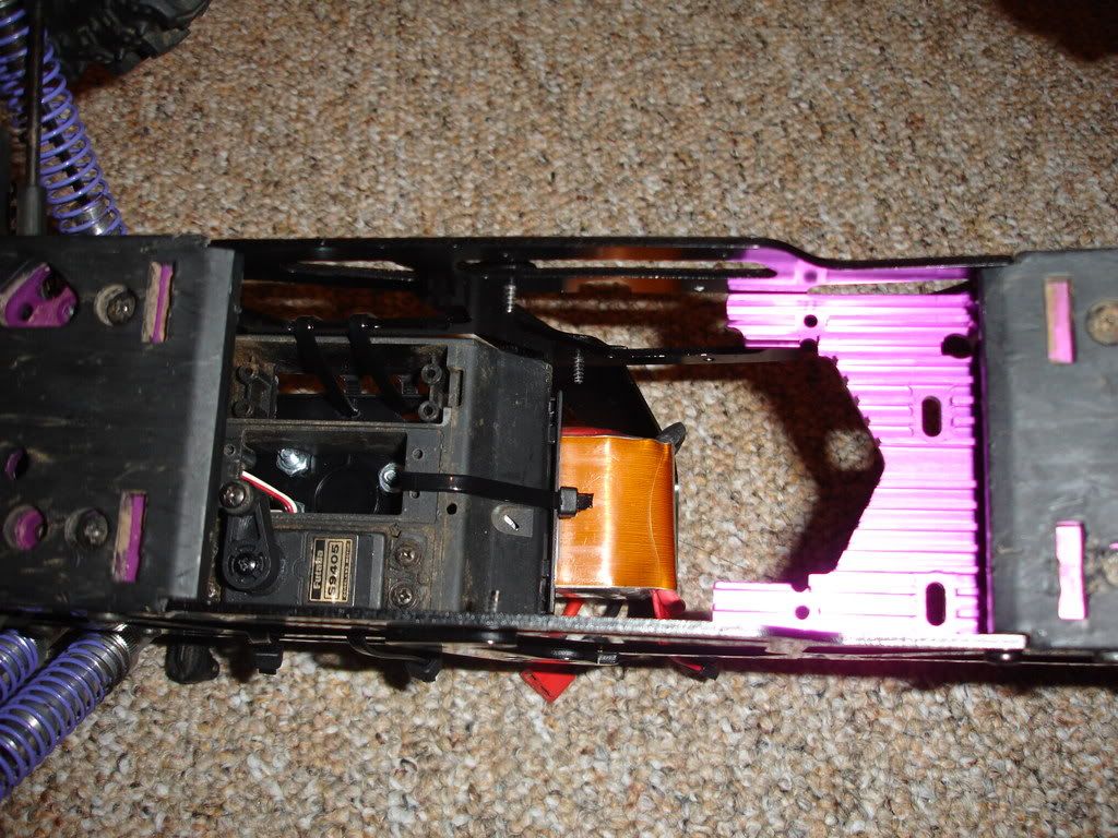

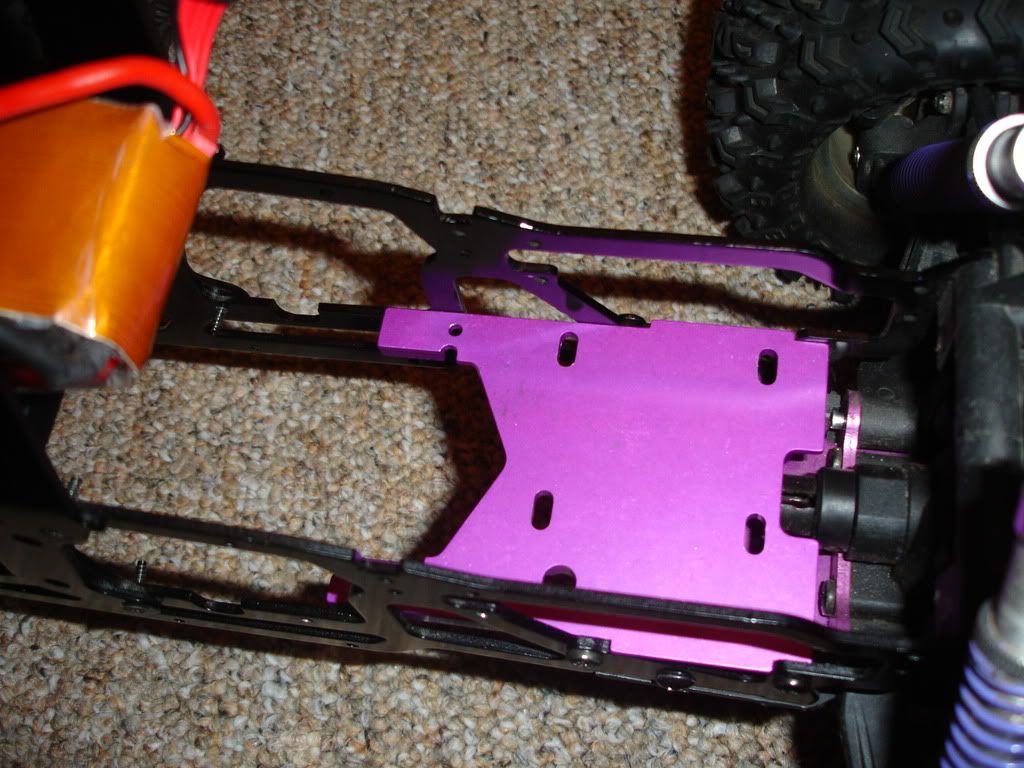

Ok here are some pics of the overall room and the layout of the Low CG HPI chassis... I think this custom setup can be done.

Hey Ryan, i had an idea that u might like... have u thought of running mechanical brakes off the outrunner? It will allow you to run cheaper-Higher voltage plane escs. or it would just take the stress off of you current speed control under braking.

Looking at the chassis (mabey you could set the motor in there just for size reference) I would say using a center diff (you can put heavy fluid in it to keep it from unloading too bad) and a large pinion gear (like sikes O-Maxx) would be the best bet. Later on you could get RCMikes slipperential to replace the center diff and you'd have all the bases covered. I realy liked the idea of a indirect mounted pinion gear (basically what you are doing with the motor-dogbone-2nd diff) to keep the load off the motor bearings, but I'm not sure you have the room to do it?
Mechanical brakes are a good idea too. You could run them on the center diff just like a regular buggy.
