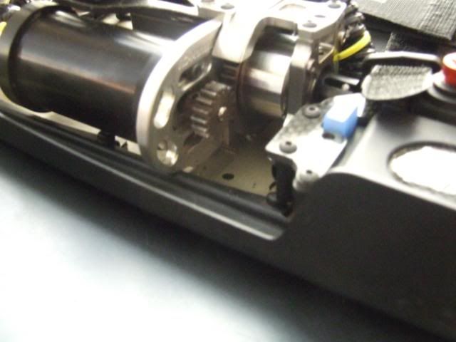

well since I scrapped the brake idea I decided to "buff up" the center diff ..thought id share, I got an aluminum diff cup from nova rc, it seems nice, drove well and perfect fit, see how it wears next lube change LINK. I threw in a RR 47t wide spur and some protek ceramic bearings for the diff LINK good deal considering the stock losi bearings are the same price (though you get 4) . Lubed it up with some graphite with molybenum. RC monster mount gh alum top brace and alum front brace should be bullet proof now !! Its quiter and brake noise is a bit less, not $45 less

Thanks for the compliment, followed the lead of the bright ones here and got my questions answered and put it together... I ditched the brakes for a couple things. Ill make points incase someone wants to check issues or solve them or laugh that I couldnt.
1. the center diff is turned around in the 8T conversion so the pinion can reach the spur, so the top brace is turned too, which moves the front and rear brake cams which are different lengths and placements and would then push to stop instead of pull (or vice versa I dont remember) and they dont line up anyway. I drilled out a hole in the front center brace next to where the cam was originally and shortened the rear cam to fit in the front new hole. I dont entirely remember but it goes together after that and some shims somewhere in there lol I dunno if one of those extra long pinions would have just fit with everything in its normal place.
2. you would have to drill alot of holes to mount up the servos and the brake servo would be partially supported on the mudguard which was lame.
After messing with all that and nearly drilling, I didnt want to mess up the 8T because it looked so clean and was together so nice with the parts everyone recommended..The mystery and romance of doing it was gone because Tekno has their version out now with a wider chassis and all the stuff to do it right. (and im lazy) So I just put it back and figured id buy that and try it out eventually. If i dont like it one of you can buy it from me for less and see if you do lol..
Sorry to ramble and be vague but maybe someone will know what I mean when they are staring at the brake parts, servos and 8T lol
