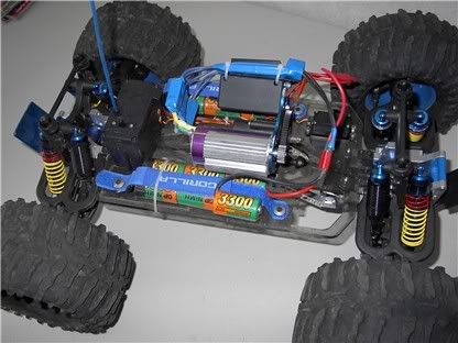

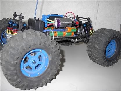

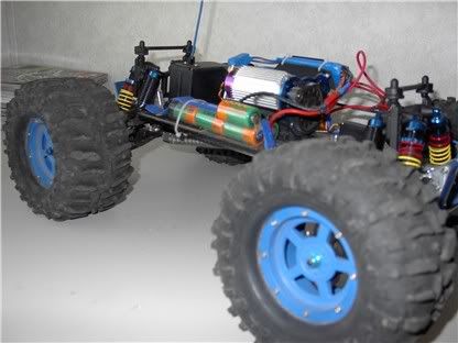

Well, I finally got this thing done enough to run. I finished up the last couple items on Friday night and spent the better part of Saturday running at the camp ground we were at. All I can say is WOW. It is definately everything I thought it was going to be. Its about the same size as a MGT and runs like a stadium truck. I couldn't believe the power this thing has. Extremely quick and nimble for how big it is. Handles better than any truck I have owned. Definately worth the money I have put into it. Here are some pics of how it ended up and it next to my BL XXX-4.

Thats a nice truck, what diffs are you running, also, what runtime did you get? Thats an awesome looking machine :)

Thanks, I really like the way it came out to. I was a little nervous about half way into it. Was hoping it would be worth it in the end and it was. The diffs have Integy blue aluminum diff cases w/ collars. Front diff has Maximizer ultra diff set-up and rear has the Maximizer diff gears

Great looking truck Maxxbashers!
What are those blue square thingys between the controller and the motor? what plugs are they?

They are aluminum electrical splicers I got from the local hardware store. I couldn't find anyother connectors to use. What is the usual run time on these things? I am running matched GP3300 w/14 cells. My gearing is 20/70. Seems to be chewing through the batteries pretty quickly. Is it the connectors between the controller and the motor that I am loosing it at? I love this truck, but the run times are terrible. I don't expect it to be the same as nitro, but I do expect it to be worth the trouble of walking outside to run it. I am charging everything now and then going to time it to see exactly what run time I am getting, but it seems like its less than 5 minutes before it starts dying.

what kinda temps are you getting from the batteries, esc, and motor? i would definately get rid of those connectors. your gearing might also be part of the problem.
