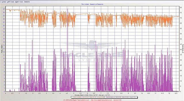

I know these pics won't last for a long time, but here's an Eagle Tree of the run and some of the final build pics.

The 1512 is way too much power for the truck, but who cares. It isn't heating up at all and the extra weight with the 6S battery just gives it a little more stability.
As you can see from the Eagletree, except for one big peak of 1400 watts, the general max amp draw was about 800 watts or so with a peak amperage of around 40 - 45 amps.
Running for about 12 minutes used ~1200mA, so I figure about 20-25 minutes of hard running on a TP 6S 2600 mAh pack.
