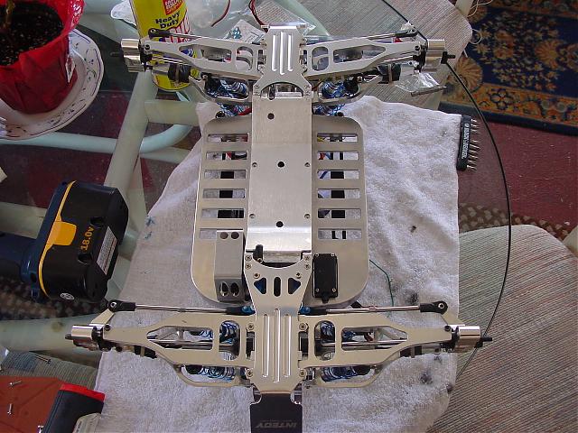

I got a setup but now my truck cannot handle this power. i bought the hv 4.5. its fast enough for me but the amount of tourqe keeps killing my diffs. what kind can i buy or should i buy without killing my wallet. Also my center shafts keep falling apart. there mip cvd's. my diffs are robinson racing with stock spider gears and integy diff cases. my bearings keep burning up also. i need help and recomendations please.

I have the aluminum cups and the 3mm screw setup. I destroy the pinion and the spider gears inside the diff. im running the truck in 2wd. Do i just have to much power to the rear of the truck?

Sounds like you need to upgrade to 1/8 diffs/
  (#40)
08.28.2007, 06:04 PM
Yep, FLM hybrids & 1/8 HB diffs, RCM center dogbones. Thats about the only way to go really- only UE offers another option with their 1/8 diffs, but they are way expensive & never in stock. Nice truck BTW.

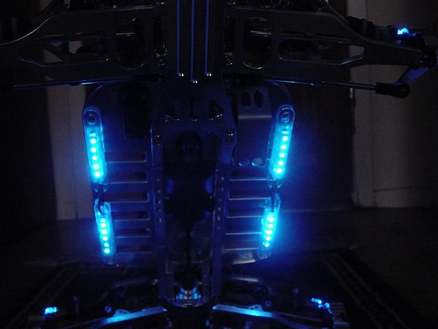

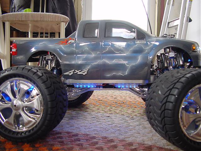

Which 1/8th diffs? They don't make 1/10th scale strong diffs for my truck? Should i just run it 4wd? let me know what you guys think. Thankyou for the complement. my truck has a seperate electrical system for the custom light kit i designed.

Heres more pics for you guys. I appreciate the help.

That's a nice truck man.

Hot bodies 1/8 buggy diffs- they are sold in the RCM store, and fit inside the FLM hybrid bulkheads. No-one makes aftermarket 1/10 diffs for the maxx, just a few alloy cups and ring gears with 3mm screws. If its the spider gears that keep failing on you though, thats no help, so 1/8 diffs is the only way to go.
