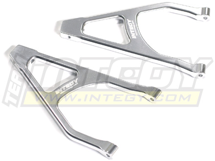

Upgrades Coming:
Custom Delrin A arm pins
Still trying to decide on battery, 4S , 5S or two 3S lipo ?? Suggestions
Mamba Max, later on a MGM
Losi aftershock -LST Center diffs, Front with HD Diff case and 7000k oil
Losi aftershock -LST center rear with locker/spool
Integy Revo Rear arms for Front and Rear Uppers
Losi 8ight or Ofna Front shocks

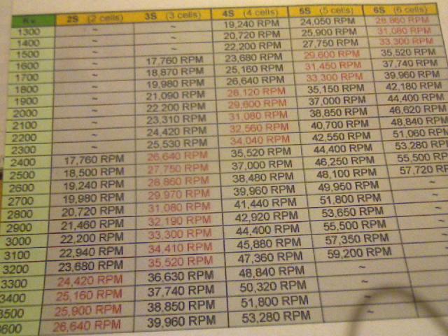

You'll need to decide what voltage your going to run then choose a motor with a kv rating to spin 30-35k.

The web page is no longer available so i took a picture of my print out.

Wow thats cool, What does the red mean in your chart? is that optimal
I dont know where to start on what voltage to run, becuase I dont know what motor to run to get the speeds to 60mph.
price wise it looks like one 5S 5000 25C
or Two 3S at 15C each put in Series, would I need 2500's or two 5000's ?
Edit in later today
I guess I'll go with a castle 2200 motor ... so a 4S or 5S, castle tech was telling me, that with my setup a 4s should bring 40-55mph and a 5S 55-60mph , and if it's not hot bump up the gearing.
