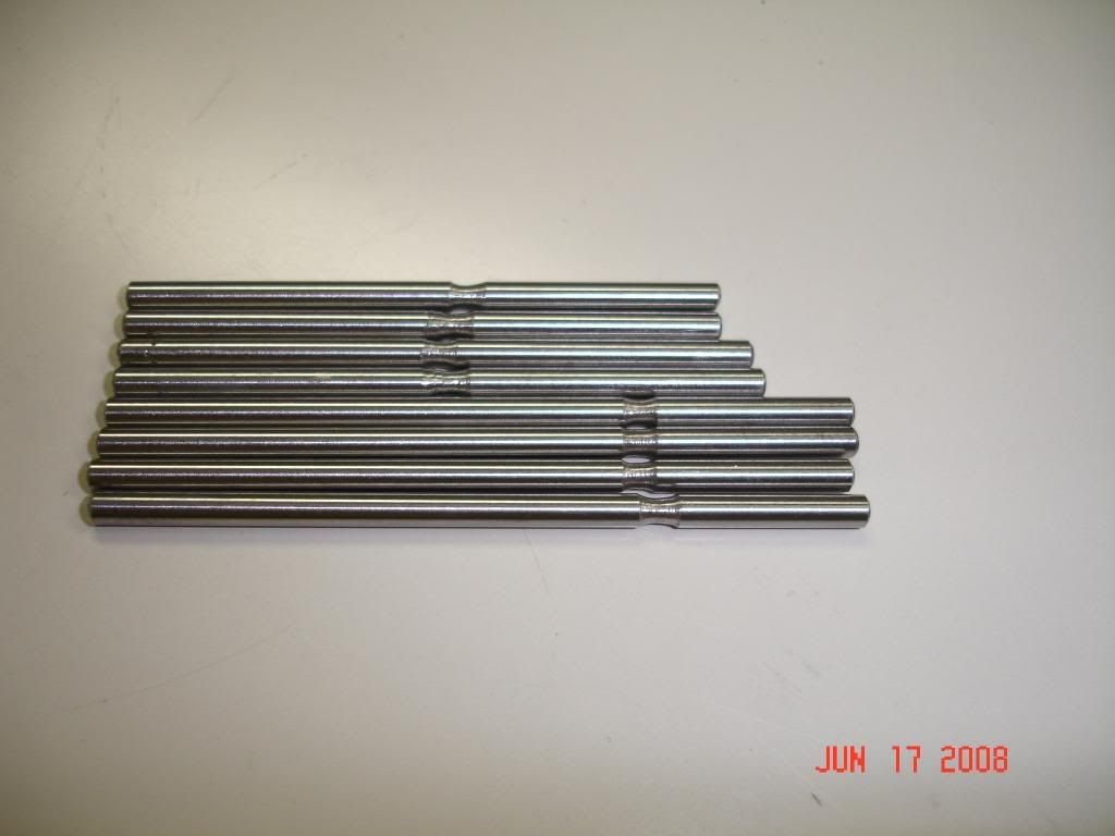

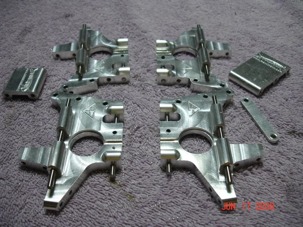

  (#36)
JERRY2KONE
JERRY2KONE SUPERMAXX
JERRY2KONE's Avatar
Posts: 3,452
Location: HAYMARKET VIRGINIA
Pics for you. - 04.30.2009, 07:53 AM
Here are some photos of the pins I received. I left the knobs on the end of the first set that I cut, and with bumper mounts installed it is impossible for them to come out on their own. Like Lito said the 1/8th inch are what you need. I really like the chrome pins because they are very smooth, which helps the arms move easily. I have had to remove way too many bent pins due to them getting bent in just simple bumps. These are much harder and they do not bend easily like the Ti pins do. They really are great.
SUPERMAXX YOUR LIFE.

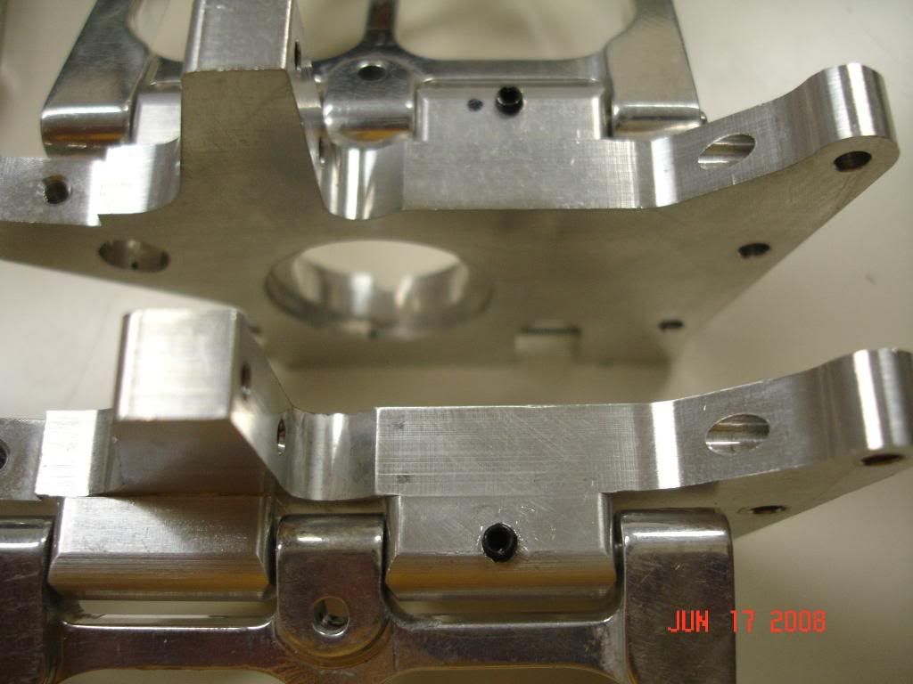

I drilled and tapped my GA bulks in order to capture the pins. This prevents them from moving and greatly reduces the chances of bending them. Besides, they'll break before they bend.
