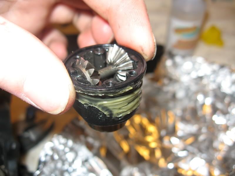

i am going to put 50k oil in the front diff and 10k oil in rear diff and i put gold shocks on the back and green shocks in the front. i got my front diff all taken apart and im not sure how much to fill this thing up with oil.
this is where i put the oil right?
i hope it will handle a lot better now with new shocks and new oil. i still need to get 300k oil for the center diff and im thinkin about getting the rpm true track and i got the revo platinum edition body for it
