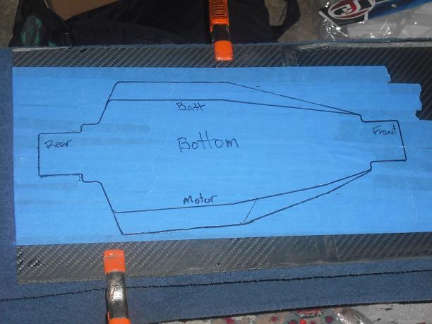

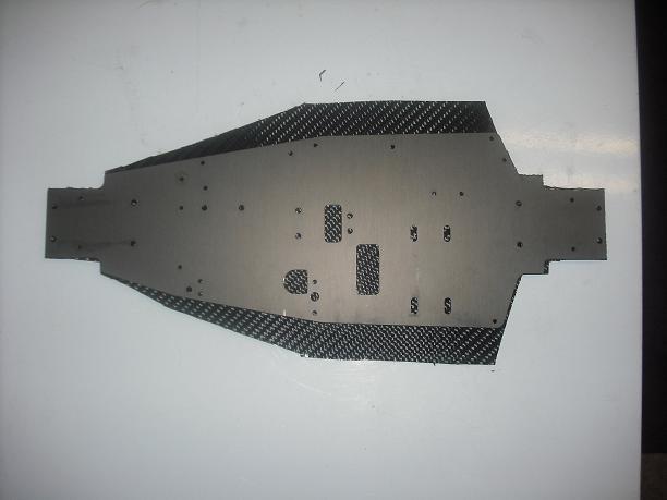

I finally recieved my CF sheet from Composite envisions and it is absolutly beautiful. Here are a few shots of the template and the cut out chassis.
Name:	GTP II CF template.JPG
ID:	7474   Click image for larger version
Name:	GTP II alum and CF chassis.JPG
ID:	7475   Click image for larger version
Name:	GTP II CF chassis overlay.JPG
SWEEEEEEEEEEEEEEEEEEEEEEEEEET! let me know how this works for if u like it I may do the same to my on road

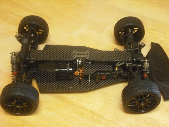

Here is the finished GTP II. Motor, ESC and battery are soon to come.
Name:	GTP II assembled.JPG
ID:	7477   Click image for larger version
Name:	GTP II CF assembled 2.jpg

How thick is your CF chassis?
  (#43)
Big House
Big House's Avatar
Posts: 372
07.25.2009, 09:22 PM
The chassis is 4.4mm thick. I re-cut the top plates as well as the servo plate. I almost don't want to run it, but there are nitros that are dying to be beat.
