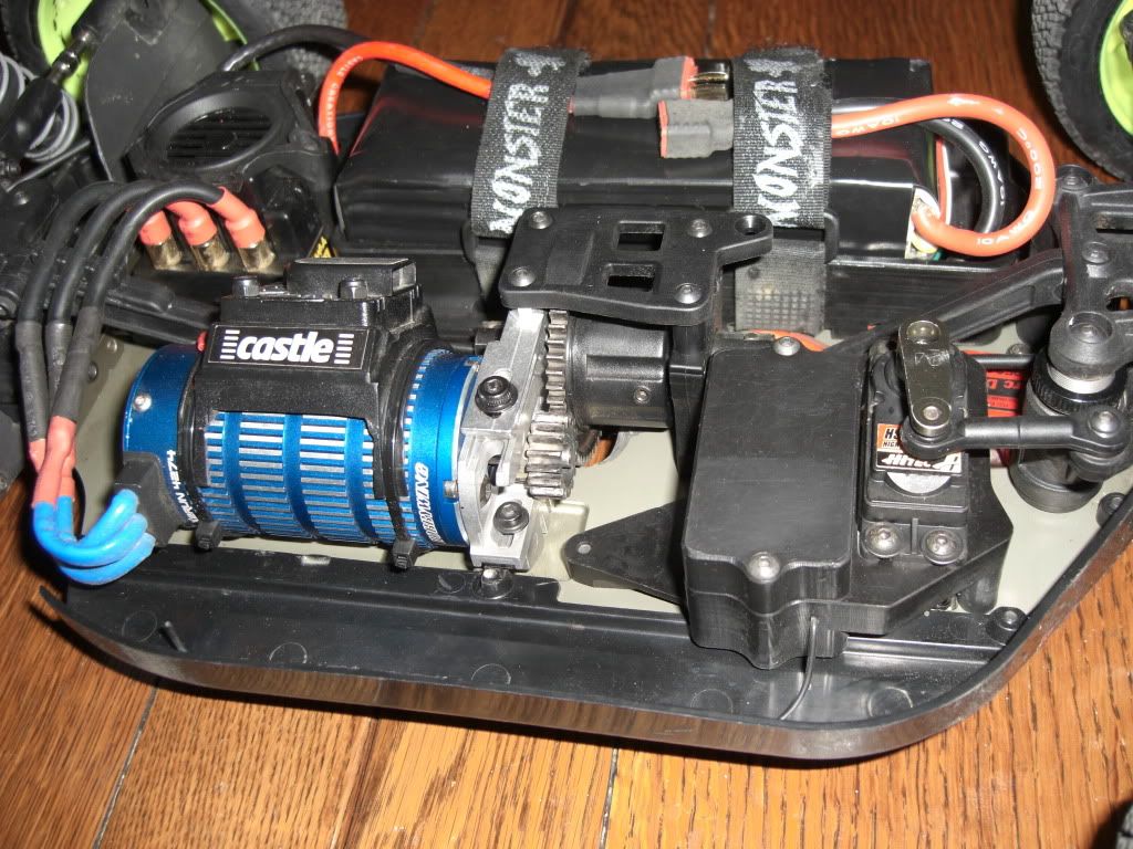

Yes it's worth using, but I do recommend opening the bottom of the shroud between the ziptie tracks a bit to increase air flow across the motor and not by a huge amount but to where you have about 3/16 clearance off the motor. As for the fan the original didn't make it trough one race and none like to be ran on their side, so keep the fan as flat as possible.
This is a pic of the blower in my old D8, I think you can see about how much I removed from the bottom of the shroud.

What motor is that??? It has longitudinal fins....that's why you had to cut the shroud. A CC motor has the fins around the circumference and that allows the air to escape freely.

It's a Hobbywing 2000kv but I also have 2 CC motors and it's the same effect with those. Restricted air flow is one of the problems with this unit, the other is fan size..too small for the task at hand. A 30x7mm fan might do fine on a 540 but not the 670s.
