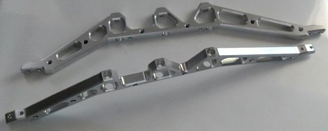

A few new pictures, including chassis braces.

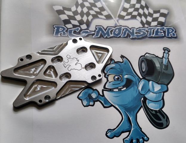

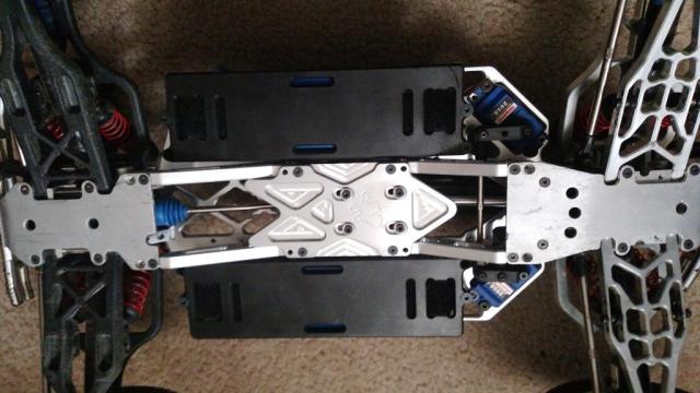

Shown with RC-Monster universal mount and 58t mod.8 Slipperential.

The mounting setup for the center diff is slotted to allow optimal dogbone fitment as well as accommodate various differential sizes. The truck in the picture is just a build dummy, so it has stock diffs. The skid locates the mount to accept the Traxxas rear steel center cvd with an aluminum front dogbone(85mm pin to pin is ideal length).
