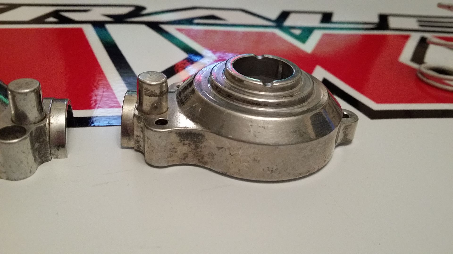

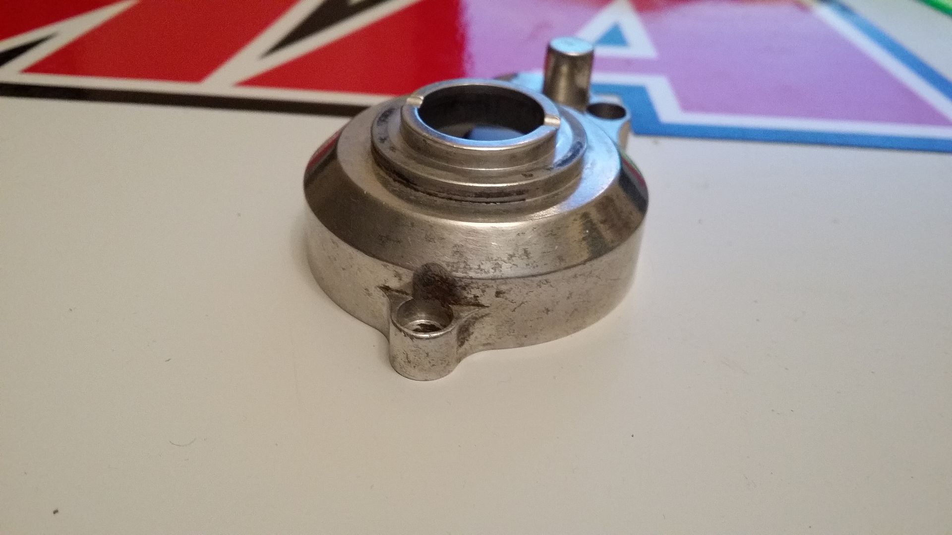

So I taught myself how to polish with a dremel today. I had only ever wet sanded and polished by hand in the past, as that is all I had ever been shown to do. When I was growing up my school never had a woodwork/metalwork class, so I never learnt a lot of things I wish that I could have.
This week's project was to restore & polish a set of front & rear Unlimited Engineering Ultralite Diff Cases. I started trying to wet sand them, and quickly gave up. Far too intricate to sand & polish by hand. This is what I was working with anyway:

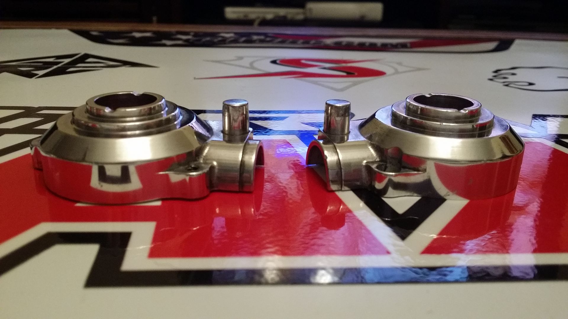

So I cracked out google, and sure enough youtube was there to save the day lol. Pretty happy with the way they turned out:

07.04.2015, 11:00 AM
Looks good indeed!

And may I ask wich grid sandpaper you use to make it shine so much?

Everything I know about polishing I learnt from a friend of mine on the UE forums. Sweetride4Me was one of the 2 guys behind the sweetstrobe braces for the maxx trucks, and is a great guy. He loves to hand polish, and after several of us asked how it is done, he put aside a weekend and documented a how to, as well as post up some youtube videos also. Check it, as it is a good way to get started:
http://www.unlimitedengineering.com/...ghlight=polish
Regarding what grit sandpaper to use, it kind of comes down to what you are working with, & how scratched up it is... If you say were working on a new part, without any abuse, then I would start with 1000 grit, then onto 1200, 1500 and finish off with 2000. Once you have gone over the part with 2000, you can then polish using Meguirs Metal Polish to get rid of all the small scratches and bring out that mirror finish. It is very much you get what you put into it. The more you sand, the better the result. If you are working on used parts, then it will save you a lot of heart ache to hit it with 400 grit 1st, then 800, then 1000 & so on...
