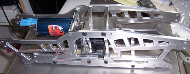

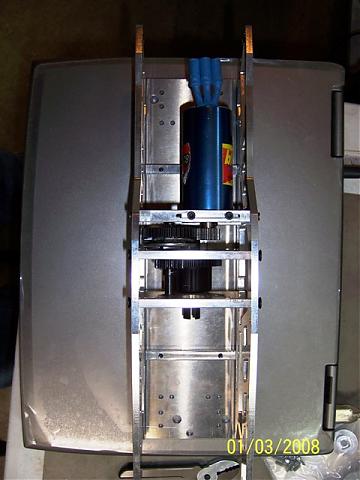

That project actually did turn out, Ben. The 1st set got lost by the anodize company(not mine, but the owner who sent it on his own). There were a couple minor errors in the tvp file, and the motor mounts were modified and beefed up a bit as well. I fixed re-made the parts, only to have them returned in the mail (again, the end user left the country and missed the delivery, so they were returned). Funny thing - the new tvps sat here for about 8 or so months and the owner contacted me with a brother here in the states, so delivery was made once and for all about a week or so ago. Someone will be driving that Savage conept one day. :)
I attached a few early pictures of the 1st version(after machining, but before cleaning them up - just a mock assembly). :)

  (#43)
traxxasbasher13
12.07.2008, 11:53 AM
That looks really good. Hoe thick are those tvps?

12.07.2008, 12:44 PM
Almost 5mm thick (.1875" or 4.76mm) - thicker than they needed to be - and made from 7075. :)
