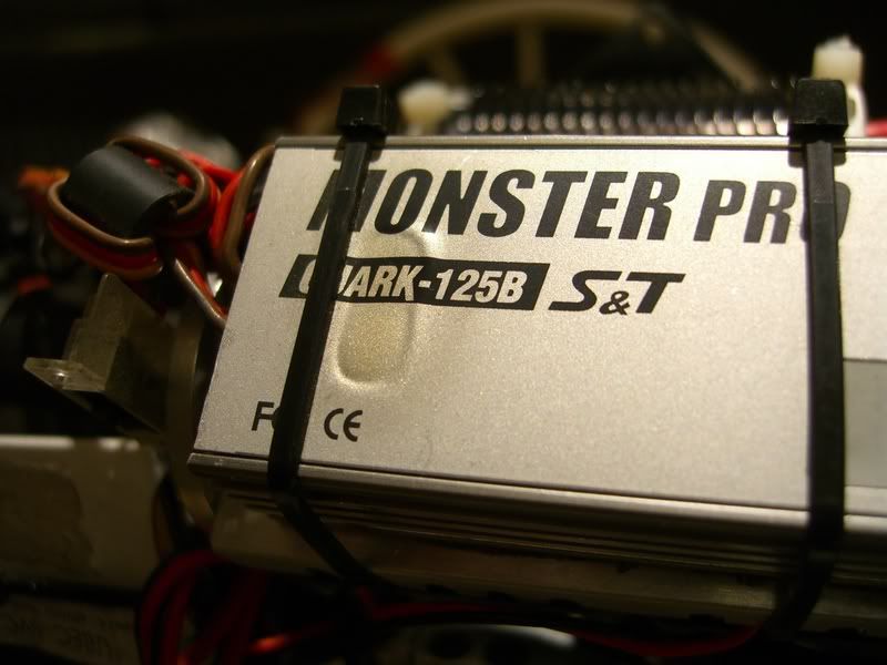

09.27.2006, 05:24 PM
I wonder about the BEC related specs.
The only information I found was this:
BEC Voltage: 5V/5A (Input 8.4V, Peak 8A)
Hope this doesn't mean that the internal BEC can only be used at 8,4V battery voltage?
  (#40)
neweuser
neweuser's Avatar
Posts: 3,379
Join Date: Feb 2006
Location: Minnesota
09.27.2006, 05:27 PM
You use a UBEC with it when running high voltage so the internal would be "disconnected".
  (#41)
Serum
Serum's Avatar
Posts: 10,480
09.28.2006, 01:15 AM
Yes, correct.
The internal BEC can not be used on higher voltages.
  (#42)
felix
09.28.2006, 03:19 AM
Did anyone try to use the internal bec with more than 8 cells?
I've used an external bec before, never liked that too much..
  (#43)
jhautz
jhautz's Avatar
Posts: 4,217
Location: Chicago, IL
09.28.2006, 03:54 AM
Don't do it. This is what happens.
I did it by accident. When I got my first one, I wanted to test it out so I plugged it up to a 3s pack not even thinking that it would be to much.
Everything still works...including the BEC, but it looks ugly. Had I not realized it right away, who knows what would have hapened. This happened just sitting on the bench. Wasn't even running it and it overheated the BEC.
to make it...
or break it...
Silent...But Deadly
  (#44)
Serum
Serum's Avatar
Posts: 10,480
09.28.2006, 06:33 AM
A picture tells more than a thousant words..
the speedo still works i presume?
