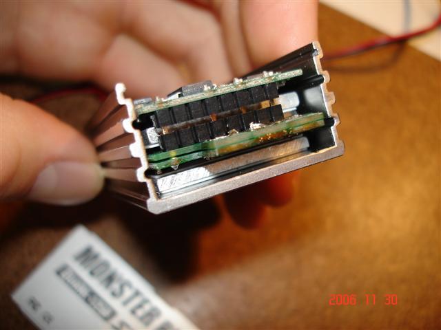

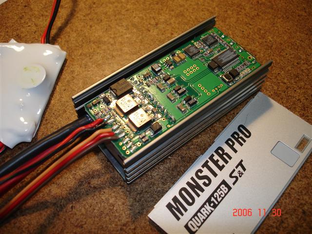

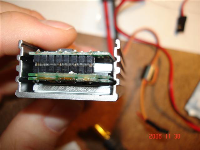

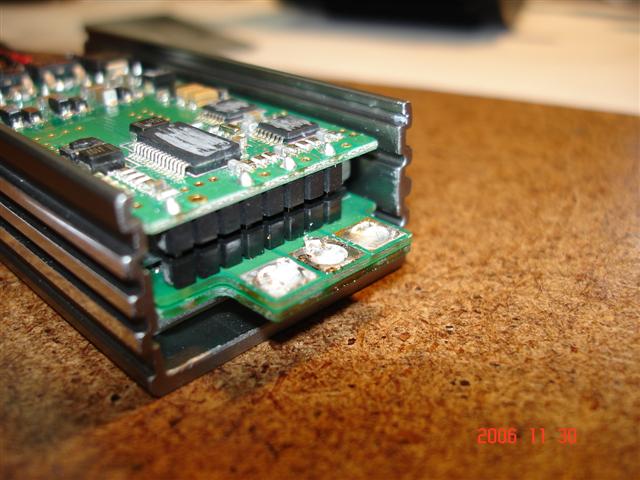

Anyways, i go it all apart, except for taking it off the case. I notice that there is two alum. slabs one on both side of the bottom circuit board, and it looks like they are the same FET's ???!!! What!? Do you know if this is true? Or are they for something else? CHeck the pics, if they are the same FET's then maybe all they need is some heat spreading? And the thermal pad is just to attach to the case? It also doesn't really look like the pads are .5mm, they look thinner than that, maybe .3mm? I don't know... I don't want to take it apart yet, i don't have Thermal Adhesive at the moment, i'll pick up some Arctic Silver stuff when i can.
So is there two layers of FET's on the two sides of the power board?

You should really use the Arctic Alumina from Arctic Silver to bond the aluminum slab to the FETs. "Arctic Alumina Adhesive is a pure electrical
insulator, neither electrically conductive nor capacitive." here is a link http://www.arcticsilver.com/arctic_a...l_adhesive.htm . When I did mine I could not find it locally anywhere so I had to order it online. PC shops online are the best place to get this stuff. It is good stuff, but it's a perment bond!
I only bonded the outside FETs to the slab and case and did nothing on the aluminum slab that is sandwiched between the boards.
Your pretty brave doing this on a brand new controller! :027: but it does make a difference especially for bigger vehicles. It seems to cool quicker and overall more efficiently.

Hey, just to add, it appears once i took a closer look, that the slab attached to the case is only touching on the edges, it's not even touching in the middle...
Yes i was planning on using Alumina.
Do you think this mod is necessary for a 1/8 emaxx buggy? It will weight in at about 7.5 lbs. What do you think?

The cover plate does slide off if you pop that little clear piece, but it's still kinda hard at first. So, I just popped off one side and it came right out. It's plastic so it bends a little.
The slab in mine was touching the middle as well. The pad covered the entire slab on both sides.
The inner slab is actually for another set of FETs. There it acts like a heat spreader. Ideally, you would find a way to attach that slab to the case as well, but it would be a little difficult. Smertzog (or something like that) installed huge heatsinks on his, but doesn't use the case anymore.
As far as if it is necessary for your emaxx: Improving its thermal characteristics is good for ANY vehicle, but makes more of a difference with heavier ones. Cooler devices means better reliability and longevity.
