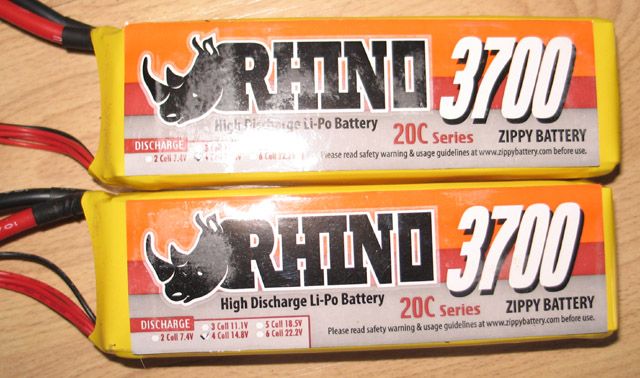

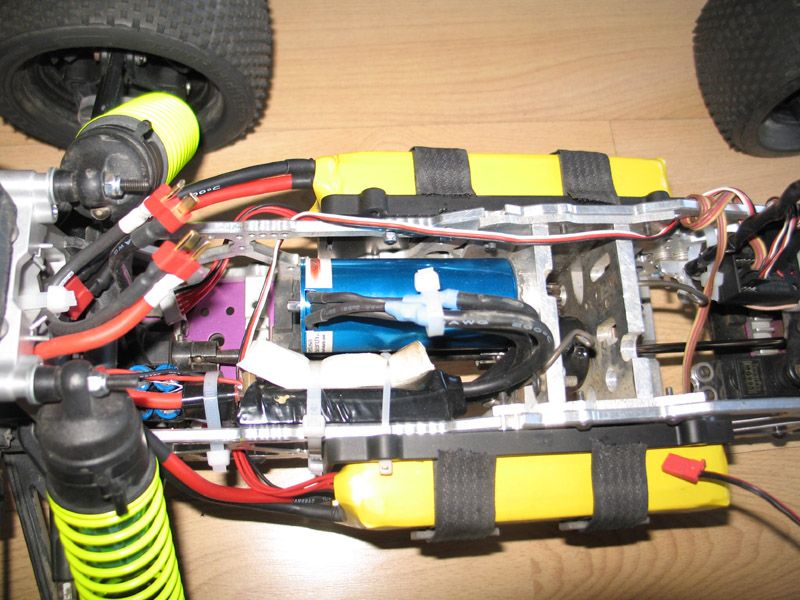

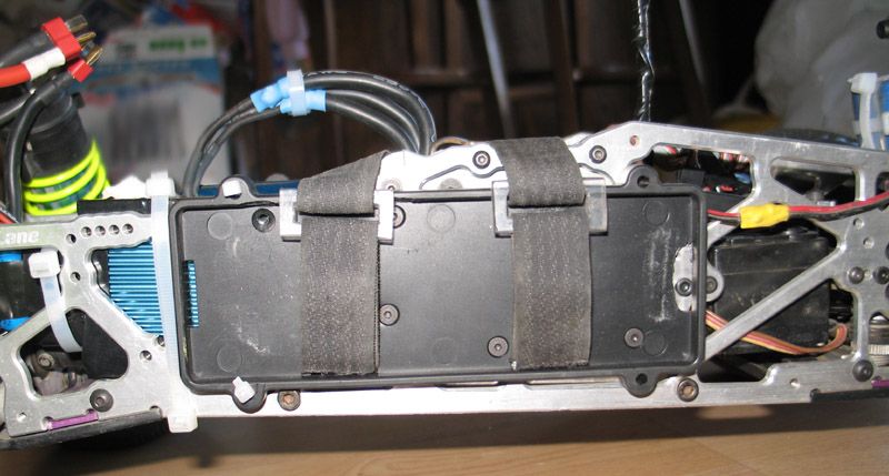

I wanted to use a different/lighter/more powerful battery setup than the 9s1p A123 the truck was running previously. Enter 2 Tekno universal battery trays and 2x 4s 3700mah Rhino packs in series. 8s 3700mah! The gearing was set at 14/46, with stock Savage diffs and the Savage X aluminum diff cups. Should give ~50mph.
It came time to power up the HV-110. Except it yielded a solid red light and no arming tones . Threw it on the Castle Link... proper green and red LEDs for only a few seconds, then nothing . This ESC must have been taken out by that damn HV-110. Last time I spend money on one of those Feigao motors.
So I unsoldered my LT-10s from my XLB and threw melted its wires onto the 36-80-1100. Shortly thereafter I removed the brake linkage and brake servo from the Savage, and powered up the truck. HUGE spark!
And I must say, this truck is a frickin' BEAST! It's gotta weigh in near 12-13lbs, and even with a semi-leaking 100k-filled center diff and the long wheelbase it still pulls the front end up almost like nothing. Rolling wheelies at 30mph aren't a problem.
I should also mention I beefed up the upper mounting of the LST shocks by drilling out the holes to 4mm and using 4mm screws to secure the shocks. This was especially necessary considering the truck is now running the heavier yellow springs.

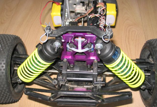

01.17.2009, 01:28 PM
I know
If you look closely you'll see that the left rear steering arm is broken... And there's no way I'm gonna dish out the money for the HPI suspension upgrade kit or try to source the HPI aluminum rear uprights. In all my searching the only other company I found to make rear uprights is Integy... Let's just say this is the first and last Integy part ever to come in my possession. It's in the mail right now.
