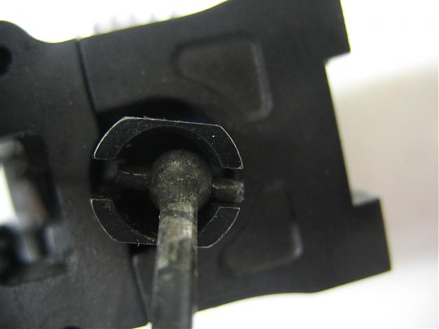

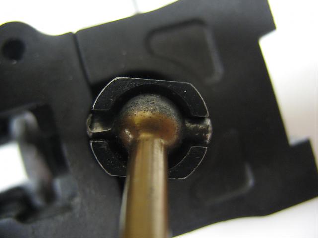

04.28.2008, 04:35 PM
Trust me, there is a big difference between the two. There is far too much play, especially for a brushless conversion Look at the pictures below that I have just taken, the first shows 1/8 and 1/10 dog bones together and the other two show them inside the drive cup on the centre diff.
ID:	4489   Click image for larger version
ID:	4490   Click image for larger version

  (#59)
brushlessboy16
brushlessboy16's Avatar
04.28.2008, 05:02 PM
Uh oh....
  (#60)
brushlessboy16
04.28.2008, 05:15 PM
Ok plan B...
Cut a current Dogbone to size then weld it back together, grind smooth
