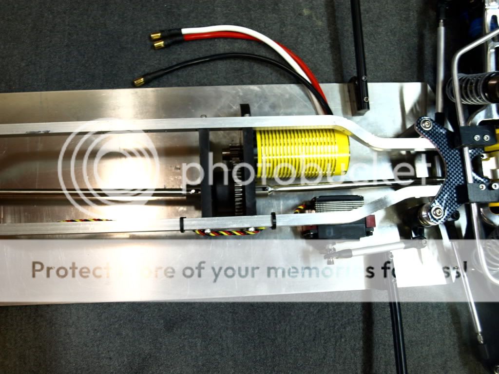

I got carried away in my build and just used a Losi, oh well
here's my RevOsi
