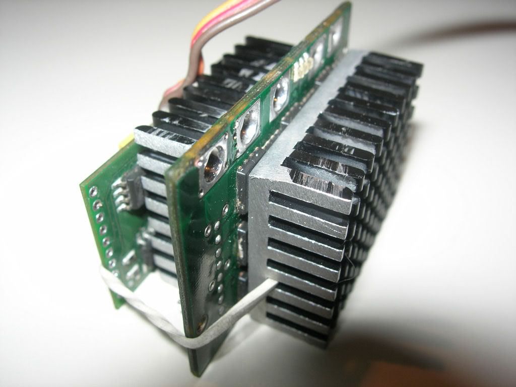

Originally Posted by BMW318TI View Post
That is a lot of Frankenstiening, but why?
01.14.2011, 06:41 PM
Have you seen the rest of his rig?- the guy has a serious fan-fetish...

Looking at the insides of this MMM reminds me of the good ol days of modding the MM. I actually managed to replace a few of the surface mounted fets on one of my MM's.
We used to pop off the heat sink and sand the fet's perfectly flat, sand away the anodizing on the sink, and use thermal paste and thermal adhesive to hold it all togeather.
I still have my frankenstien MM that never even got warm to the touch...

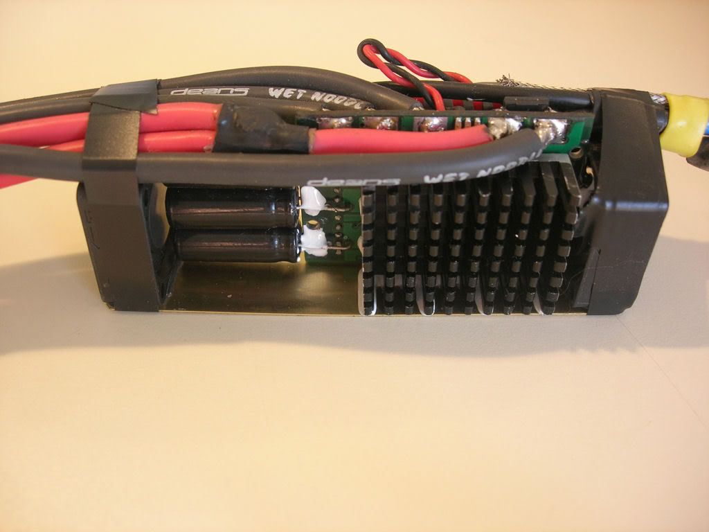

I dunno, I'm kinda liking like just plugging in the XL or MMM and not having any worries about the quality of my micro-soldering LOL. I do have to admit though that it's hard to resist the urge to pull open the XL and revamp the heatsink to have it contact ALL the fet's... maybe a "pics of the inside of an XL" will eventually show up :-)
