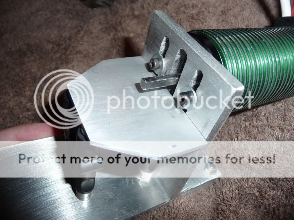

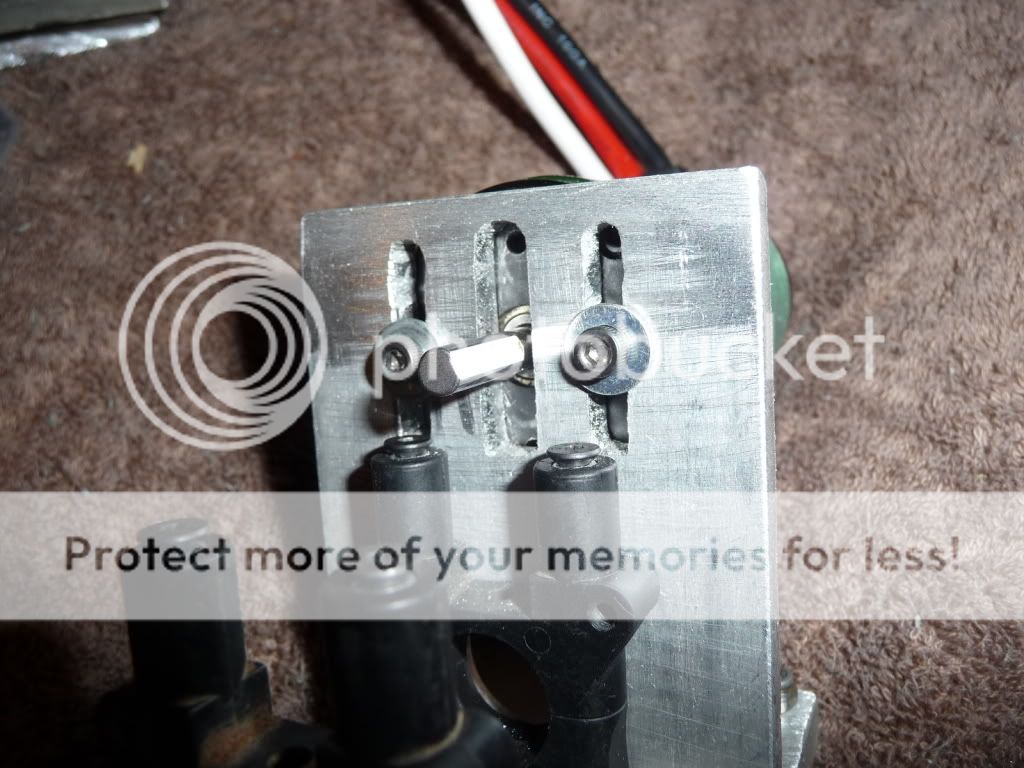

I remade the lower plates. I now have everything ready to cut the alu angle to make my motor mount out of.
To mount the battery trays this time i have tapped the lower plate so that there is no need for a nut (8) on every mounting screw.
Also i recieved my other LST XXL. and i have installed a TD racing motor mount. This Car will have a 1717 motor and maybe 6s.

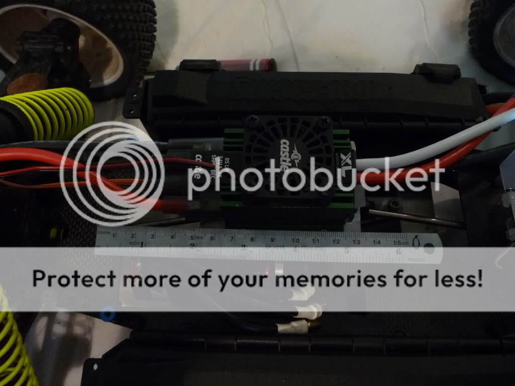

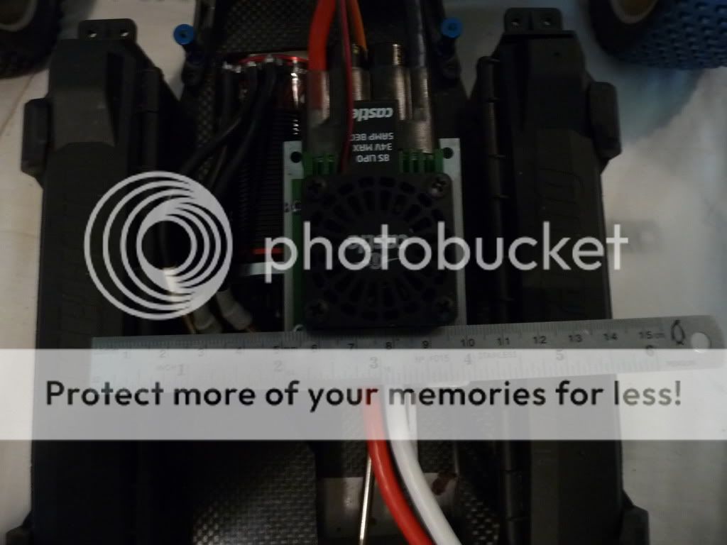

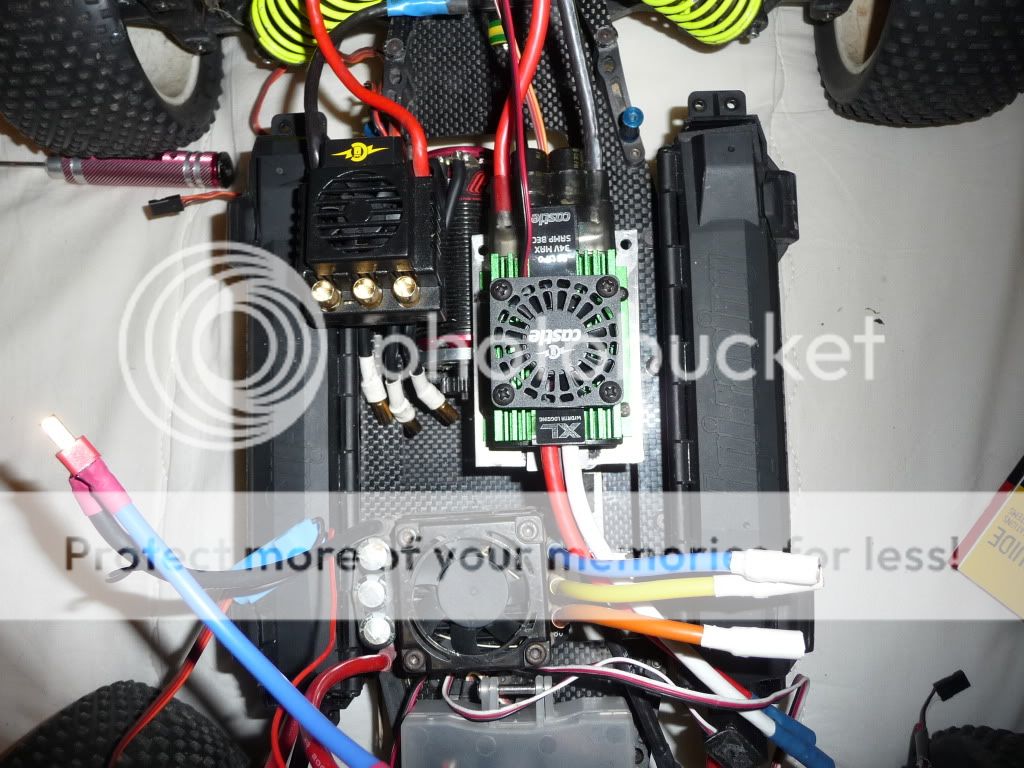

Just installed the MMMXL in the XXL. It is held in by 4 screws. The metal plate is screwed into the upper CD plate.

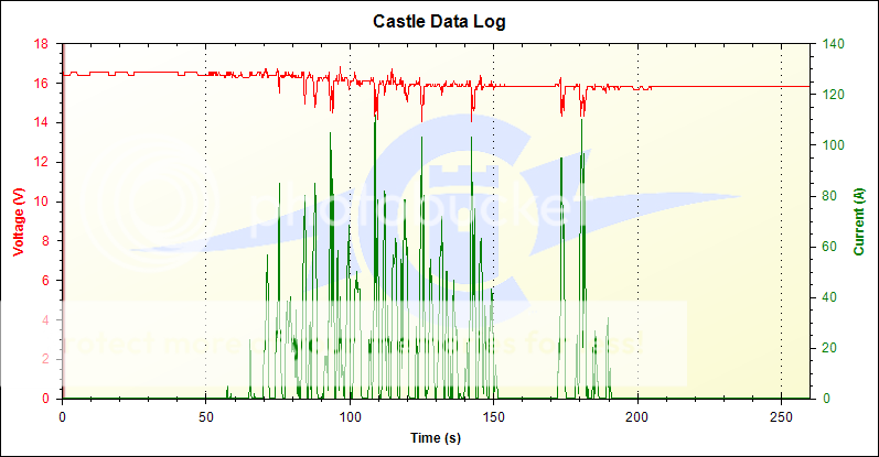

Heres some of the logging from the first proper run. It wasn't long but it gave me an idea of stuff i need to sort out.

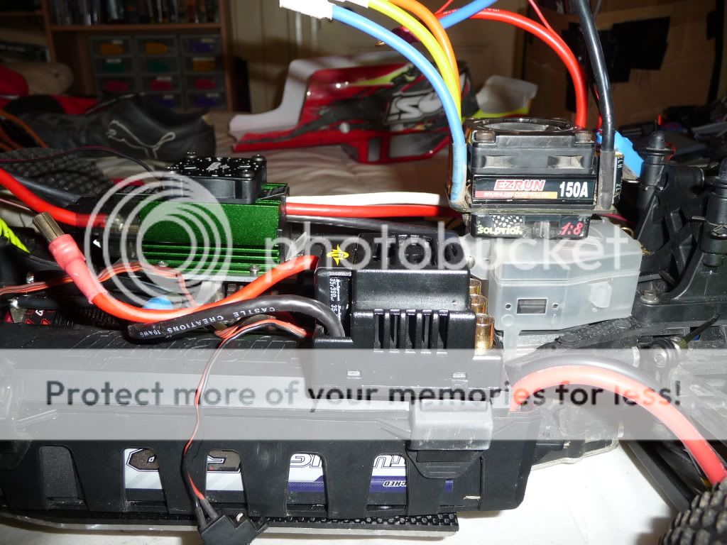

Hopefully tomorrow i'll be able to get a few more laps with this. Last time i did about 3 laps before the steering ball link popped out. This happened at the exact same time as my pinion came loose. SO when i lost both steering and throttle i thought the worst. This was also while i was running the mamba XL.
I have now epoxied the steering link in so hopefully it'll stay in. I have also gone to an ez-run/leopard 150a esc. This is because i was planning to use the Mamba XL in my truggy for the data logging but i haven't put it in yet.

Just a quick question for everyone.

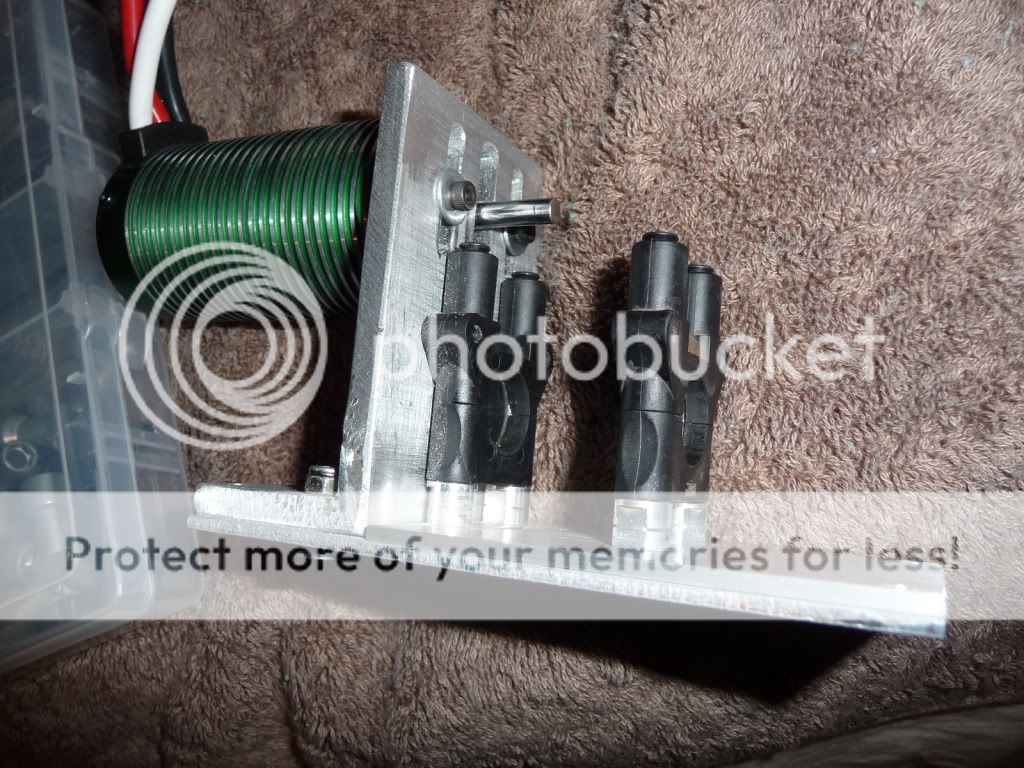

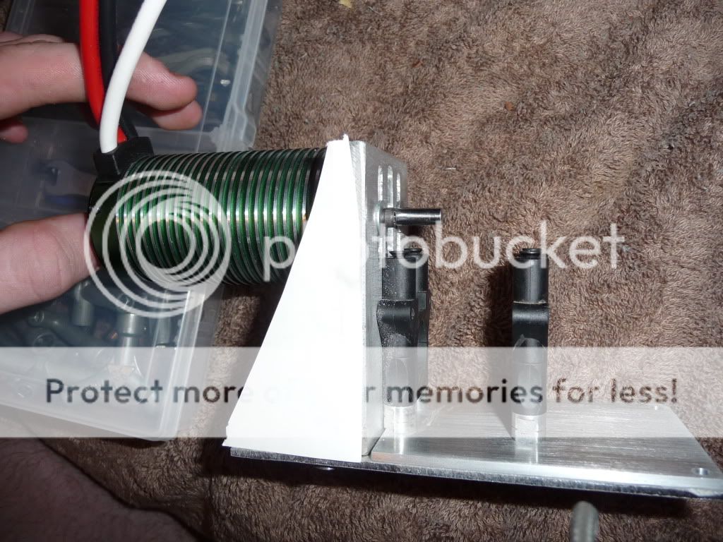

Do you think i should make a rear motor support. i am a little worried about the motor coming loose or the motor mount bending but if i have a rear motor support neither of these should happen. So what are everyones thoughts??

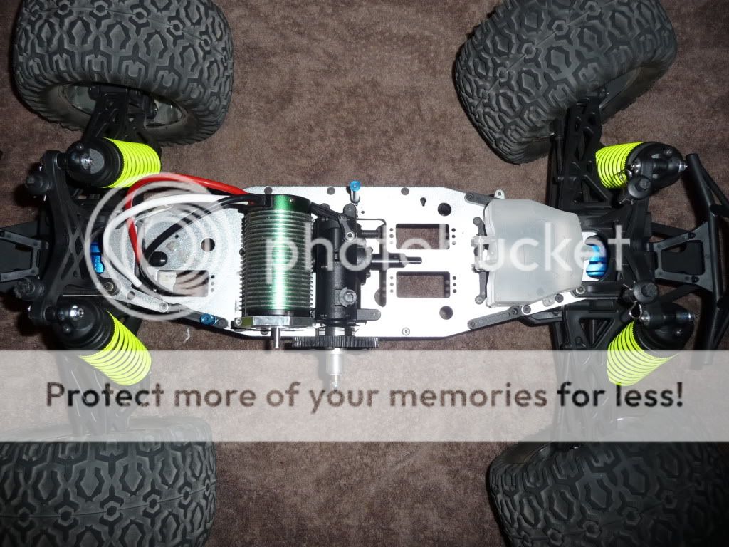

Got bored...

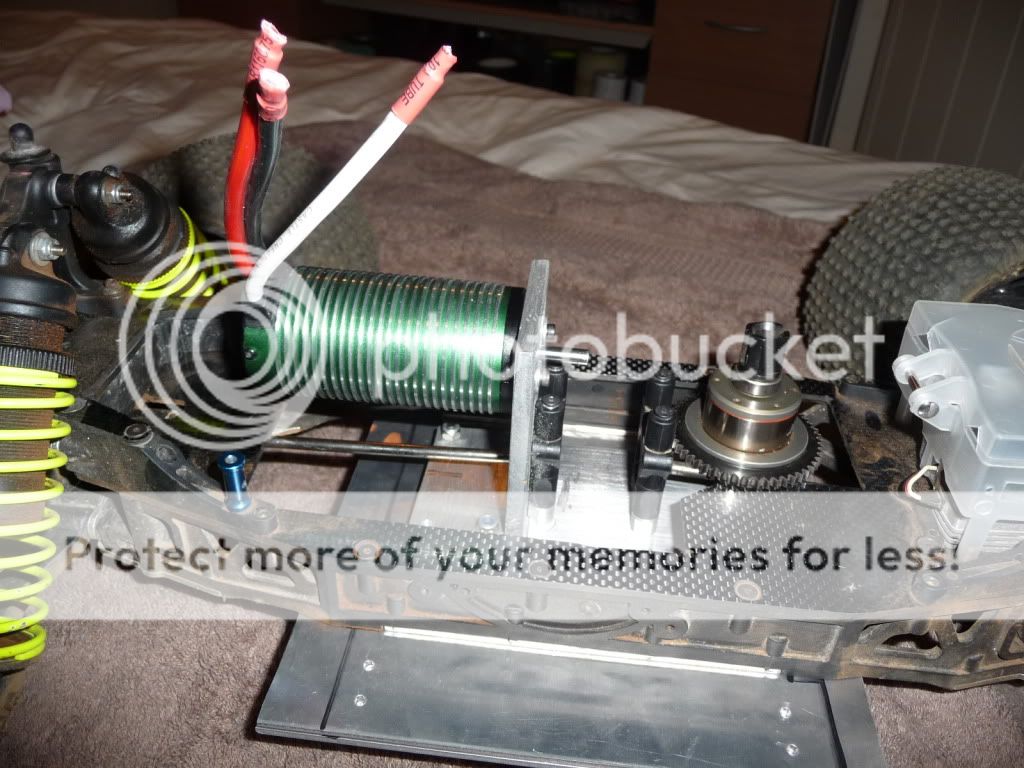

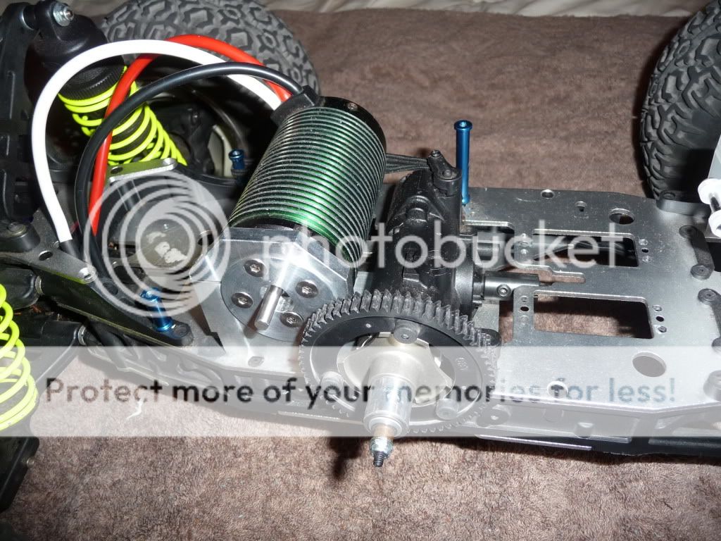

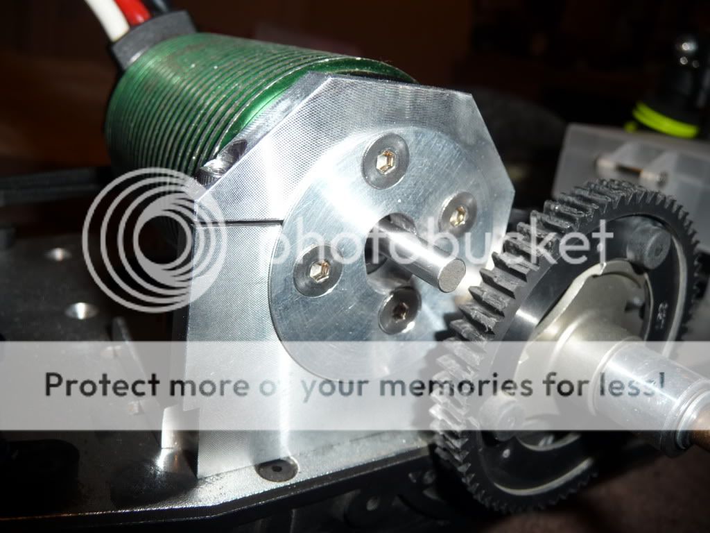

So i finished the new setup. I can now run it but i haven't made the motor mount support or the motor support.
But i can use it if i want.

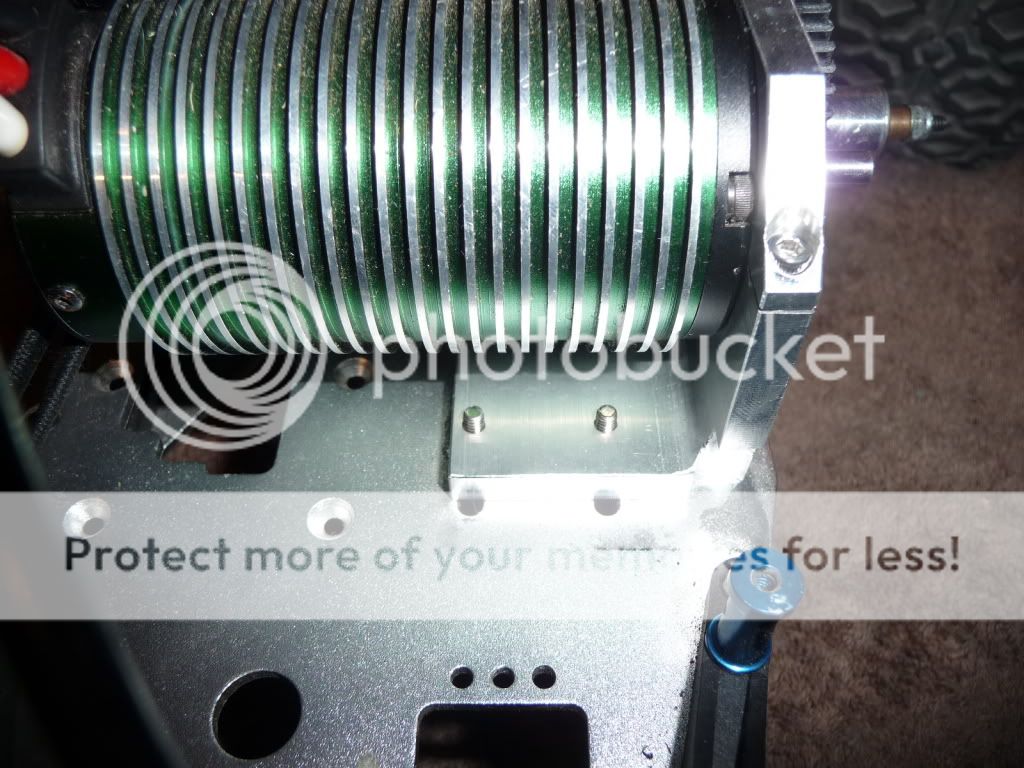

It may not look the best but it works. I am planning to put some thermal paste between the motor and mount as well as in between some of the plates.

I have now actually finished the new setup. It is ready to be installed onto the car. It may not be the prettiest but it'll work (or at least i hope it will...).
However. If/when/whatever i get a mill i will probs redo all these plates so that they are very precise to about the 0.02mm (i know, talk about anal) then i'll be happy. Also i can then do lots of stuff with the plates that i couldn't before.

o over the past two nights i have finished LD's old LST and also installed my new setup into my original LST. Everything looks good and i've also made a rear motor brace. It loos like 5hi+ but it works and i couldn't be screwed being in the shed for all of the night being eaten alive by mozzies.
I will be running a leopard 4082 1030kv motor on 4s lipo with a leopard (hobbywing) 150a esc. it is geared 23/46 so i should get about 40MPH. ATM i have to run a 46t spur as i have removed the upper big plate of the lower section (if anyone understands that, well done) so untill i get my dremel working again i can't cut the groove easily.
