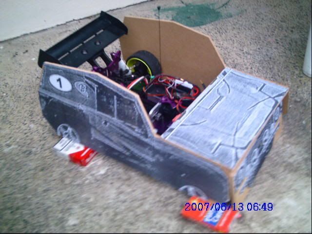

I just finished Cuting and streching a paper model of the bowler to the proportions of my buggy, I cut some length out of the bonnet and took a chunk out between the door and the rear wheel, I streched the width and I raised the wheelarches to make it sit lower.
I will get it enlarged then stick it to some wood and get cutting soon.
You have to either have some imagination or a printer and glue to get the pic properly.
I tried to print one off but it seems I have no ink, it came out like this.
Does anyone have a printer, digicam and a few mins spare time? I will be taking it to the printers next week but I would love to see it in 3D before then.

I got my enlargements back from the printer today tho, I cut out the paper glued the templated to some MDF and started cutting parts for my body mould, lots of work still to do but it's a start.
