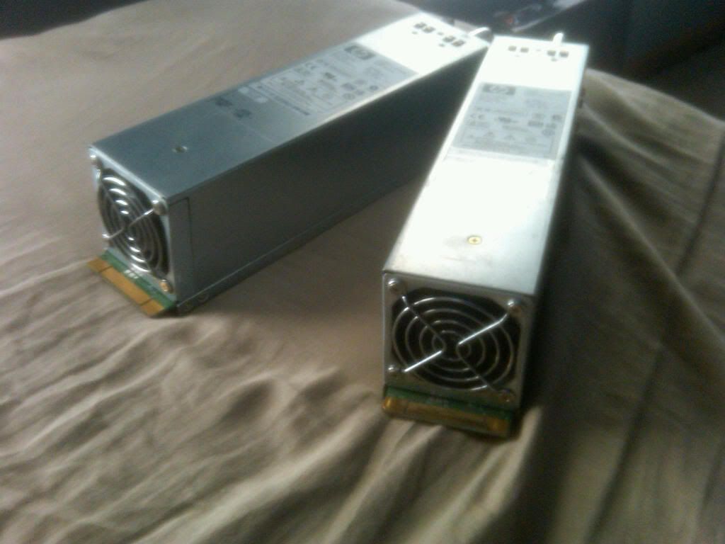

Just bought 2 of these guys! Gonna wire them in parallel for 800 watts, Power all my chargers or My Amp and subs in my dorm room....
Couldnt pass up a dollar a peice! was 17 dollars for 2, shipped. Get em while there hot

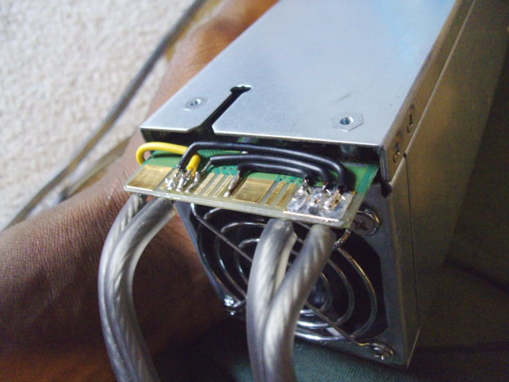

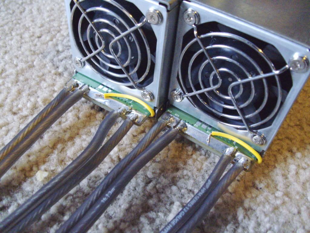

Will do Alien, Progress pics. Got them Wired up, and all the startup wiring done so the thing actually arms...

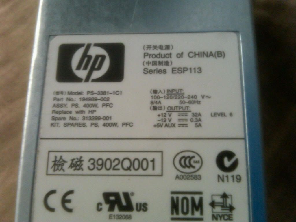

Great guide for the HP #194989 and HP #280127 can be found here:
CLICK ME
Have yet to put a load on it, or plug it in yet, need connectors to go to my load of choice (700watt amp and dual 8in subs)
Progress Pics:

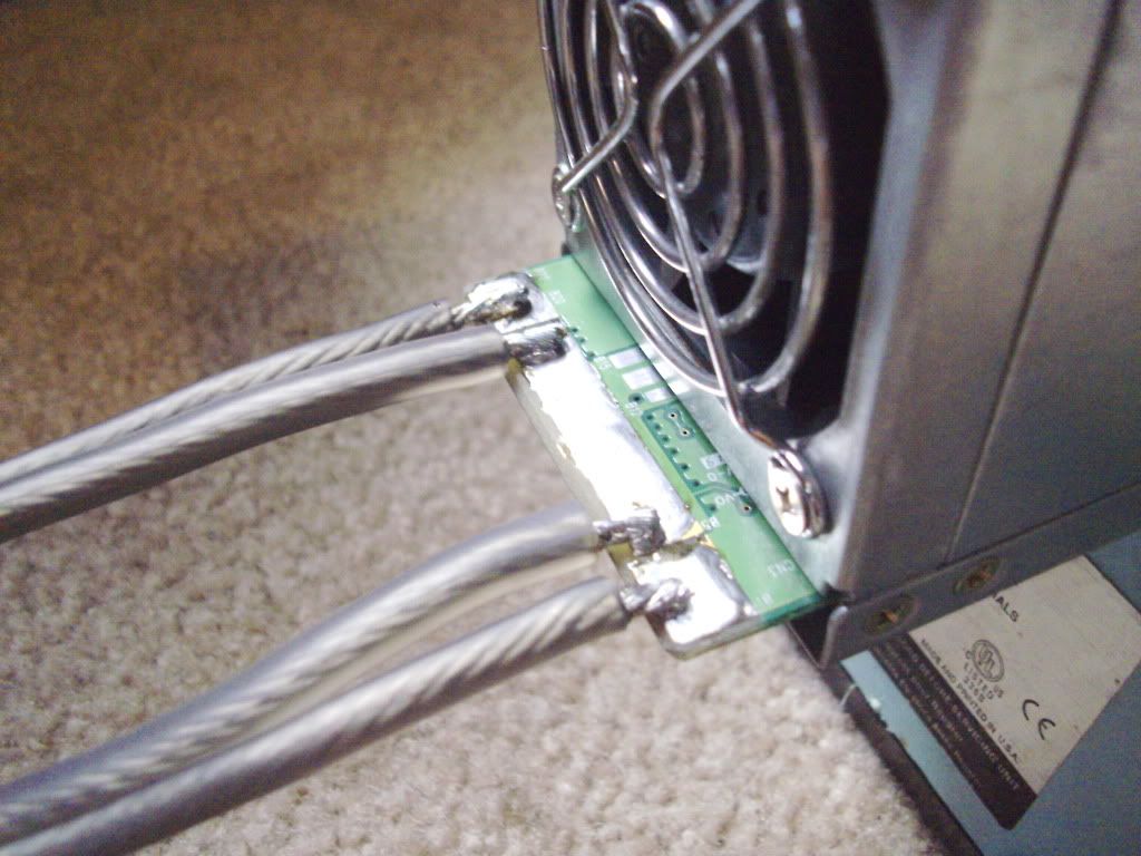

Grounding the (PS_enable), (PS_interlock) and (PS_kill) signal pins
12Ga Power Leads attached, Negatives on the outside, large 12v rail in the center
Ran the 2nd (PSU_Interlock_2) Pin to +12v
They are complete

A good reason for them not to touch when they are on... you can get a big spark between them... you can even short the internals... did you remove the ground to get them running together?
09.07.2010, 10:48 PM
It was unplugged, just had not discharged yet,
Amp was running fine on just 1 PSU tho
Posts: 809
Location: JAMAICA
09.07.2010, 10:55 PM
Yep... those Caps will hold a bit for a while...
