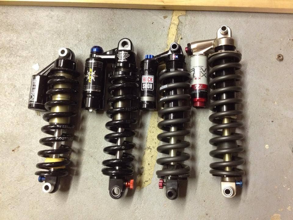

Scored me a Manitou cheapy 10.5"x3.5" shock. Used a 300lbs vs the 400lbs spring on the 9.5" x 3.0" shock. Pedals just as nice on my way to work. I haven't gone off road yet.
It's the last shock on the right.

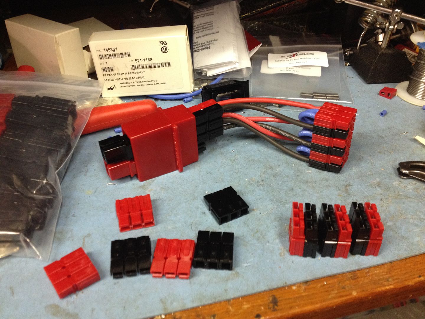

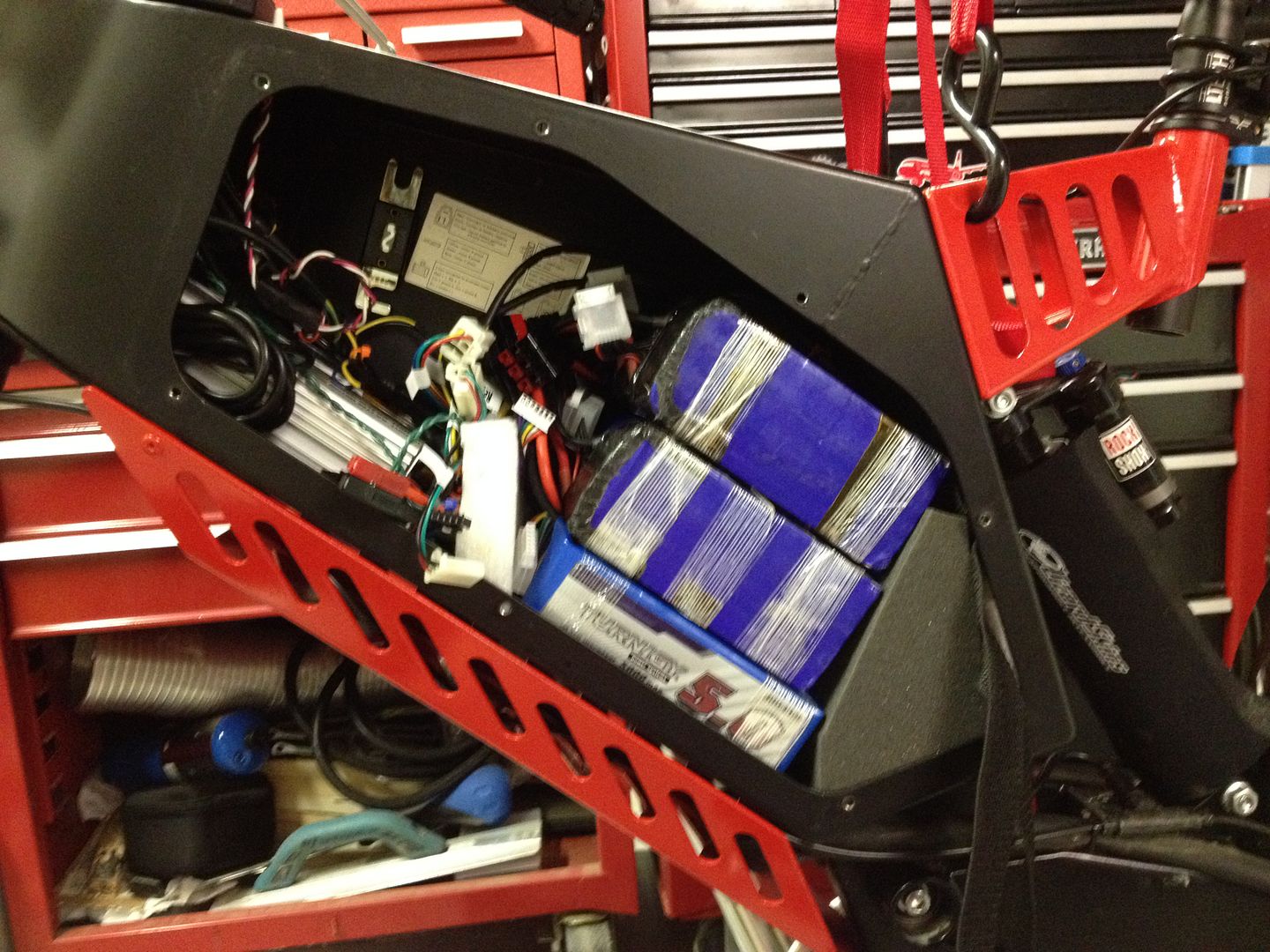

Only update I have on my bike is a new battery power configuration that I'm going too. I barely go 40mph, so I'm dropping my voltage and going with 18s3p 5000mah lipo. Also swapping over to Powerpole connectors for ease changing voltage configuration.
Sorry for the bad phone pics.
