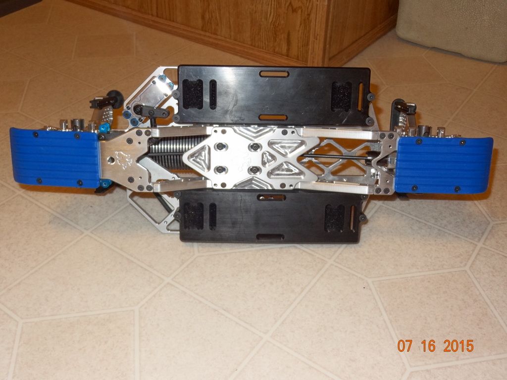

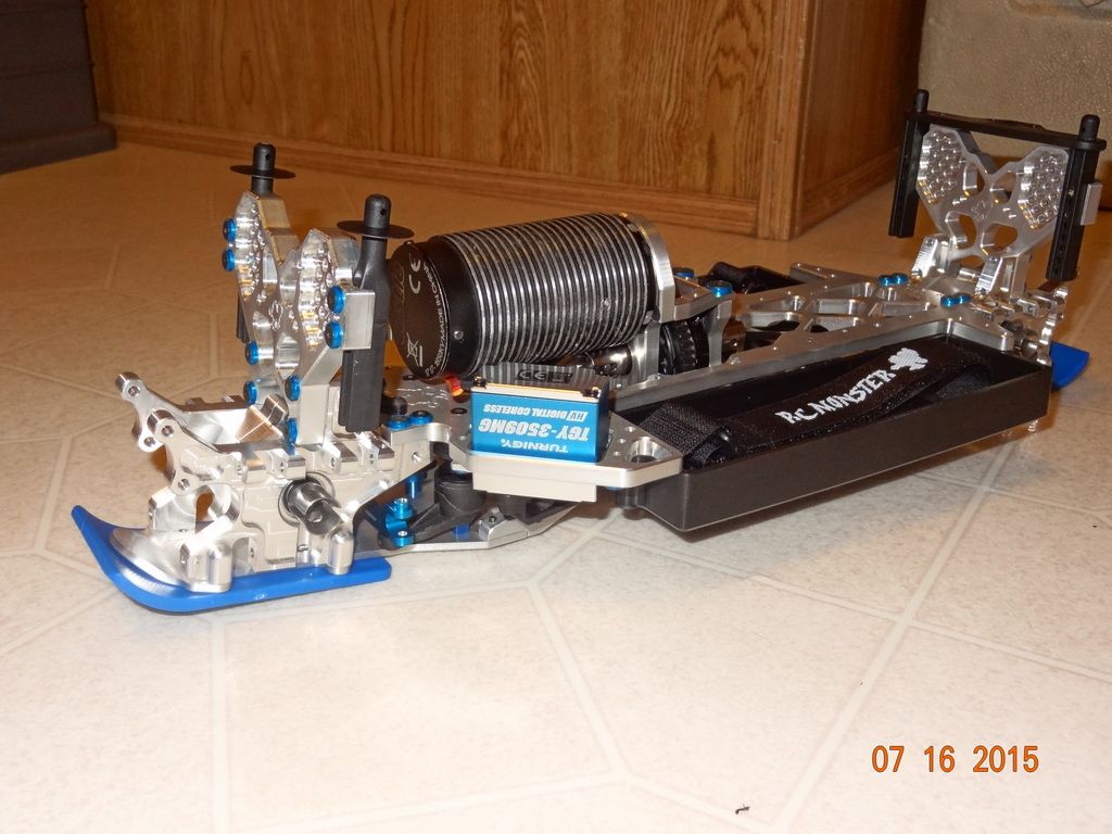

07.17.2015, 02:11 AM
Coming together nicely! Thanks Mike, You The Man!

07.18.2015, 06:50 PM
Thanks guys! Mike and I have flipped my painter to. He was always a bit of a Maxx hater, but the clean center diff mount and LCG RCM chassis has him drooling, and considering a monster truck build.
I cant wait to drive this thing. Hope to have the rest of the parts this week!

Hi guys new here from Denmark.. Am also building a RCM Maxx so thought I should chime in..loving your build Buzzsaw ..question lenghth of your dogbones/ diff cups??
Pics of my build soon..
Kristian

07.20.2015, 08:08 PM
I used Associated #89575 82mm (front) Associated #89576 108mm (rear) dogbones. RCM slipperential with Traxxas 6mm drive cups in the center and Mugen MBX7T diffs with UE 5mm drive cups on the pinions. That setup gets me about 2-3mm of end play on each bone.

07.21.2015, 07:18 PM
The front won't change - just add 35mm to the rear with the extension. Basically, you will need around 85mm up front and 145mm out back - could go 88mm up front and 142mm out back with the adjustment available on the skid. These are ball park numbers, based on the Slipperential diff - some diffs are slightly larger or smaller, but using the 85/145 sizes you should fit most 1/8 diffs out there.
