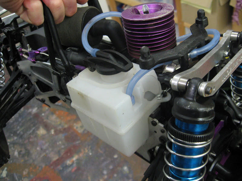

And the LST shocks seem to work well. They are mounted with an Innovative-rc shock mounting kit which is very nice. Once again they haven't been on the truck long enough to give a full report but so far so good. My only issues with them are that with the shocks being mounted slightly out from the plastic towers they bend the towers in slightly so my body holes don't line up like they used to. Also I think they helped make this happen
It's nice they are adjustable too. I stiffen them up for jumps (to get that extra height and soften them for normal racing around. The aluminium bars destroyed the back of my body really quickly though.
