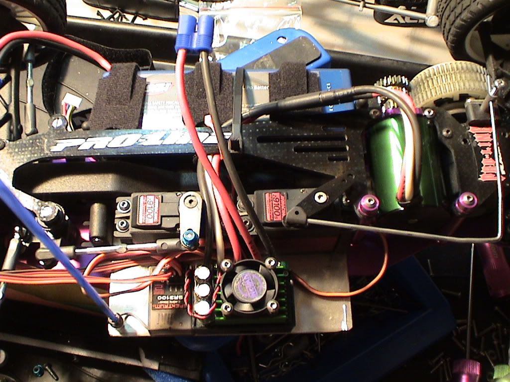

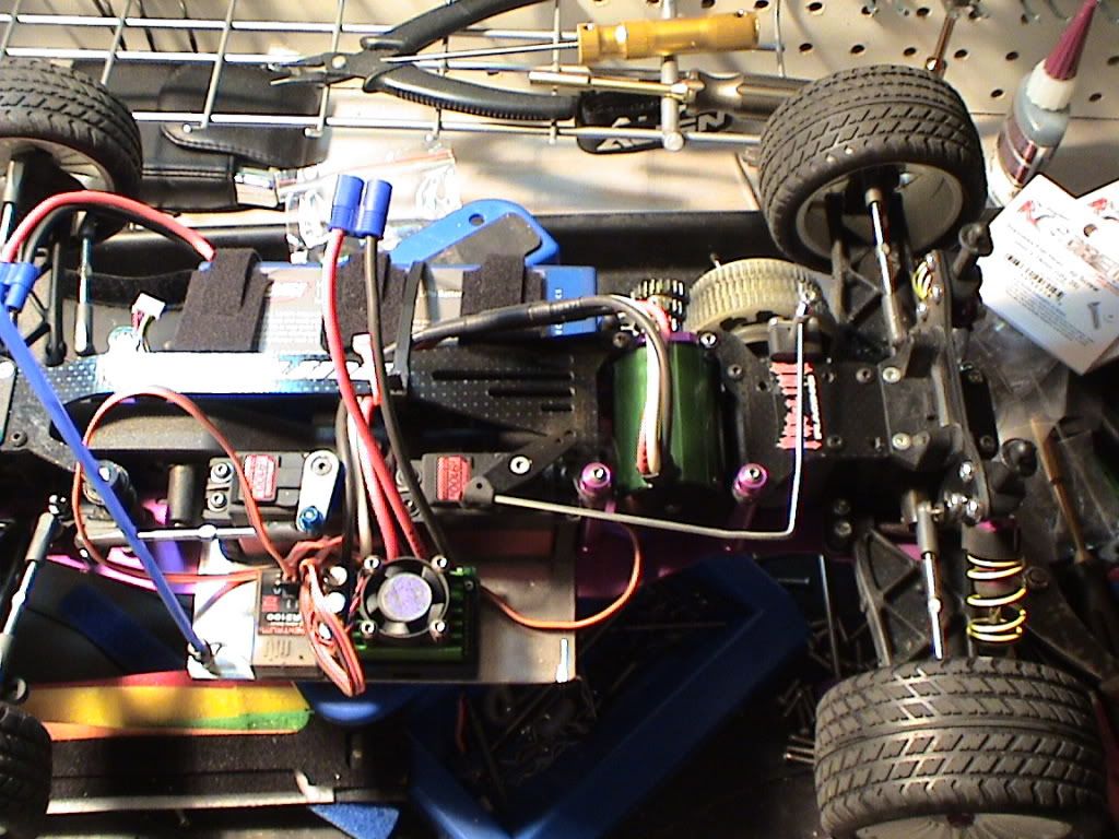

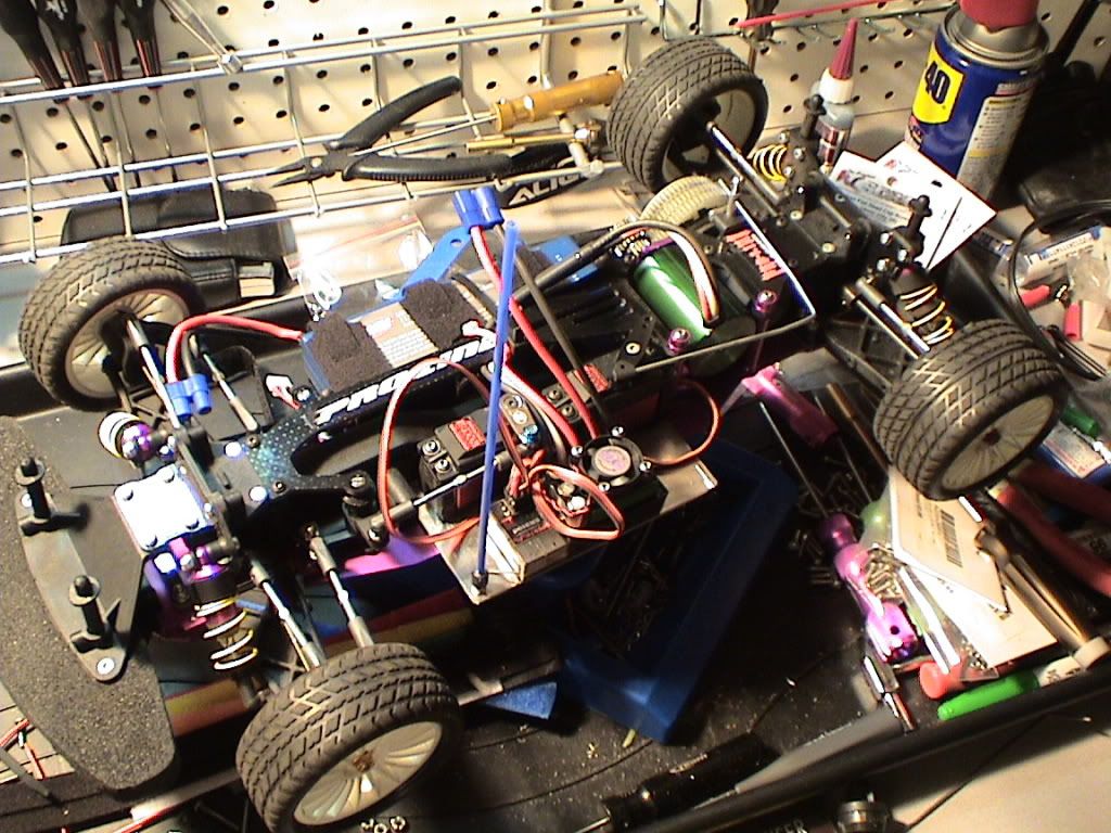

Here are some new pics with my MMM mounted.
ID:	5816   Click image for larger version
ID:	5817   Click image for larger version

Took it for a test spin today. First thing I looked for after giving it a boot full was the punch control!!!! (to turn it down) It's incredible the amount of torque these NEU 4 pole motors produce. So after getting a feel for the car again, I gave it a couple of flat out runs WOW!!!! I forgot how fast this thing is...
So after a few speed runs I bring it in just to keep and eye on temps. I was surprised at how cool the MMM runs (compared to my old MGM) the speed control was lucky to be a couple of degrees above ambient, needless to say the fan was not running either. The next thing I wanted to test was how smooth the MMM was from a stand still to a slow crawl, again WOW!!! This thing feels like one of my old sensored motors from my touring car (they were super smooth down low) there was not even a hint of cogging. So after keeping an eye on the temps for while longer (still barely above ambient) it was time for some more high speed passes. On about my third pass (@ around 120Kph) I ran over a piece of bark on the road, this was enough to allow wind to catch under the front of the body and over she went. I pretty much wrote of a near new body due to it sliding on it's roof for around 25-30 meters.
I know it's early days but I think the V3 MMM is going to be one solid controller.
I'm going to the local RC drags on Saturday, I will be taking my video camera so I should have some new footage up after the weekend.
Here is a pic of the body (after the roof slide)

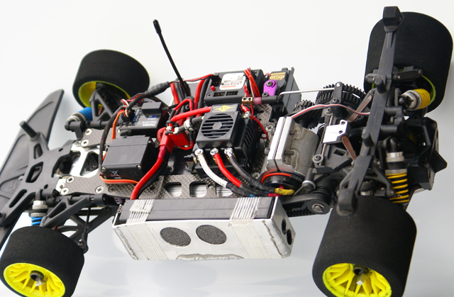

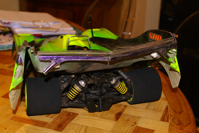

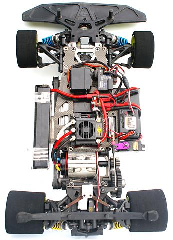

so here is my schumacher 3 speed i finished. i put the gps on it and it did 74mph. not bad. not the 100mph i was hoping for but just a gearing issue. but this is plenty fast and drivable. but it has no grip. it slides all over and went thru a pair of tires after 2 batteries. i ordered some foams. we'll see how they do. now i am finishing the RC8T and then its on to my 1/5 scale on road. been slowly starting on that one.
the schumacher is kinda ugly right now. just wanted to get it done to see how it ran. now i am going to clean it up with tons of carbon fiber, titanium, and aluminum. i will post more pics later.
schumacher3
schumacher2
schumacher1
Jammin SCRT10 Neu 1512 1y
